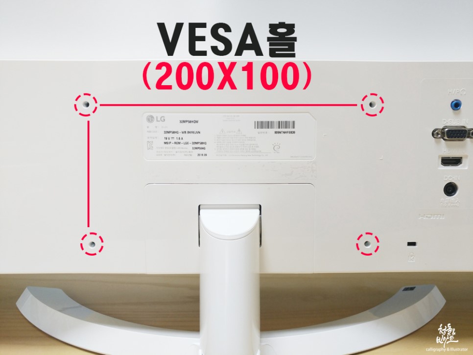

ThezVewlix C monitor has what looks like a VESA 200x100 mount but it's low mounted on the panel (not centered).
I think the easiest way is to buy a 200x200 to 100x100 adapter plate and use the bottom holes to position the bracket to drill upper mounting holes.This allows for a centered 100x100 mount which is fairly common on regular consumer panels.
Then, to obtain correct spacing to the face, use long bolts along with spacer blocks made from mdf or acrylic.
The only concern after this is how to attach the 4-piece monitor surround. I don't like using adhesives, but maybe something like Betalink would work well? Or very shallow self tapping screws...
Like you, I could only come across people with Chewlixes doing monitor swaps, and unfortunately, the chewlixes have a totally different mounting system and front panel surround.
Just found some information of lg32mp58hqw has very similar VESA with Vewlix C.
As this model has 200x100 size and also it is low mounted. I also found out some people has upgraded their original vewlix with this model. I tried to contacted those people but did not get reply yet.
Will update if I get more info from them.

what would be the harm in drilling new holes. If it mounts the monitor in the right position I mean
You might get elitists on the internet harassing you about how you've ruined your cabinet...Only slightly kidding.
The real reason is it's easier to use the original holes to an adapter bracket, them modify the bracket instead since the work can be done away from the cabinet. Even if the holes are in the correct spot, the thickness and size of the panels will be different and will require spacers or other positioning modifications.
