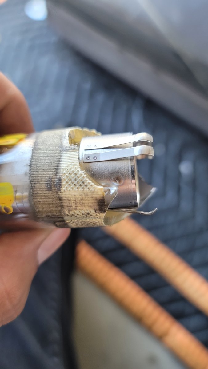

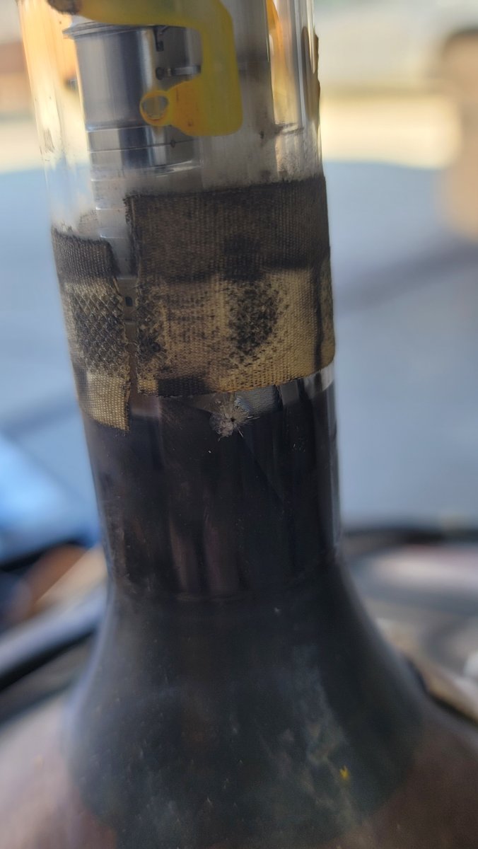

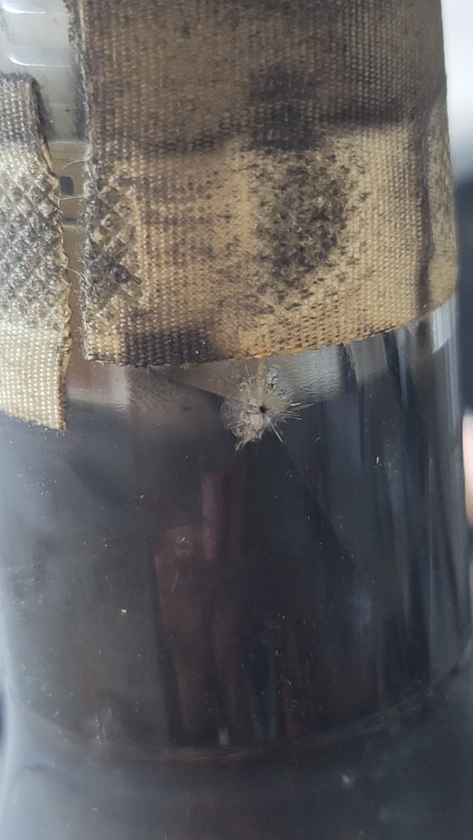

I'm the latest victim of this. Ms2931 Chassis bench tested by PNL for 8 hours. Worked for a few minutes and then a loud screech. After some troubleshooting I suspected my tube was shot. Confirmed with my rejuvenator that it was dead. Salvage the yoke and found this bad boy. Fun fun
nice shot of the "exit wound". I can't help but notice that that pinhole is right below the enormous resistor that goes from the anode/HV to pin 4 on the neck. This further supports my theory that an arc is happening through the neck to the yoke. Perhaps this is something that happens as a result of a spike in HV.
