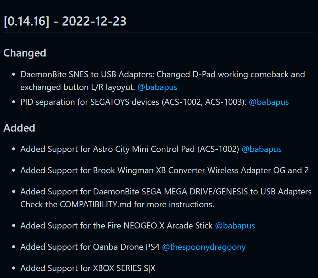

USB2DB15 Firmware and Library update.
[0.14.15] - 2022-05-26
Changed
- Fixed an issue with button mapping surrounding Mad Catz Street Fighter V Arcade FightStick TE2+ (PS4 Mode) controller.
Added
- Added Support for Logitech F310 (thanks @narf )
- Library updated: https://github.com/Raphfriend/USB_Host_Shield_2.0
- USB Host Shield 2.0 files updated:
- hidescriptorparser.cpp
- hidescriptorparser.h
- Usb.cpp
