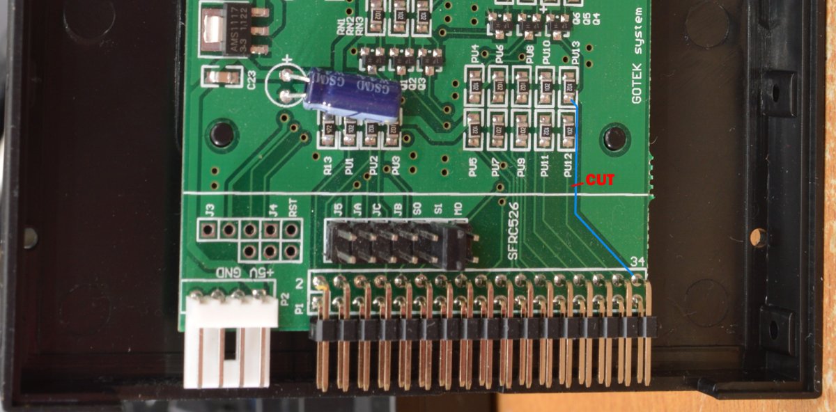

Step 2: Cut the Trace - Next you will want to open up the FDD drive by removing the 3 philips screws on the top of the case. Note the traces going to pin 34 of the ribbon cable connector, this goes up along the top of the board to a small surface mount resistor. You will need to cut this trace. Basically use a razor blade or xacto knife to score the trace over and over again until it breaks. Be sure not to accidentally cut any of the near by traces, and use a multi-meter to confirm no connectivity between the pin and the resistor once the trace has been cut. As far as trace cuts go, this one is very easy.
Step 3: Add a Jumper Wire - After the trace has been cut you will need to solder a wire from pin 34 to a 5V source. the easiest is to turn the PCB upside down and then run the wire to pin 1 of the 4-pin power connector. You can take them out of the case but I recommend leaving the display and controls connected to the PCB while you do this so you don't have to worry about plugging them back in wrong. Once you've done this you can put the PCB back in the case and re-install the 3 philips screws.

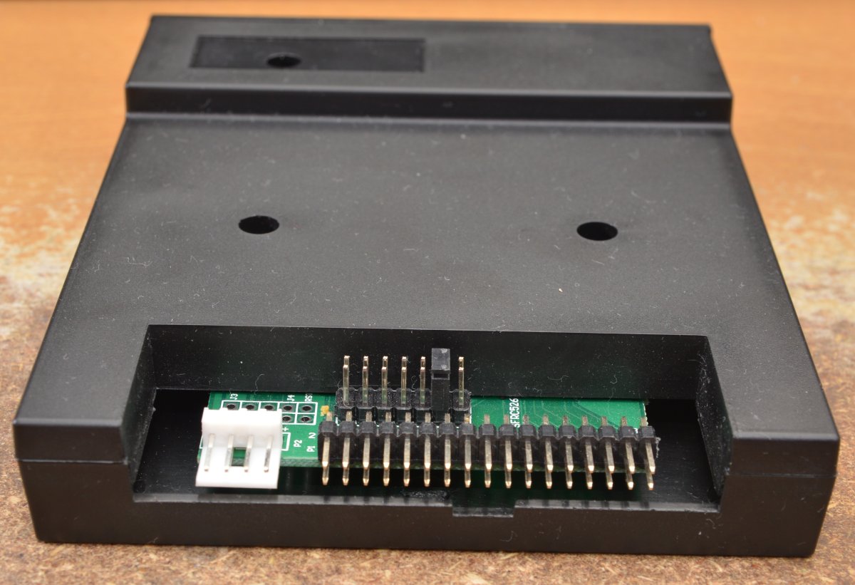

Step 4: Check the Jumper Config - Once The drive is back together note the jumpers near the connectors. you will want a single jumper in the "S1" position and all other jumpers removed.
