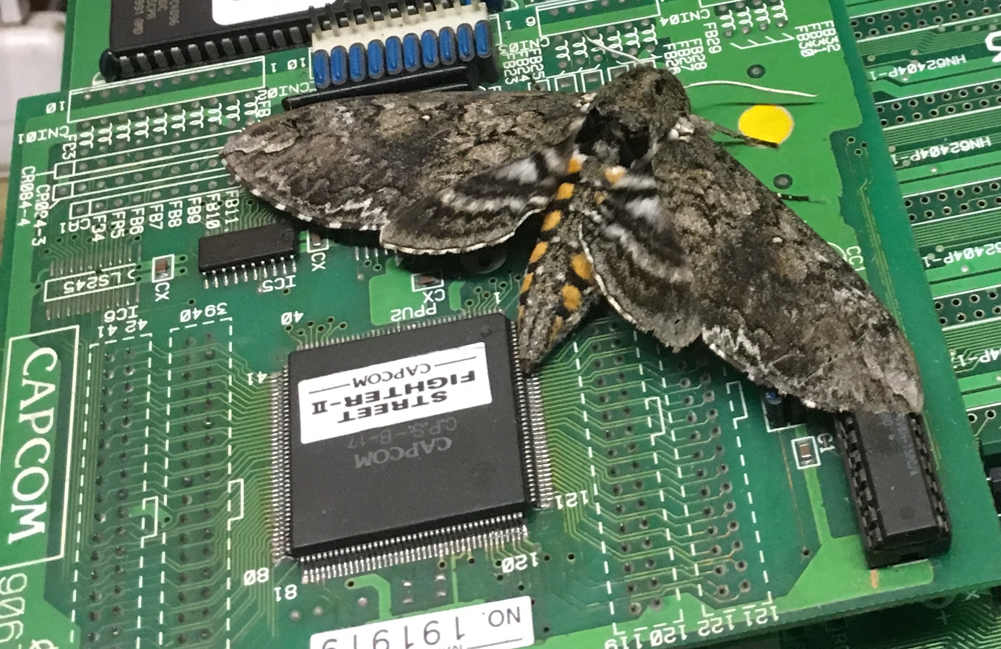

here in the Hawaiian islands that's ether bad juju or good juju depending on how you look at it. Filipino's would think that's a relative visiting you.
