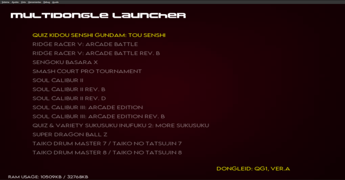

anyone has a detailed list of the arcade games?
I would need the following info for the multi dongle UI:
  • dongle label ID
  • Game name
  • If the game was made for the sys256
looks good to you? at the end, the program will be scripted on javascript, games will be listed on json

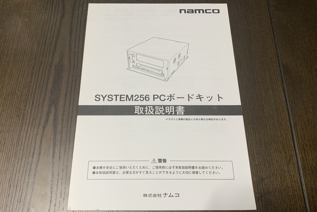

Anyone has digitalized manuals for system 256 and system 246?
I need scans of the face of the manuals, where there's a drawing of the system
The system is usually talked about in the game manuals, some are in PDF format like the Tekken 4 and Tekken 5 manuals. I do have some extra sheets that weren’t part of any manuals that I would like to scan
Hi! :)
Yes i Have a Japanese Manual Namco System 246 Type C ,Maybe System 256 ,but I may have the one for the 256, but not the 246 type B, I have to search
Kinnikuman Muscle Grand Prix 2 is a 246 game. I've only ever tested it on a 246B and a 256 (set to 246 mode), not sure about the rest.
I would like to classify Time Crisis 4(Super256 exclusive game) as 256 .
"compat": [0, 0, 0, 0, 1],
"Ace Driver 3: Final Turn" and "Moto GP" are not listed, both are for 256 only.
"Battle Gear 3: Tuned Rev.C" (v2.05J) is exclusive to "246 RevC", there will be a confirmation when starting it.
"compat": [3, 3, 3, 1, 3],
"Battle Gear 3" stops at "256 (246+).
"compat": [2, 2, 1, 1, 3],

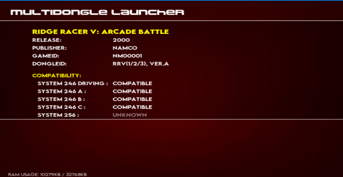

thanks. The DB got some changes before you mentioned this (I realised T4 was on wrong file by myself xd)
I will need all the info to fill in the entries for those two "Ace Driver 3: Final Turn" and "Moto GP"
game info tab preview:
Release month is unknown.
"title": "MotoGP",
"publisher": "Namco",
"date": "2007",
"gameid": "NM00039",
"dongle": "MGP1004-NA-A, Ver.A",
"media": "HDD",
"gamepad": false
"title": "Ace Driver 3 - Final Turn",
"date": "2008",
"gameid": "NM00047",
"dongle": "ADT1005-NA-A, Ver.A",
"media": "HDD",
"gamepad": false
