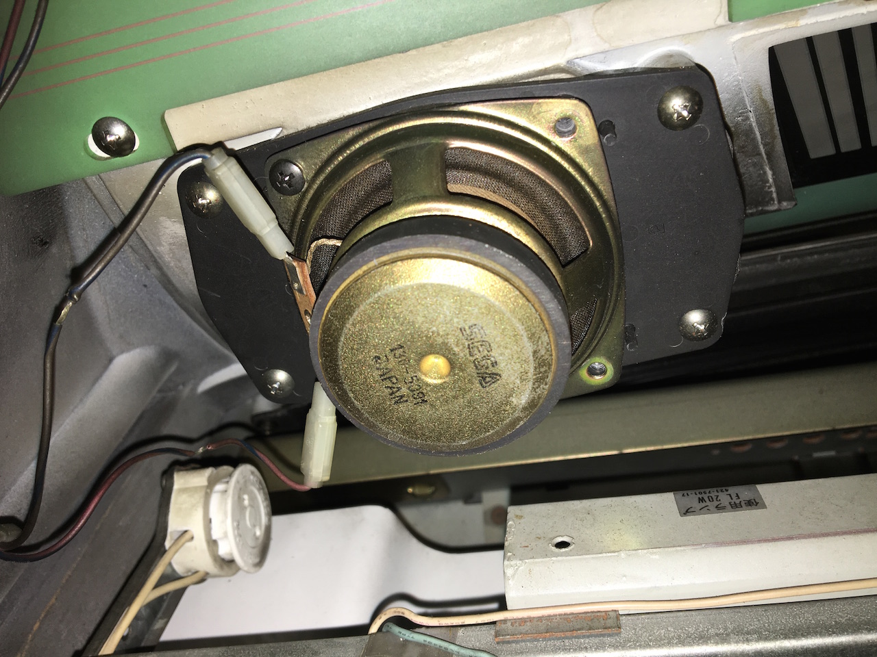

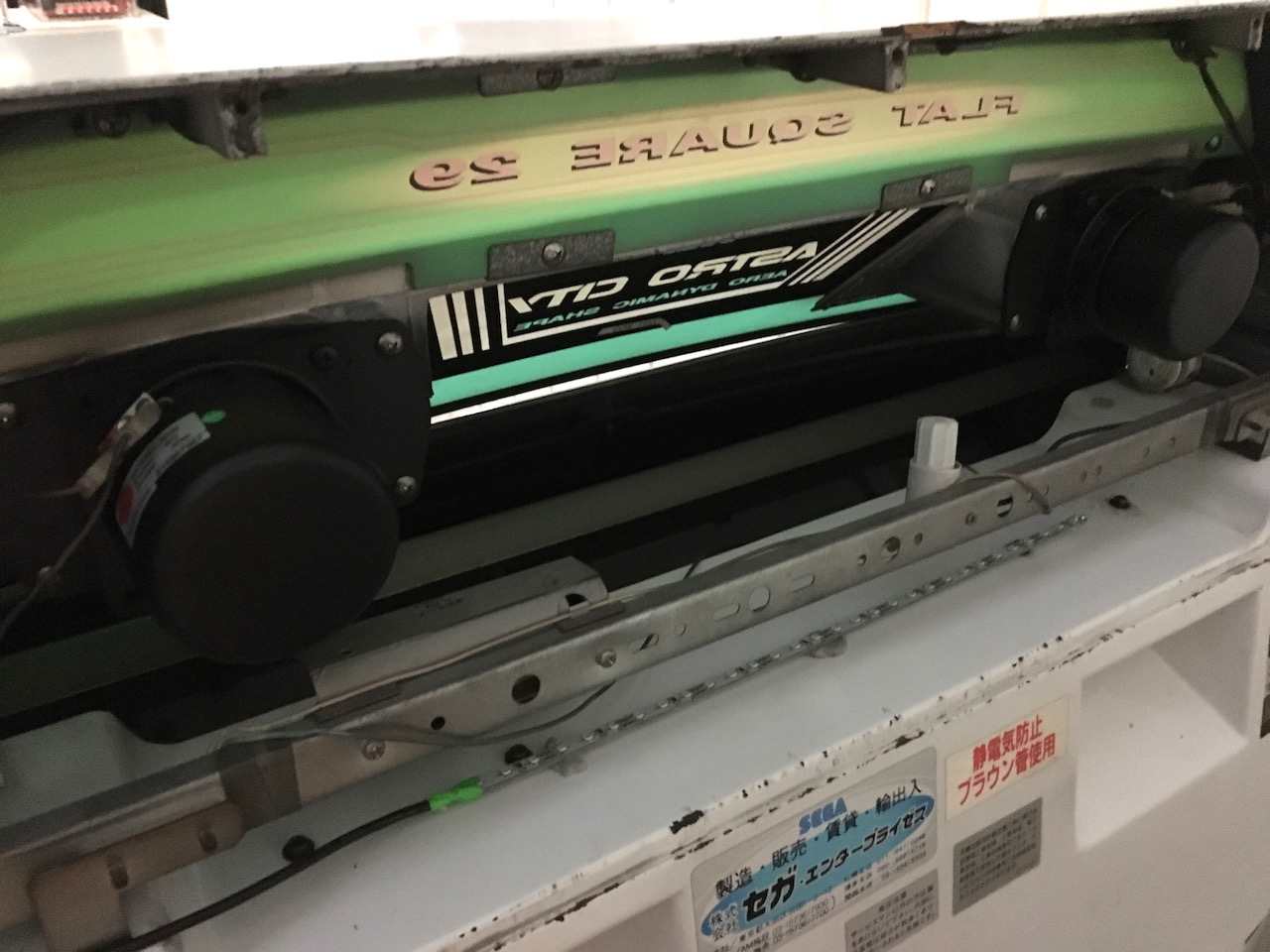

Finally cut the wires on my speakers in the New Astro City, crimped connectors and installed a pair of these:
https://www.aliexpress.com/item/Aiy...ble-Mediant-Bass-Loudspeaker/32845138621.html
They weren't anywhere near as good as the stock speakers on the NAC. Where they excelled in high end treble to mid definition and clarity, they severly lacked in volume (about 60% of the original speakers) and any sort of thump, boom or bass (not that the original speakers have any of that, it's just that dull boom was missing)... it kind sounded like a Macbook's speakers.
Original speakers re-installed and the hunt continues!

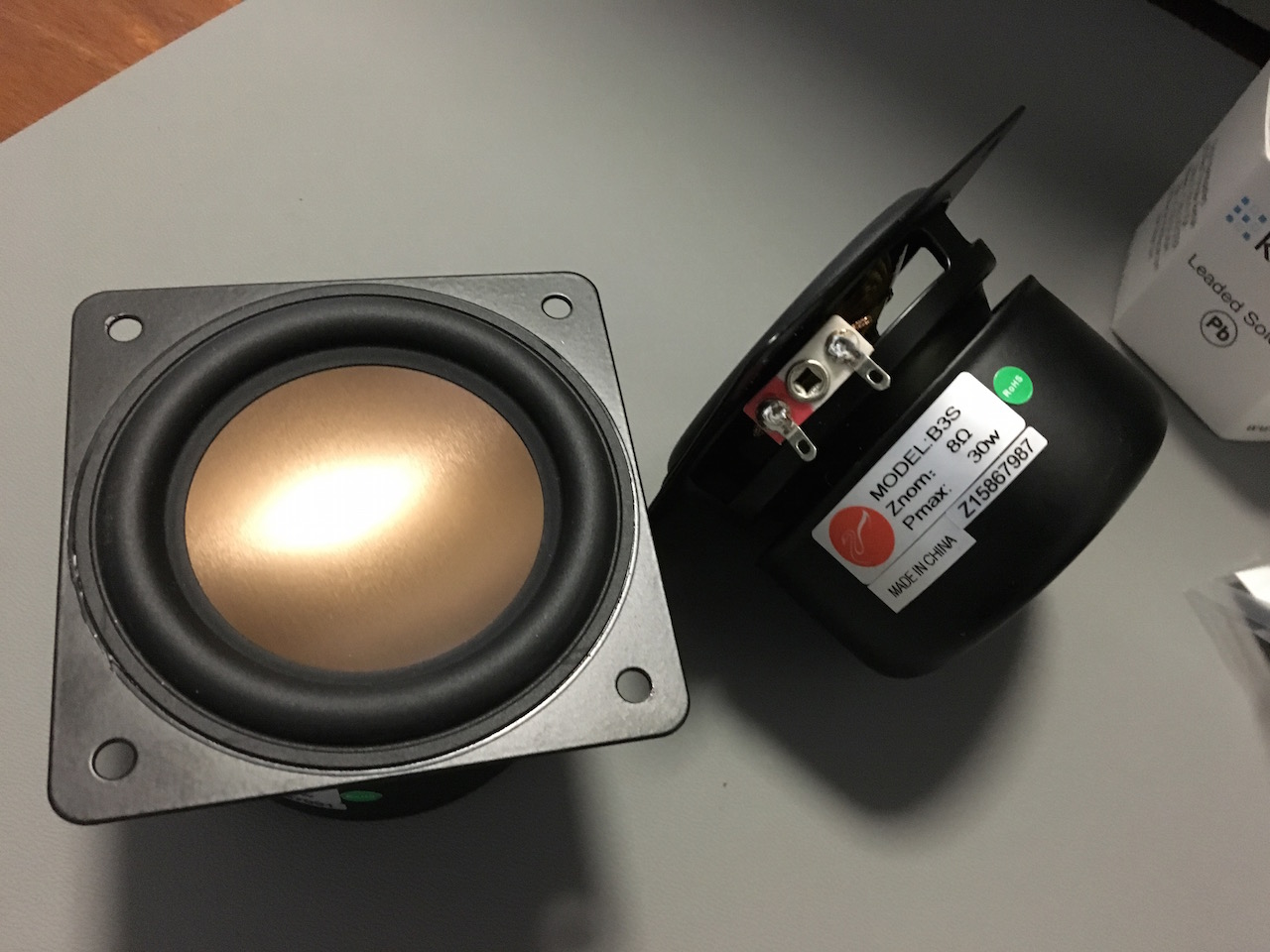

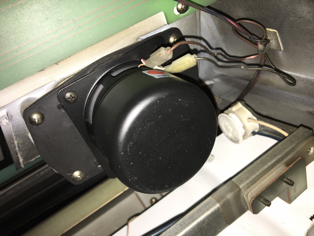

For the Aussie's out there, I've found a pretty decent replacement from Jaycar, they're cheap and they have a decent amount of bite and boom to 'em. Best of all, there's no gamble, waiting or tax from Aliexpress. The speakers are shielded which is a plus, but they don't fit the original screw holes, so you just have to use a singular screw to hold them in. They sit very firmly in there using one screw, so it's no real bother.
The site lists them at 15w, but they're actually 30w. The generic Jaycar brand name is "Response". Hope this helps someone. I'll try them in the New Astro City sometime, even though they're 8ohm, it shouldn't be a big issue I don't think.
https://www.jaycar.com.au/shielded-3-inch-15w-8-ohm-full-range-speaker/p/AS3034

Definitely worth the $40 for sure -- now my cab sounds like a decent set of Logitech powered PC speakers whereas before it was like a iPhone speaker being played in a tin can. Do the upgrade and then get yourself some nice Sega branded paperweights.
