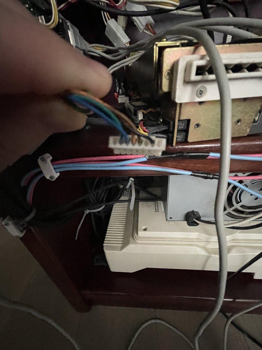

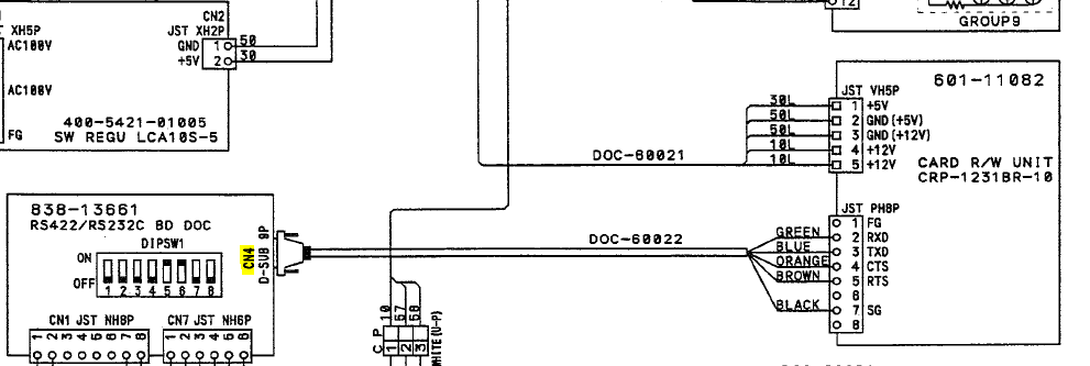

What kind of cable goes into the card reader is it a standard 9 pin dsub ?
I'm sorry CN4
You have a proper sniffer so all of that should be done automatically for you.
A device like that is just mounted inline and then captures both rx and tx simultaneously. No need to split any cables or anything.
8 pins, but only 5 are live

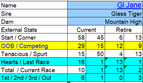

Please confirm the details in the screenshot below are what you can see and what you cannot see
Additionally, it would help to understand the version of Derby Owners Club such as Rev C.(DocWe) or Rev D(EX)

This is what I can see on my end...
I am using DOC Rev C or DOCWE not the EX (Rev D)
