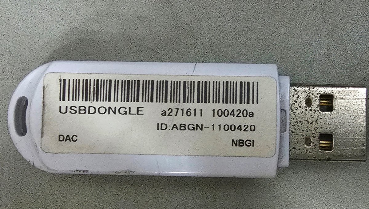

Here's a picture of the dongle case. I still haven't got to try to repair it, it is in fact missing components (diode, resistor) of which I do not know the values.
Ok cool. Thanks. The number I got from the manufacture is in the next picture.

So when you put your dongle in a regular PC you don't get anything, no files appear or it is not even recognized?
So low performance was just a graphics card driver issue, I got it running at native speed now. No news on the dongle yet, the traces are lifted and it is overall pretty bad, It will be tricky to repair, and it doesn't help I'm not that good with SMD soldering, at all.
Yeah now I am playing the waiting game.
According to others, there's nothin you can see on the drive, which is expected, but it should be recognized as a USB device.
So I received the dongle yesterday.. I.plugged it on and fired ip the machine. Still coming up with 19-22 USB Dongle Error(no dongle). I am now at a loss. I did plug into another PC after trying I game, and it is not even recognized. So now I do not know if I got a faulty one, or if it is because my machine is from Japan.

If the machine is from Japan, you should have ordered a dongle for the same region. You might reach out to support again and ask for them to exchange the dongle, you would lose on shipping but it would be significantly less.

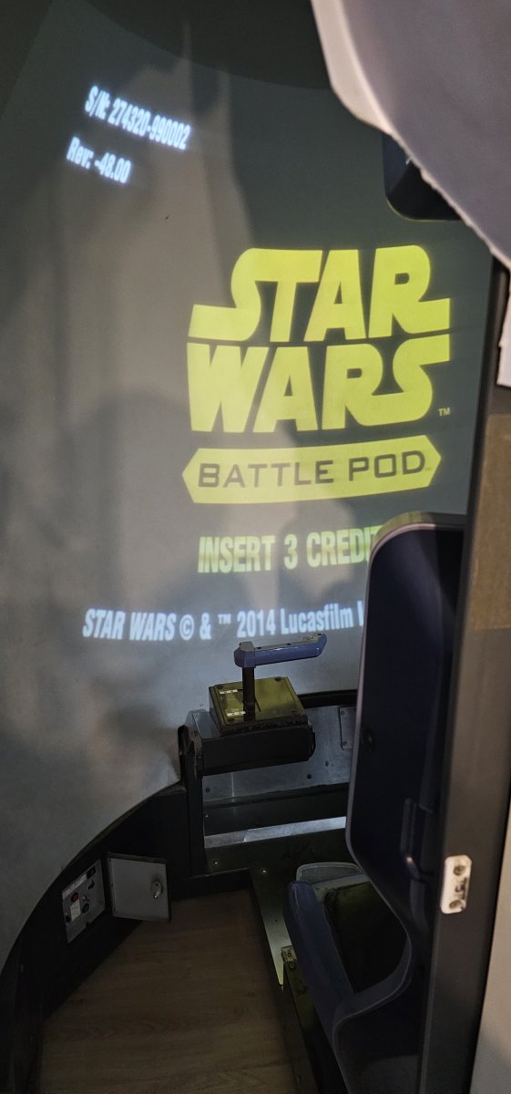

I have to report back, I managed to fix the original dongle thanks to the invaluable help of @Franco23444.
One thing to note here, the USB slot you plug the dongle into DOES matter. I first plugged it in the first USB slot, but after reading the manual, which states it should go into USB slot 3, I did so and it worked!
@Tableblazer We noticed your error is different than mine 19-21 USB DONGLE ERROR (INVALID DONGLE), if your says "NO DONGLE" that means either a bad dongle or a bad usb port.
Anyway, this beast is up and running again! All is left is adjust the projector and possibly get a new lamp for it.

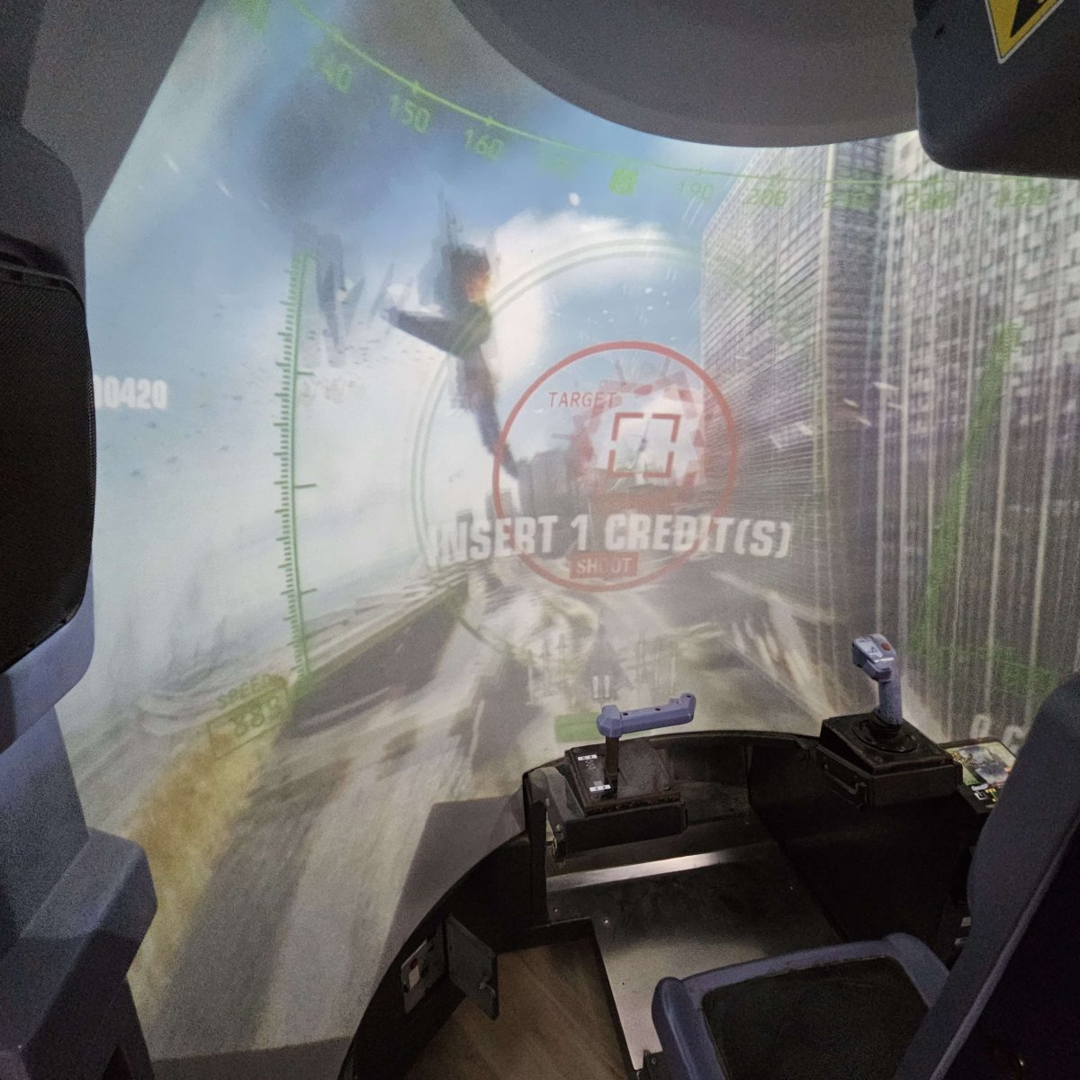

One more thing, I managed to hack into the "dancing bird" program source code and got Mach Storm and Star Wars running on the same hardware, fully IO operational by bypassing all the input hooks it uses to emulate the JVS interface.
I have some issues with the screen resolution and full screen display but I should be able to fix those.
Yeah. The error I get is with or without the dongle.plugged in. It's like it doesn't see it. I am trying all ports 1 by 1 at the moment. I have tested all with a mouse and they all.see that so pretty sure the ports are ok.
UPDATE. So I got in touch with Joe at Bandai-Namco America, appears that my pod is not from the N.A region(according to S/N), and therefore the "Dongle" they sold me will not work.
Good news is there is still a chance.
In the mean time I am playing mame games on it.
