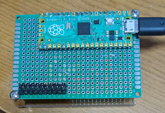

Yesterday I made simple Raspberry Pi Pico controller for my exA because why not (the 20-pin is for the brook harness)
The controller works perfectly on Windows but the IONA doesn't recognize it so I contacted Toyoshima last night, fortunately he has the Pico and will test it out
here's the tracking in case anyone is interested
https://github.com/toyoshim/iona-us/issues/41
I used the GP2040 firmware
https://github.com/FeralAI/GP2040

ya i saw that, im using the same software but wanted to make my own because its fun
