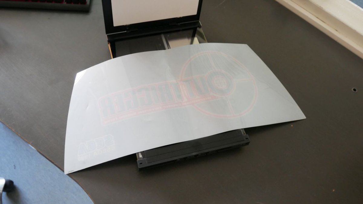

Here's a tutorial to make a scanner suitable for artwork out of a Canon LiDE 300. This is a cheap scanner that gives great results and the mod is very easy. I picked up mine for 70 euros locally. For anyone in the US, it's 58 bucks on Amazon.
Once you're done, you have a completely flat scanner bed that you can use to scan anything that's 30cm tall. Width is only limited by the space you have available around the scanner. Marquees, Japanese style control panels, move sheets, no problem.

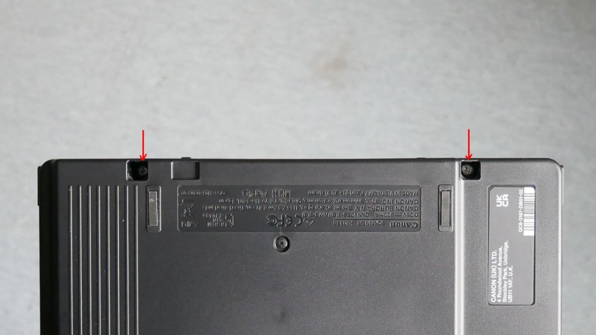

Remove these two screws at the back

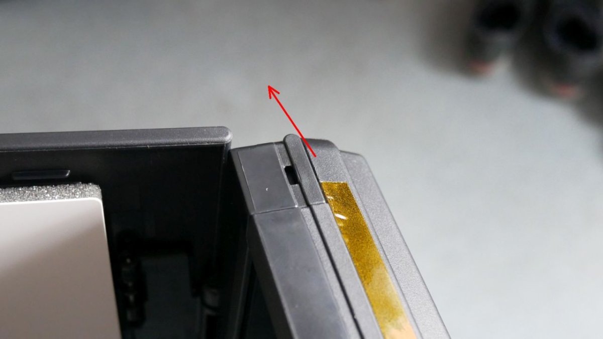

Pry the top plastic piece off, the one acts as a hinge for the cover. There's a tab that holds it in place, you need to clear it. Use a flat head screw driver or similar tool. Do the same for the other side.

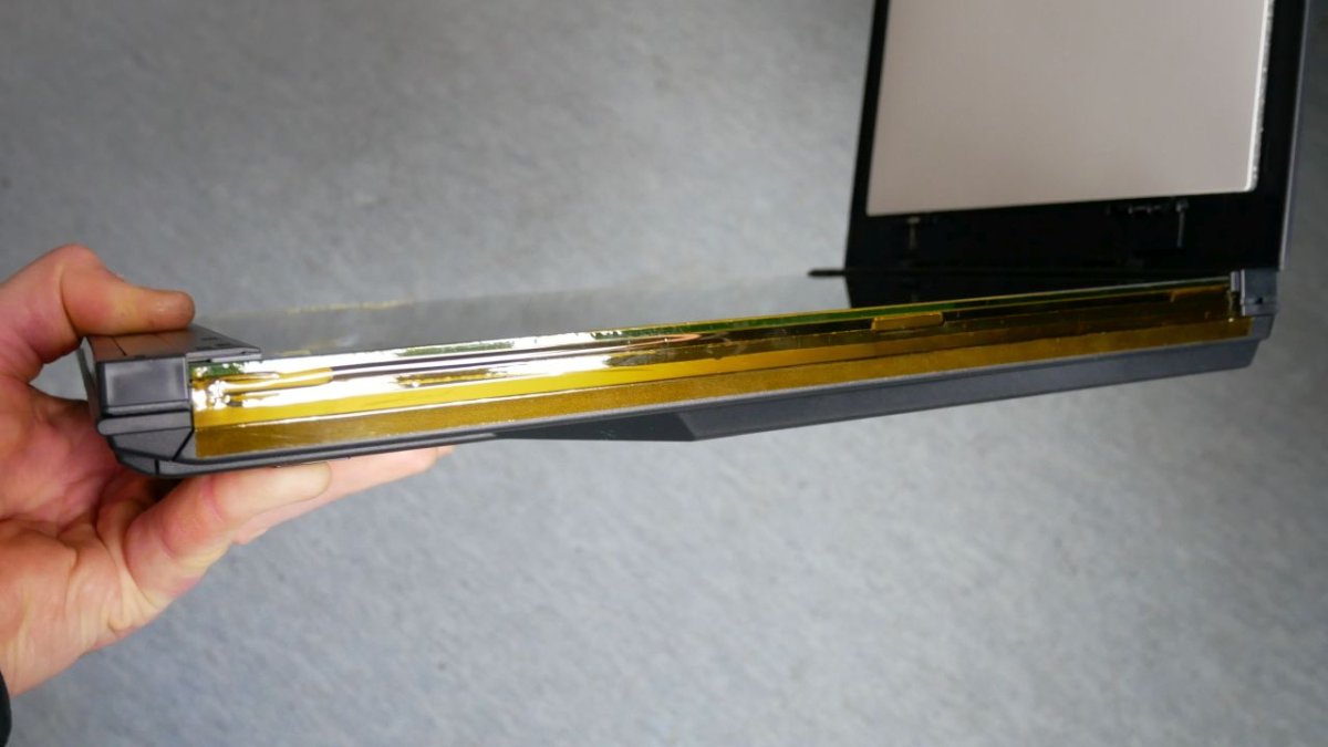

I placed kapton tape over the sides to keep the dust out, I suggest you do something similar.
When you have the sides taped, put the hinge back on. It just snaps into place. Put the screws back in. You can now clean the glass. Use alcohol for the tape residue.

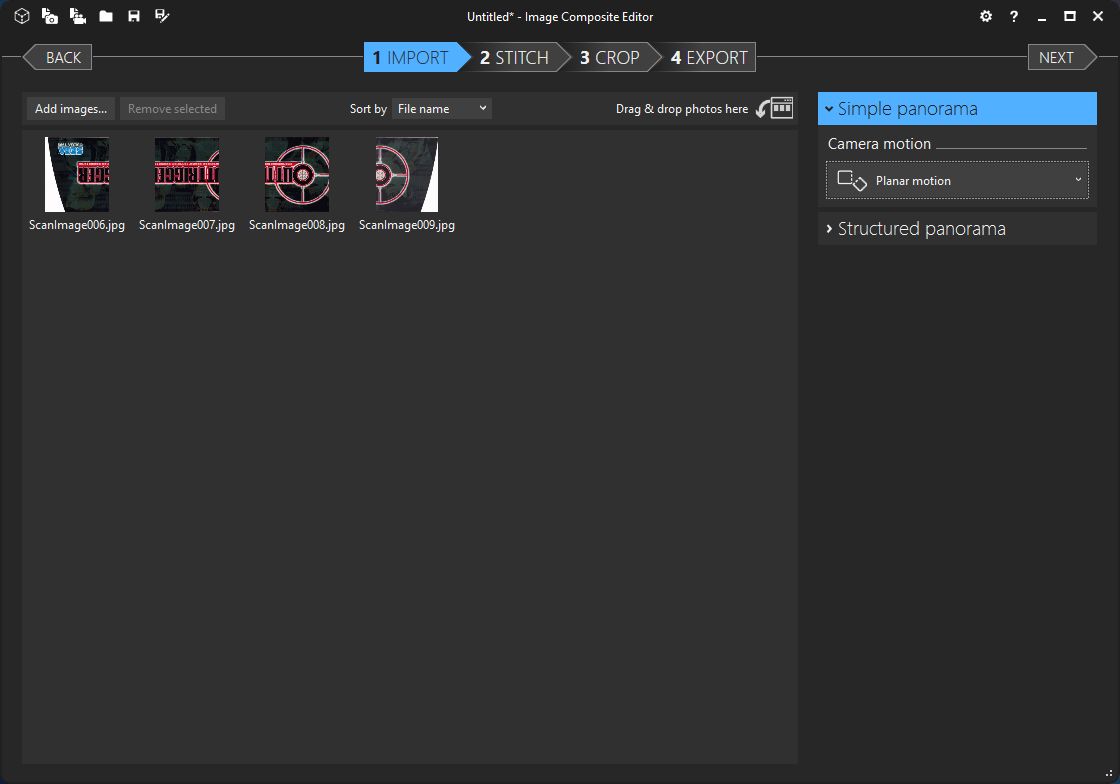

Start a New panorama from images. Pick your scans.
Under Simple panorama, choose Planar motion. Then just export to disk in the final step.
Here's an Outtrigger marquee scan:
https://mega.nz/file/FnQABTZZ#IIYQ6RQ5od9wwbQXnB6zS1551Axm-l2l7VFwlseFFVE
Looks pretty good!

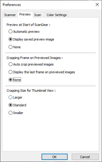

If you're using Canon Scangear for the initial scans, make sure to remove auto-crop. Crop by hand if needed.
Also, I only press Preview once on the first scan, then just Scan on the subsequent ones. This keeps the image height the same for every scan. Different heights can sometimes trip the stitching software to do stupid things.
