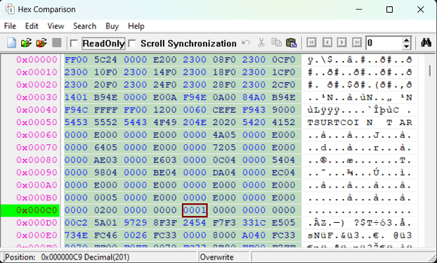

I took a look at the code and the byte in ram that unlocks all characters is cleared when you start a new game. So it's not posible to keep the characters unlocked.
But I did discovered a flag that the programmer use to test the character unlock function with. So what you can do is to patch one byte (This works for all versions and regions, both encrypted and decrypted) to unlock all characters in the game permanently.
To enable this change offset: $C9 from $00 to $01 in rom mvc*.03*

Am I reading this correctly? Patch ONE byte in mvc.03 to unlock all the characters, in all versions of the game?
Yes, thats correct, you need only change one byte. Depending of the version and region the "03" ("maincpu") rom will be different. If you test in Mame you can have a look at the Driver Source to find out the specific file for the version/region you want to test.
For example, Europe uses mvce.03*, USA, mvcu.03*, Japan mvcj.03*. and Phoenix Edition (USA) mvcud.03*
