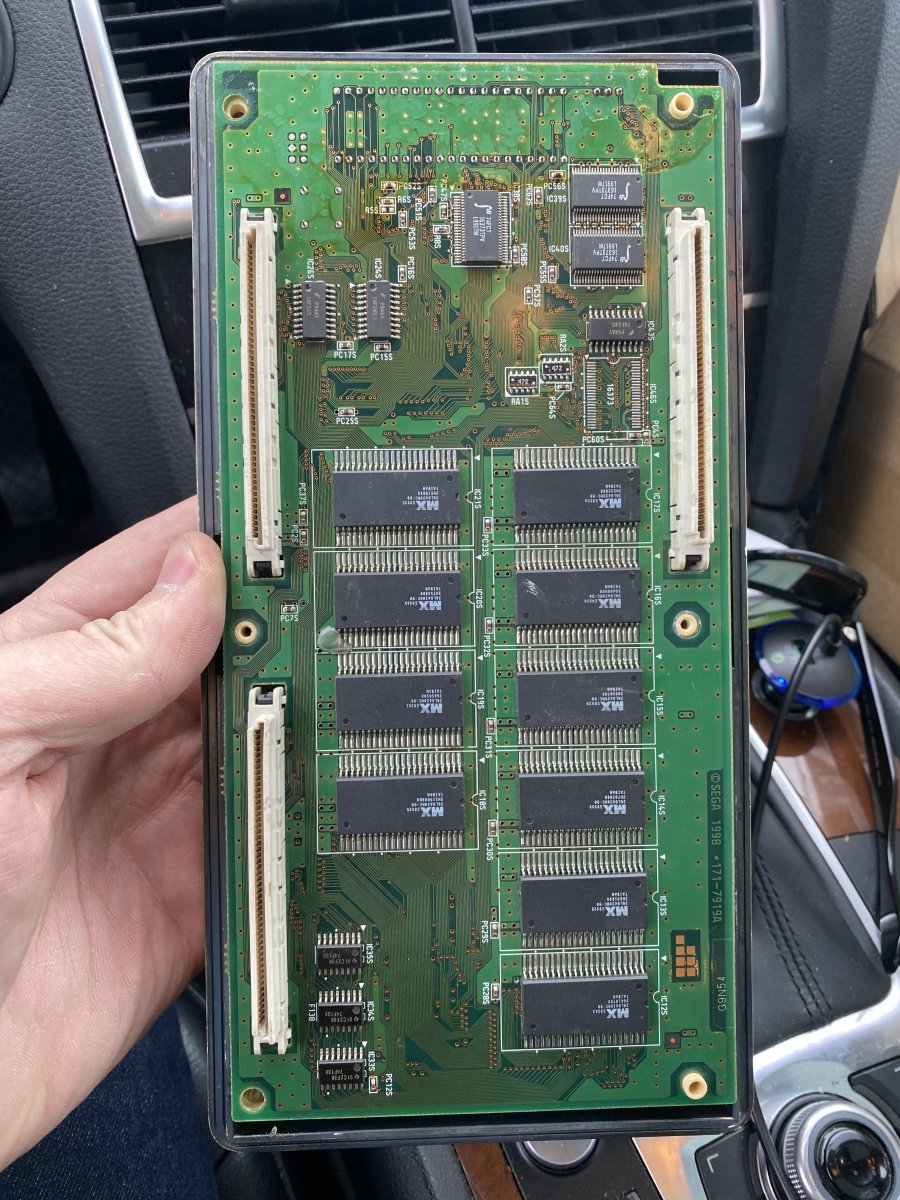

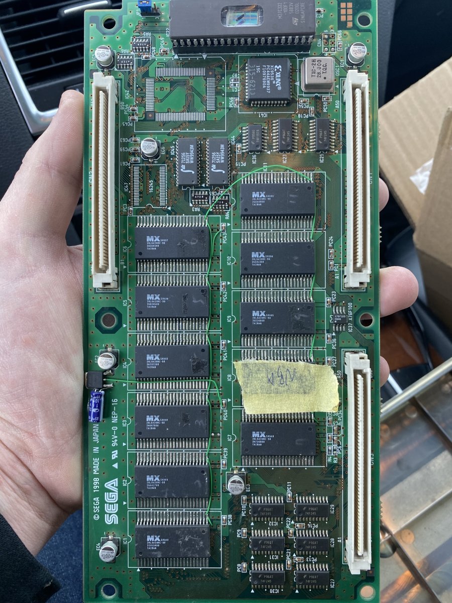

I got a few Virtua NBA carts in from Arcadegame66 on eBay, knowing one was an obvious boot (it was a DOA2 cart):
The second cart was a surprise boot as it was in a virtua NBA shell:

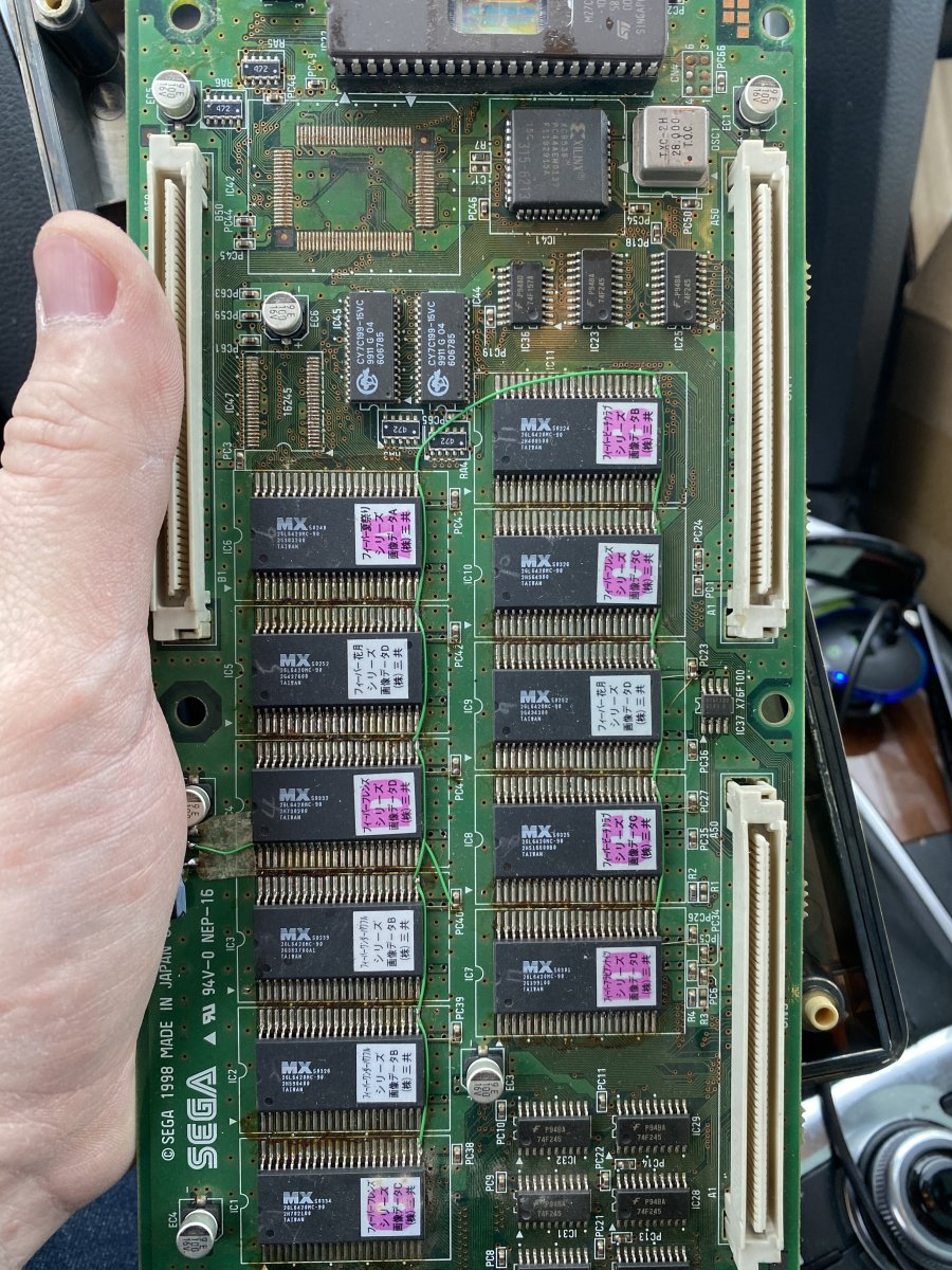

They’re decked out with MX26L6420MC-90’s.. I should be able to remove them and rewrite the ROM file I want, right?
That's some real fine spacing on dem feet...
I'm OK at the flux/drag method, but damn that looks killa.
I have no idea how he dose it, if you look at a Jorge cart, you can see he only desolder/solder one chip.
Its like he has found a way to force the Naomi to write the data?
As I said earlier in the thread, he uses the Flash cart variants which can be reprogrammed and don't require removing the chips. But those carts will run you about $250 a pop now because of how many have been converted.

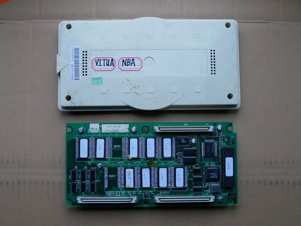

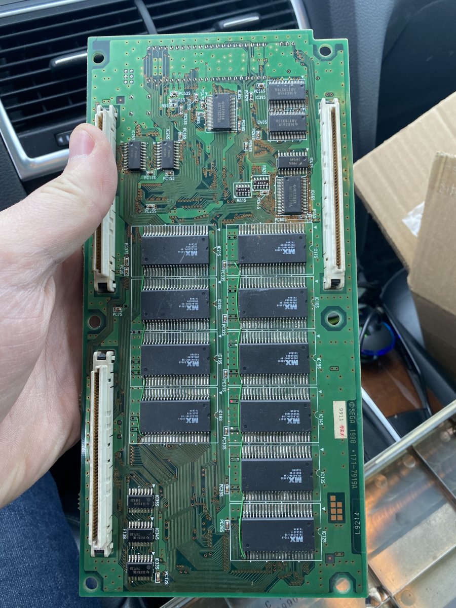

What started out as a dirty VITUA NBA [sic] conversion from yaton is now a dirty Monkey Ball conversion!
monkey_ball_cart_conversion_1.jpg monkey_ball_cart_conversion_2.jpg monkey_ball_cart_conversion_3.jpg monkey_ball_cart_conversion_4.jpg monkey_ball_cart_conversion_5.jpg

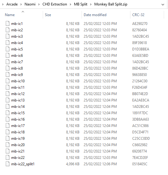

For anyone wondering, ICs 3, 7 and 14 are empty data. Those can be left out. Checksums are in post #16. As long as your roms match those, you should have a working cart.
I'm pretty happy. I managed to salvage the original eproms that were used for Virtua NBA. I used the original bootleg diode trick to power the chips to test the cart out, but it's pretty hot - 3.7V (should be 2.7 to 3.6V). I'll order some regulators.
I wouldn't want to make three more of these though :p

yeah, the only thing that has prevented me from making these myself is a rework station and other people's projects on my bench.
now that I have my final commissioned project wrapping up I can finally get my TT going.. I mean, Work on this for myself :thumbsup:
Also, thank you for confirming that those three ICs don't need to be burned. it saves time and effort! And I'm glad you and I thought the same thing, reusing the roms from the boots we were sent.
now, Who's printing labels up for these? because I would LOVE to make this look somewhat legit without my own 'VITUA NBA' label LOL

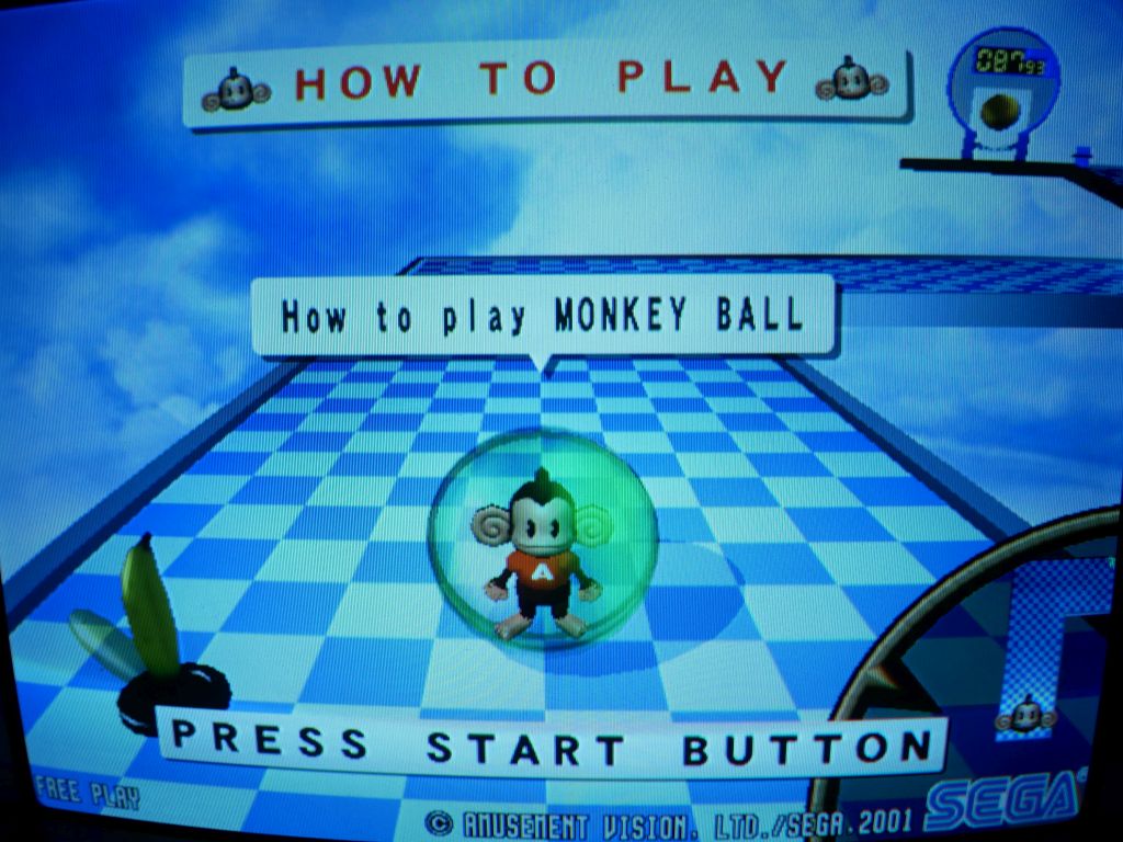

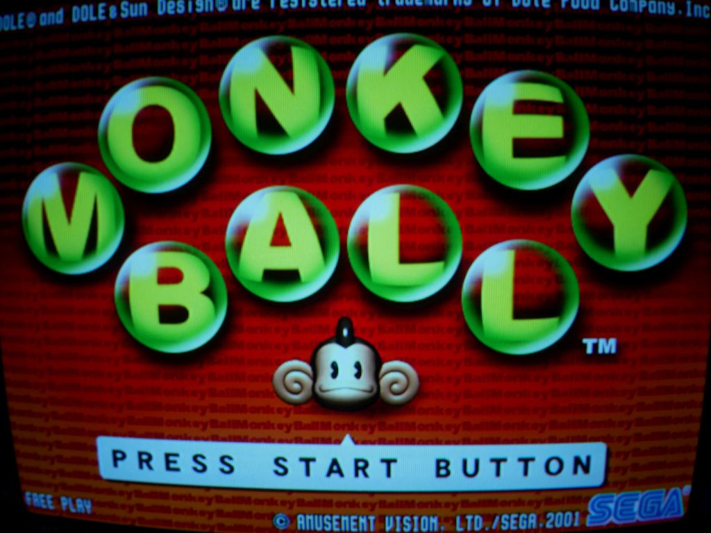

I have it booting in Mame. It fits exactly into the needed rom space.
This is going to be a pretty silly question, but how does one boot this in MAME to "test"?
I've split up the MB bin and managed to get the same CRC32 checksums as per the previous post, but I would like to test it out like you have done here.
Do I just simply zip it all up or does it have to have a particular name of each rom? Right now i've just named it like this:
