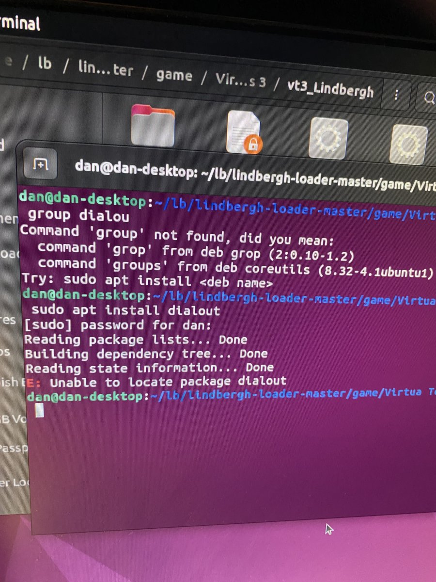

tried running sudo usermod -a -G dialout,input $USER
im root@dan
i also saw the script arranged like sudo usermod -aG
but even though i have open gl error and vertex shade error
game loaded to drive board is not connected to main board error . please i need obviously to set mu user groups permission to access the input outputs dialout. but i cant seem to run the script to do this correctly
help massively appreciated thx
When i first installed. I noticed a E: high lighted in red?!
Now trying to run emulator as group dialout …
I’m running into the E: no location found isssue ?
Any help please ?
I’m not very savvy with Linux users / groups ..
But I found this in the net regarding
Trying To use tty/usb0
/dev/ttyUSB0device has the group of dialout
Add second user to the dialout group:
sudo adduser second_user dialout
So I think this issue is I’m trying to open a location /serial port for the ffb emulation to the ffb boards rs45 ?
