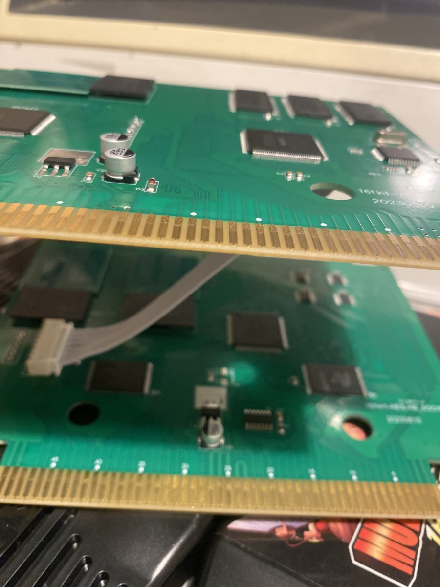

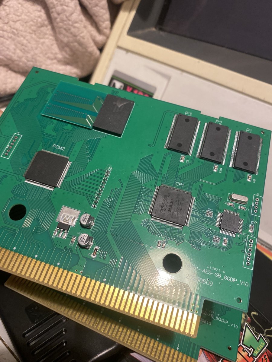

Hi Rewrite,

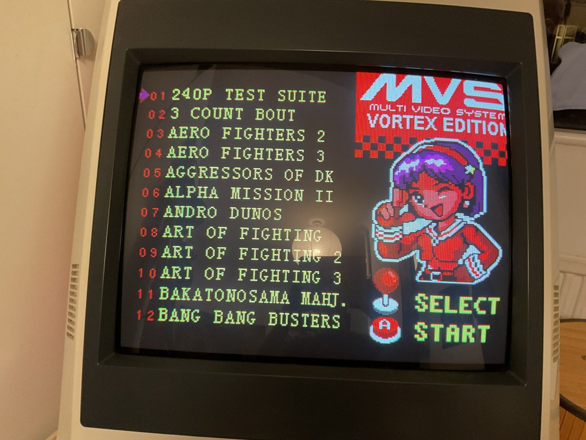

I am running into a few issues, I would say about half of the games play, just tested the Real Bouts and none of those work, Mark of the wolves doesn’t work but KOF2K3 does, Blazing Star doesn’t work or Samurai Shodown 5 Special or Perfect… but SS2 is fine, Strikers is good and Xeno crisis.
Each time the games try to boot but then go back to start screen games 1-12 as pic below.
I tried 3 different types of MVS board, the newest MV1C, a MV1A and a MV1FS but all the same, any ideas. Thanks :thumbsup:
Yep, I know what happened. 2-3 of them this happened with. Do you have access to a USB Blaster, or FT232H?
Thanks for the quick reply, no unfortunately I don’t. Is it ok I send back to you to fix? Both of those sound a bit daunting!
Cheers :thumbsup:
I mean if it’s really simple, I could buy a usb blaster and give it a try.
Cheers :thumbsup:
It's dead simple. Five wires from the programmer to the cart, unzip one small program, put in two lines in command prompt, and press enter. Wait about 6 seconds. Sometimes you have to install a driver. And would save the international shipping costs.
