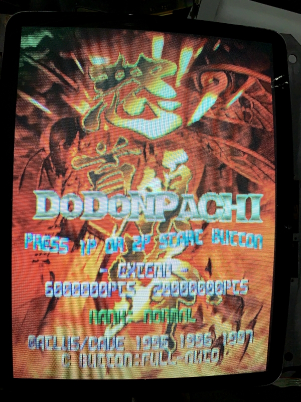

I dunno how you got that tube to fit with the Blast's curve. Here I have the Net City's bezel laying right across it, and I got plenty of light bleed between bezle and screen. Any gaps in your installation?
Theres some small ones but you cant really tell. Mainly top and bottom, could easily be remedied with some foam but I plan on selling it so I'm not going to bother. Good looking picture too.
FWIW thats the tube I used for my Blast swap.

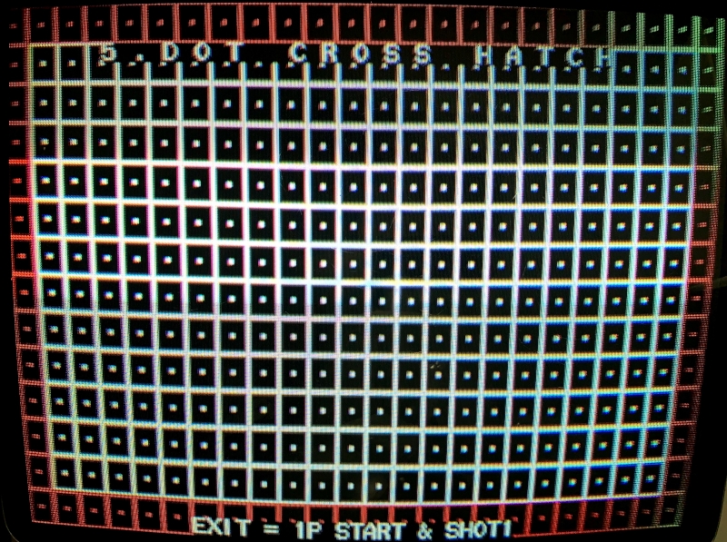

I need to see a crosshatch screen ;)
Some CPS3 crosshatch action for ya.
I have some work to do with the yoke positioning, but it does not look like this tube needs convergence rings at all. When I opened up the TV set, it had no convergence rings.

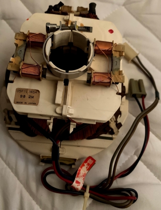

Swooped up this MS2930 yoke along with convergence rings. Will use it to test out if any of these 4-6 screen fitment compatible tubes that I have will actually work with a Nanao MS2933 chassis and frame. If not, off to the recycle center these go as they take up a lot of space. I certainly could have just pulled the yoke off my Net City MS2933 monitor, but I didn't want to have to go through the hassle of reconvergence and realignment with the MS2933 as a result of my experiementation. Will start with the M-Grade tubes as those are of higher quality. Will measure yoke specs first too in hopes that one of the native yokes are compatible. I have some connectors handy to reterminate yoke, degauss coil, and dag strap connections ready to go too.
