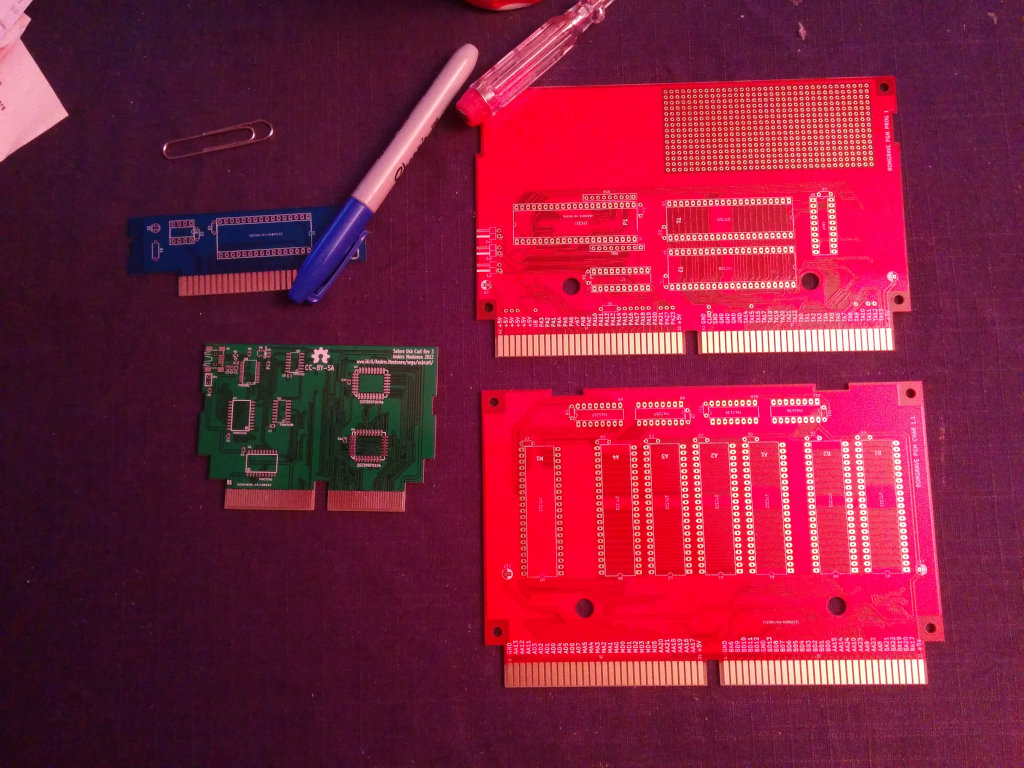

Tests are going well, and I'm making only minor changes to the position of some chips to help with assembly or fitting it into a cartridge. I seem to be able to run all three games, though I need to make a full run of Do Don Pachi to see if anything goes wrong in later levels.
The upper red board is the program board. The jumpers can be used to configure the PAL to change the program ROM mapping, though they are optional. You can program the PAL with a different file for DDP or Espgaluda and Ketsui and leave the jumpers unpopulated. JP2 can be used to select the second ROM bank, for example for the Ketsui Trap ROM. Obviously you can install a switch of your choice on that jumper.
The fully featured PAL can select between DDP/ESP, low and high bank, and a special "4MB" mode in case someone fancies some NGDEVTEAM-style homebrew or a mod that requires more memory. ;)
The lower red board is the character board. I only fixed the problem with the M-ROM decoder and tweaked the placement of the logic chips. It seems to work fine.

...and as pictures are always fun:
Fully populated for Ketsui, jumper set for "trap" version.
Trap version in the sunset... along with the ghetto controller I have to use until I get my Neo Geo controllers back.

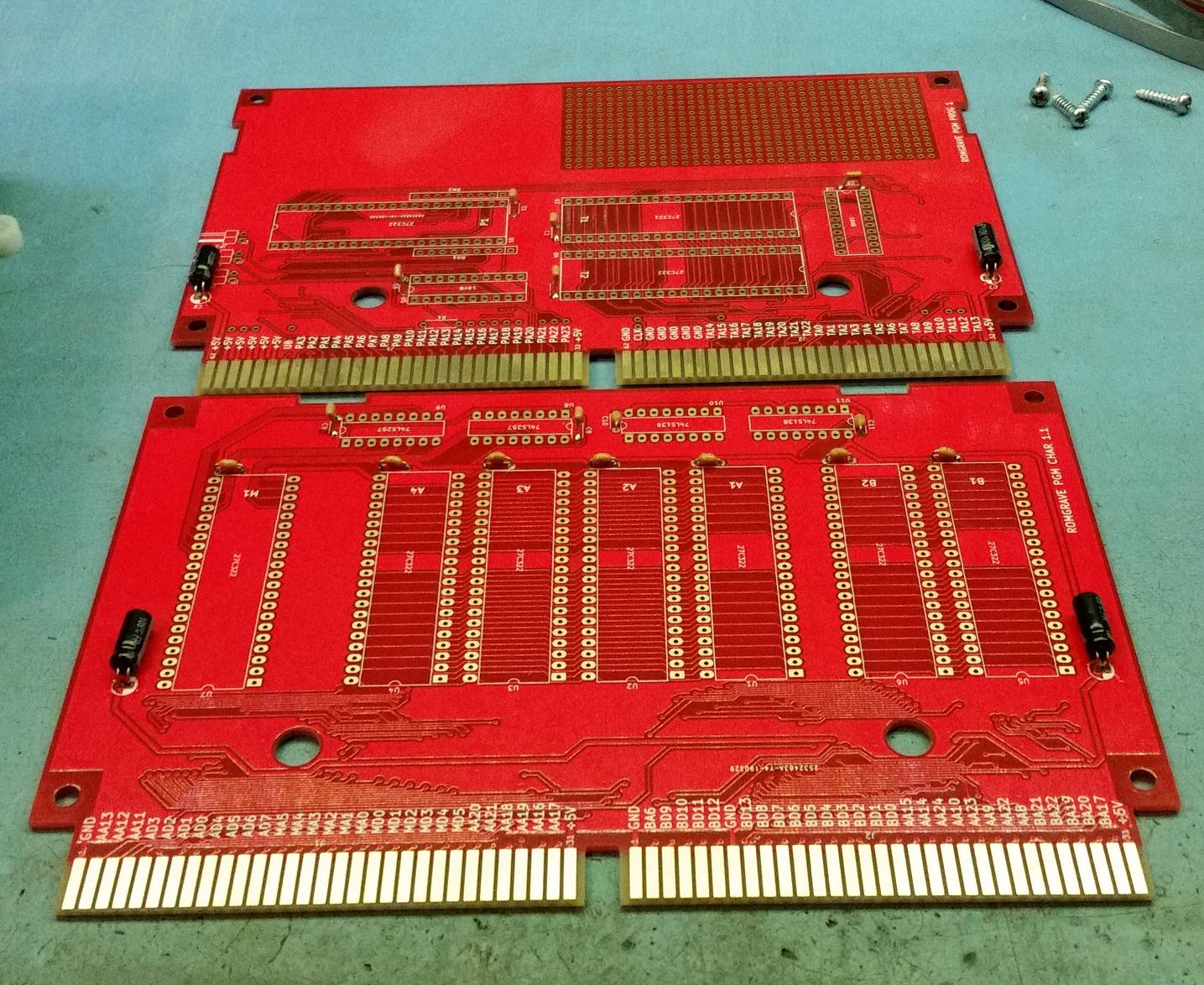

First FEEDBACK...
After popping in 2 x 100uf 10v Electrolytic in.... The pads are way toooo close together. Its way easy to bridge them and not notice. Considering the is +5V and Ground... That could distroy the PGM and the PCB.....
They don't have to be as far apart as the de-coupling caps (0.1uf's).... maybe add another 2mm to the gap??
Yes, I agree. I noticed this while assembling as well, so I switched them for the standard 2.54mm grid. I doubled checked them both with a magnifying glass and multimeter for bridges.

The char board will not fit into the cartridge if you use sockets, but as you have only one board so far it may be worth it so you can swap games.
BTW, I'll most likely return to 1.2mm thickness for the boards as well. 1.6mm makes inserting the cartridges a bit hard.
The only other concern is there is only 2 power pins supplying power to all the eproms on that board.... They would draw way more than the SOP MASK roms that are normally present..... 7 X 27C322's.. they already get warm when there running......
But you would have to make like a jumper from the top board to the bottom board... So not very practical....BUT would be doable.....
