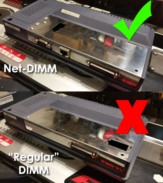

2. A Compatible Net-DIMM board
Not necessary if you've got a Chihiro Type 3 or a Tri-Force Type 3 with a gd-rom port as this board is built in already. Otherwise, there are some variations you need to be aware of before buying.
Variations: Net-DIMM boards are not to be confused with a "regular" DIMM board which lacks the Ethernet port and cannot Net-Boot games. Reguar DIMM boards are a lot more common and lot cheaper so make sure you verify it has an Ethernet port before you buy it.
Memory: You will also need to make sure it has enough Memory to support your games. Most will have 256MB which will cover all but 5 games for NAOMI and NAOMI 2 (see the aforementioned chart). For those 5 games as well as Tri-Force and Chihiro you will need a 512MB Net-DIMM. I believe there is only 1 game on Chihiro that requires 1GB. Official Sega DIMM boards that have more memory will typically have an oval sticker stating "512MB" or "1GB". Smaller capacity boards can be upgraded. It uses regular PC style Memory DIMMs (hence why it's called a DIMM board). Which can be upgraded[.1093/url].

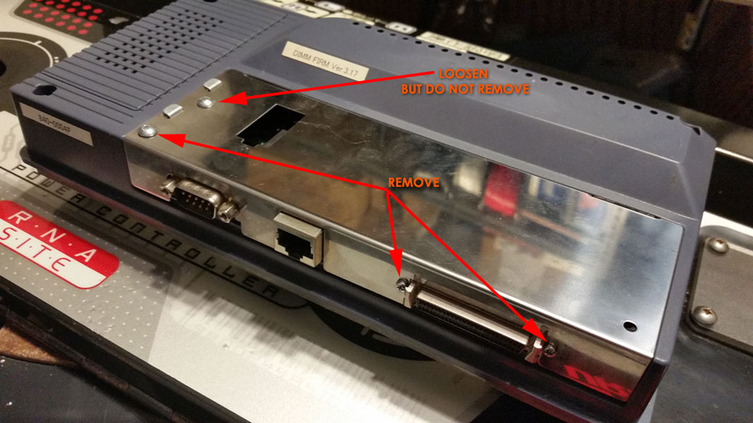

Setting Up the Net-DIMM board
For NAOMI/NAOMI2 and Type-1 Tri-Force and Chihiro
You'll want to start by checking to make sure that your Net-DIMM board is setup for Net-Booting. If you have a key-chip installed start by removing that. Once that's out remove the metal shield from the top of the Net-DIMM board. You'll need to loosen a few turns (but not remove) the screw centered on the left edge at the top, then remove the other screw on the top, then the two screws on either side of the 50-pin connector. The shielding should come right off, if it's is hung up on the left side then try tipping the board to the left, failing that you may need to loosen the screw on the left a bit more.
Once the cover is off make sure that the Jumpers are set as follows:
JP1: 1+2
JP2: 1+2
JP3: 2+3
This can also be seen in the pic below.
Now is also the perfect time to install your Zero key if you have one. Make sure the alignment notch on the chip points down as shown on in the picture below. When you insert it you'll want to hook a finger around the back side of the board for support as it is very flimsy and unsupported. Without doing this you could risk damaging this board if you apply too much pressure when inserting the chip. That weird metal hook under the shield is designed to hook under this board for support so that it is not damaged when a key chip is installed. Without the cover in place there is no support, which is why I recommend using your finger.
Once the jumpers are set and your Zero key is installed you can re-install the shield. If you're having trouble getting it to sit flat look through the key chip hole and make sure the loose metal piece is hooked under the PCB and not on top of it. Try tipping the board left or loosening the screw slightly. Failing that you can use a small screw driver to push it off so it hooks under the board. Just be careful not to scratch or damage the PCB.

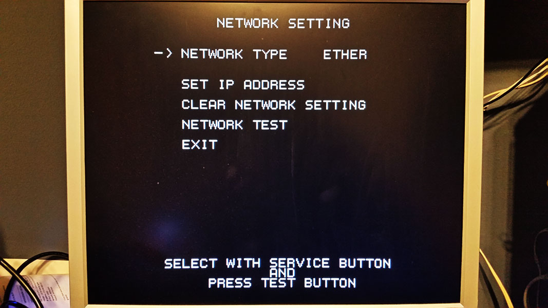

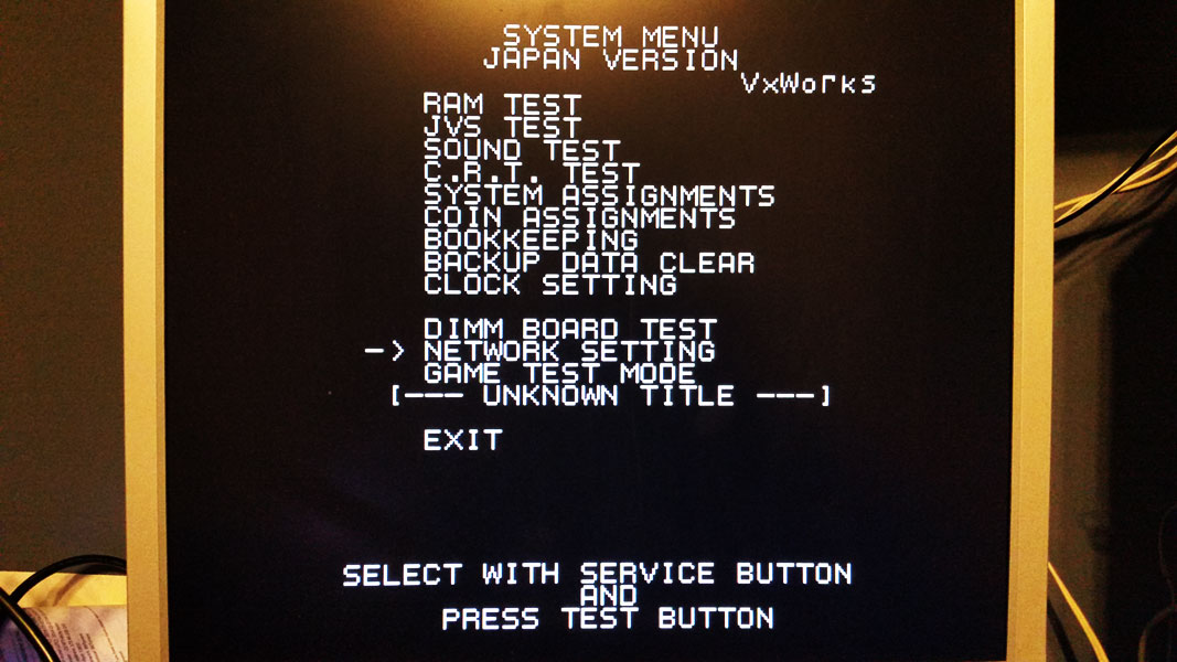

With the properly setup Net-DIMM board installed you'll want to power up your Console. You should see it boot up to a message saying that it can't find the Gateway, this is good. If it doesn't see your Net-DIMM board or you have some other error you may have a BIOS or some other hardware problem.

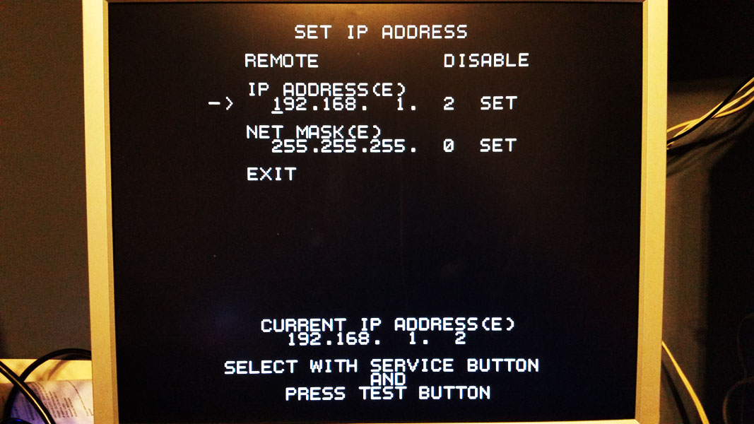

Next we need to setup your Console to connect to the Raspberry Pi. Push the Test Button to enter the Service Menu. As long as the Net-DIMM board is properly installed and your BIOS supports Net-Booting you should see and option for Network Settings, select that option.
Once in here you'll want to set your Network Type to "ETHER" then your IP address to 192.168.1.2. and your Mask should be set to 255.255.255.0. We use this IP address as that is the default address that Pi-Force Tools is set to use. Once these have been set, power off your console; it is ready to Net-Boot.
