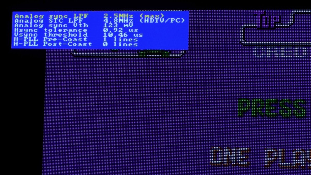

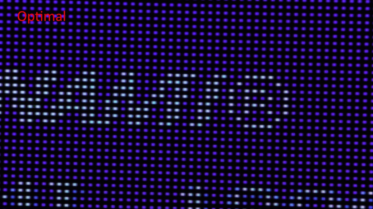

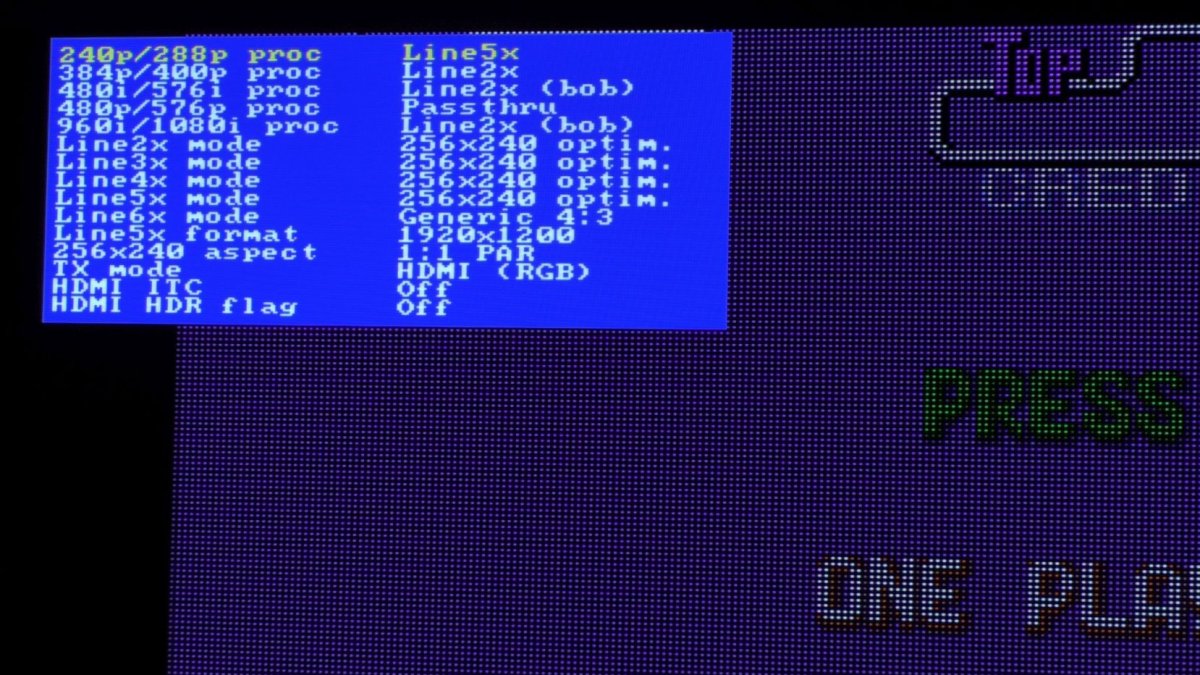

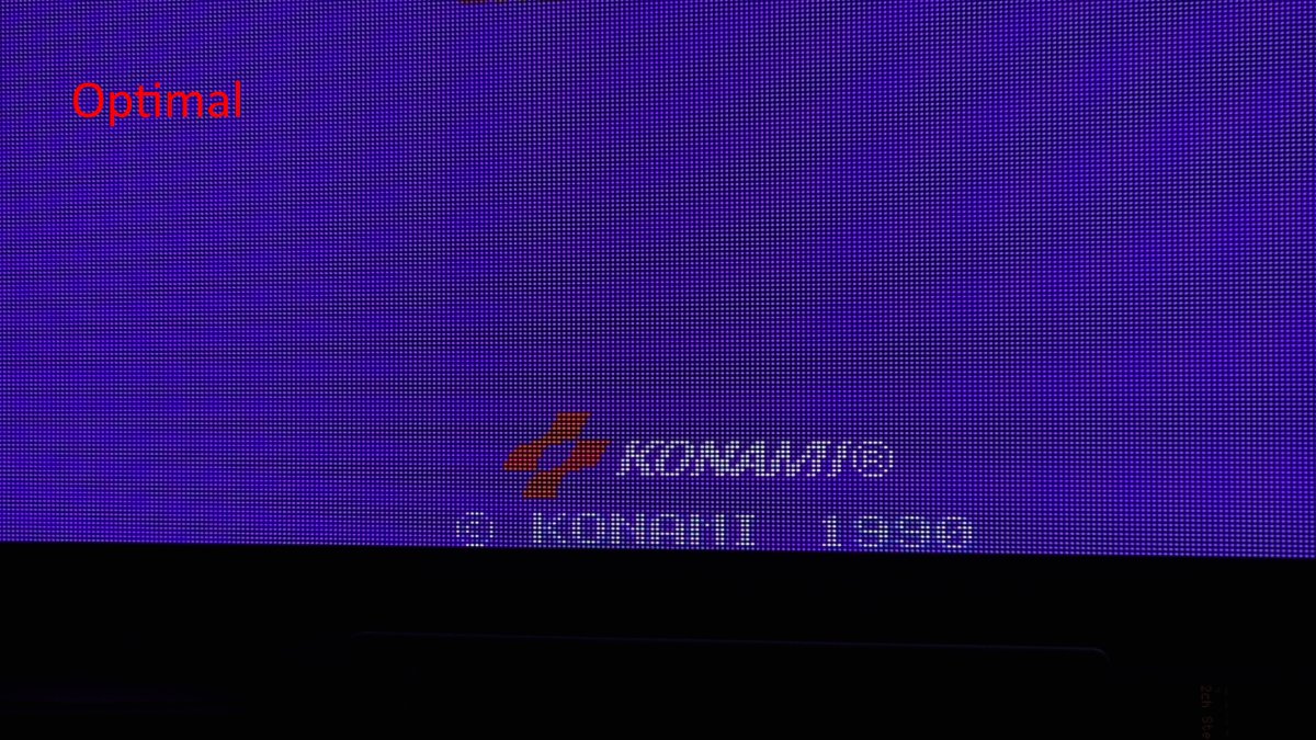

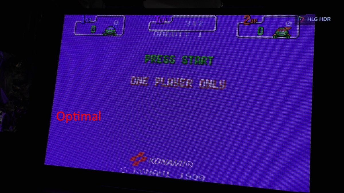

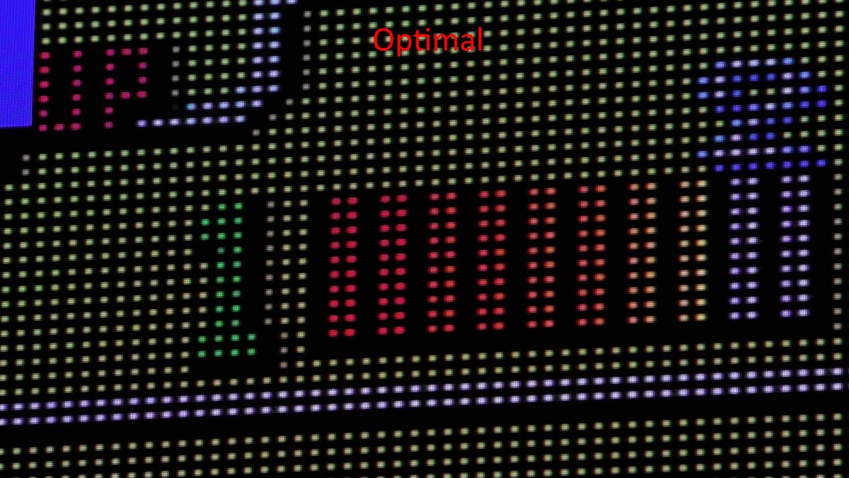

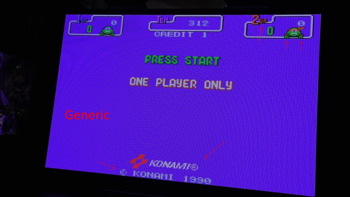

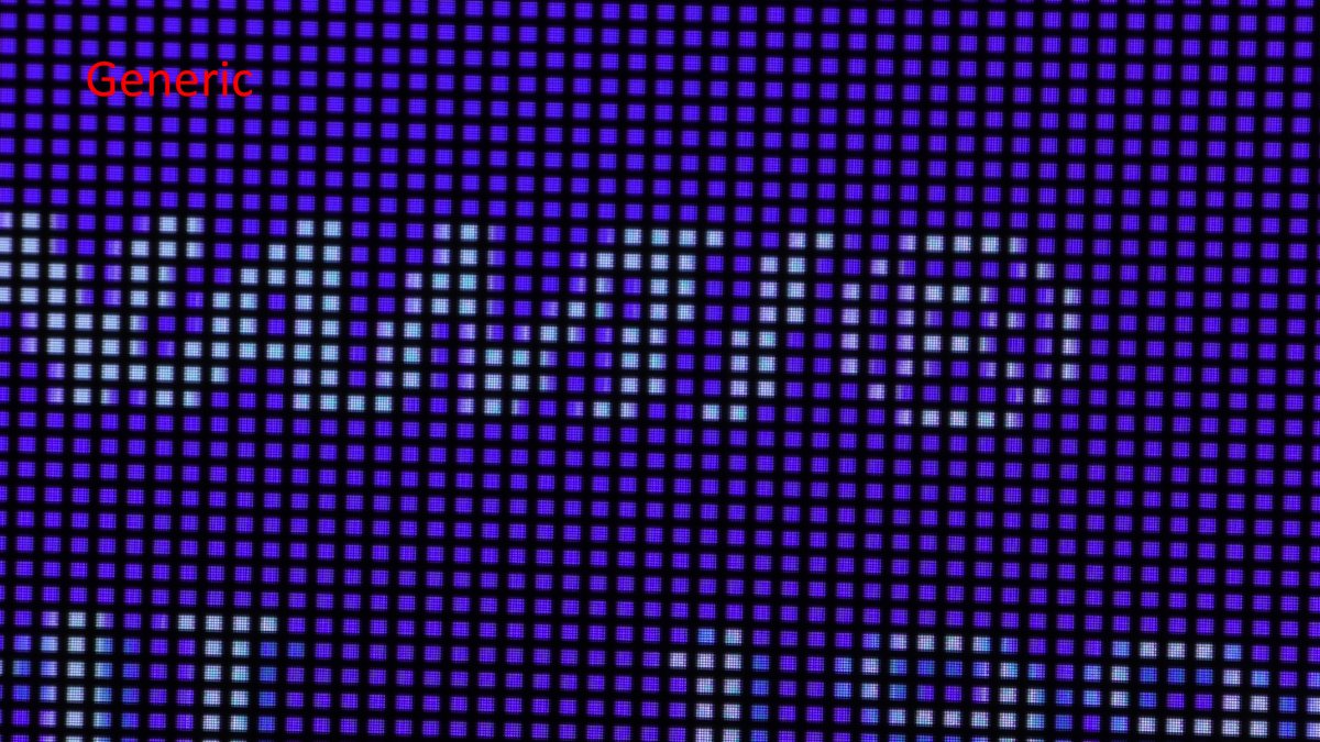

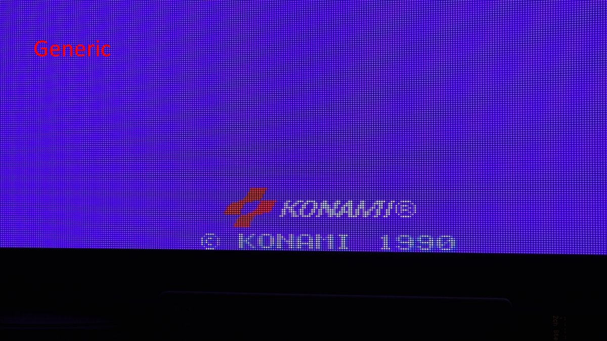

I managed to get TMNT dialed in to perfection. I'm so happy with it! I'll post some images to show the difference. I pointed out some of the more obvious differences but if you look closely there's plenty more. The extra pixels on the HP bars is one of the first things I noticed when testing.
The scanline settings are for purposes of showing the differences. It can be seen with them off as well but I feel they really help show exactly what's going on. I used Line 5x Generic & Optimal.
If you want to try my settings lemme know and I'll post em.
1 game down.. lots more to go lol.
Thanks everybody :)

Wow, I DO see a difference, but weirdly enough, I think I like the generic look more, it fills the square!
Please post your settings, I'll try them both on my OLED and take similar pics to post. I can do TMNT or anything else you want. Let's get some comparisons. '
Do a post without the scan lines, I guess I'm not 100% sure of what I'm seeing here, are the pixels just smaller (ie sharper)?
@XtraSmiley
No need to worry about the square being filled or not. That's just my scanline settings. You can make them literal perfect squares if you want assuming it's dialed in correctly. The big thing I've learned about sample rate is that it's more about where each pixel lines up on the screen rather than the shape of them so much. Too low sample rate will get you pixels too far apart and outright missing information. Too high will cause overlap. I believe this is because in a sense "too much" information was gathered as seen in the pictures above.
Here's a great video I found explaining sample rate:
View: https://www.youtube.com/watch?v=nLmB1qcXT4Q

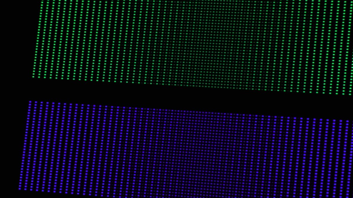

Here's another photo to show a misaligned sample rate:
It's not the shape that's so important here but where the pixels are placed. There's supposed to be a clear black gap between each vertical line. You can see it correct on the left and right side, but the middle is all messed up because the sample rate is too high there and it's putting additional blue and green pixels where none should exist. A correct SR would fix that and make it completely uniform.

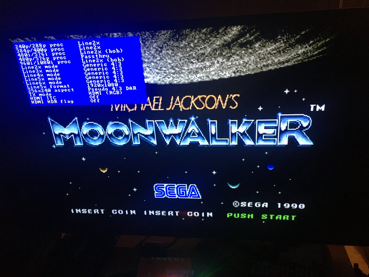

Here's my settings I'm using. I'm on a 2 player Japanese PCB but that may not matter. You may need to slightly adjust your sample rate differently than mine but it should be very close if it's not exact. I used the cross pattern in the test menu of the game to help dial it in properly since it does a good job showing the flaws especially when the scanlines are on.

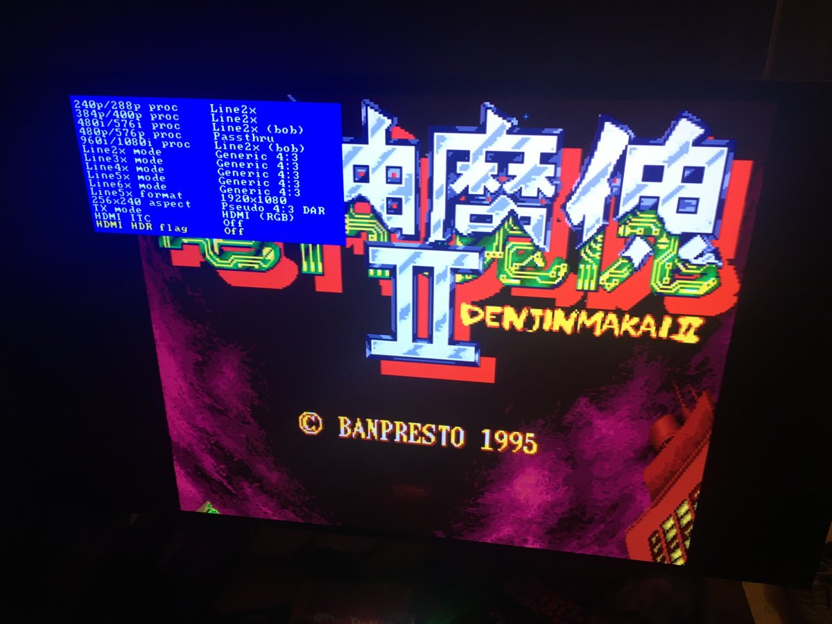

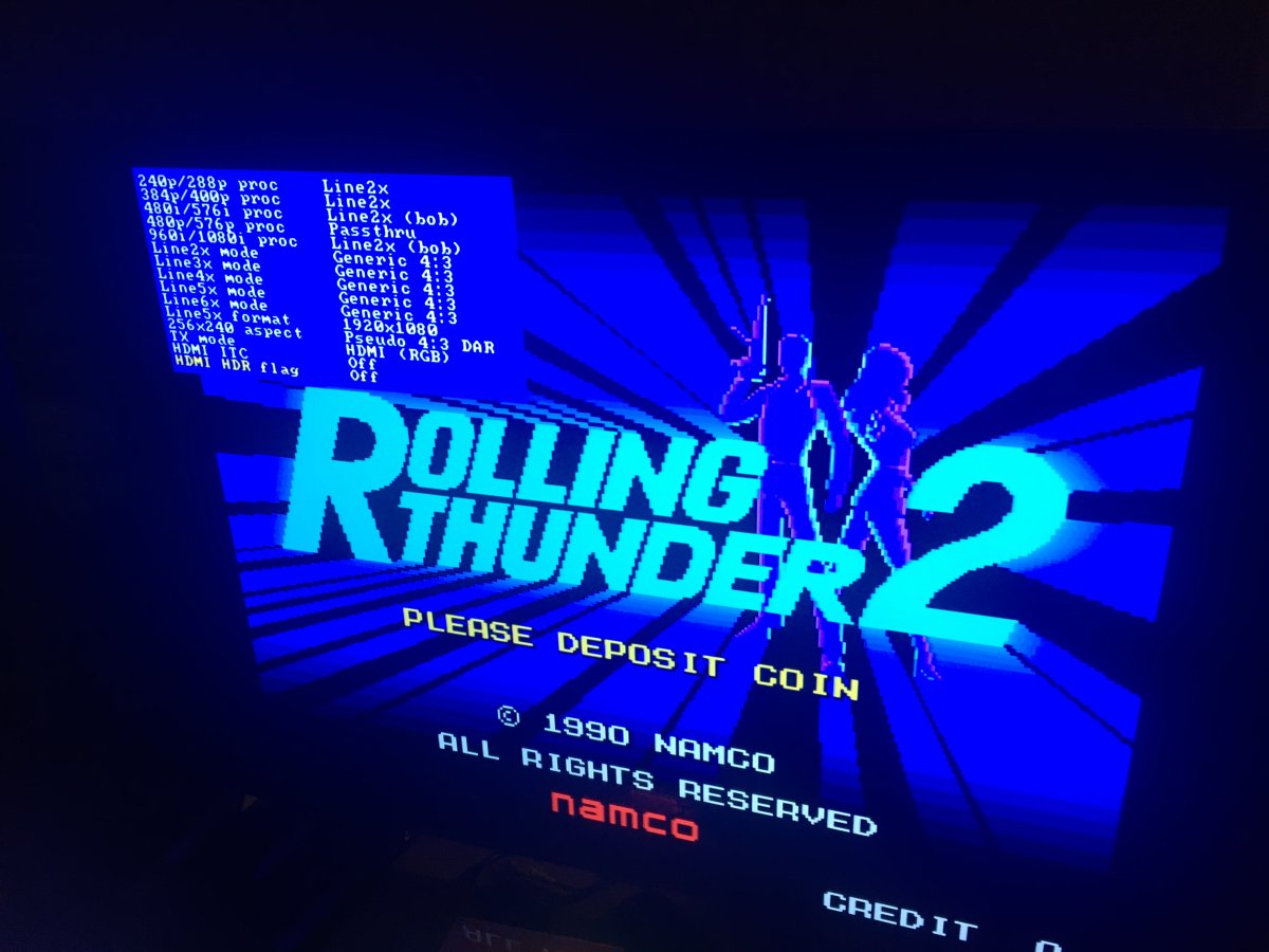

I've done a few tests (I use Vega Jr. supergun, LG C2 42" OLED TV, Genesis 1 RGB cable and OSSC 1.6 with 1.06 Beta fw) :
CPS-1
Banpresto PCB (Denjin Makai 2)
Sega System 18
PGM
Namco System 2
