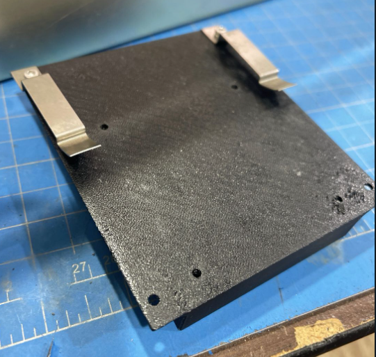

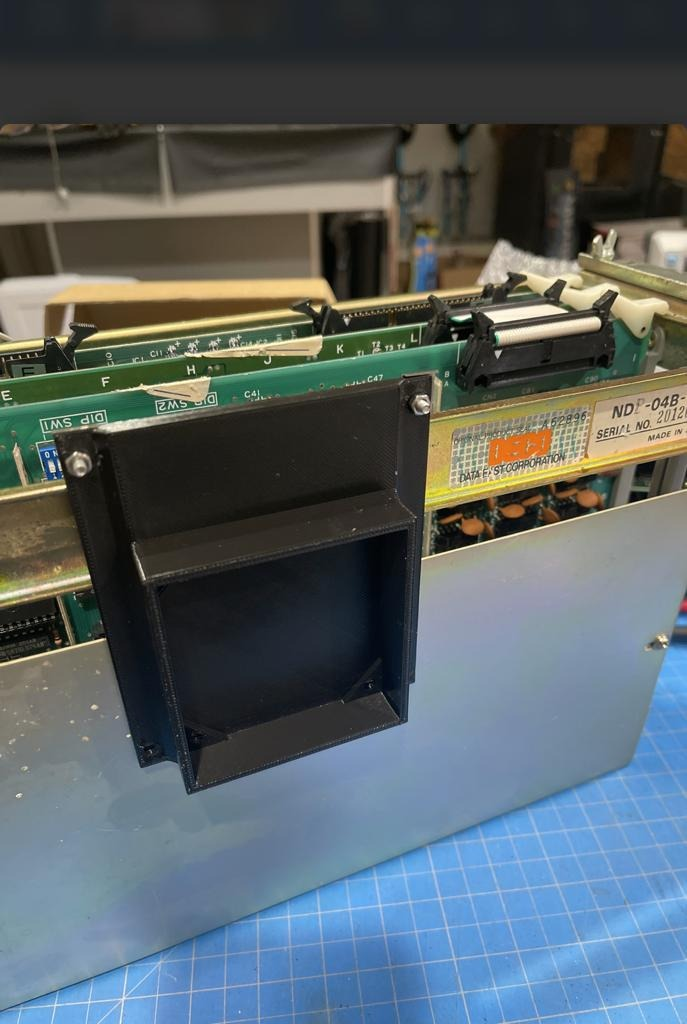

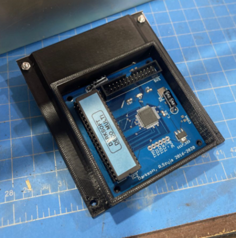

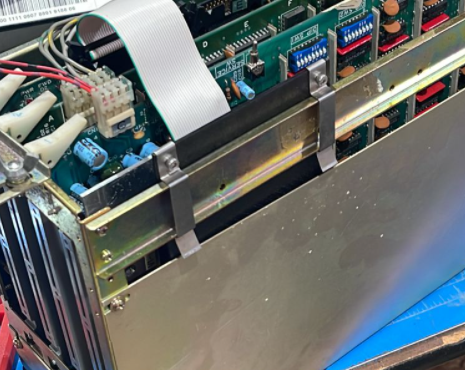

I just wanted to post a pic of the 3D printed case I designed to use the clips from an original Security dongle to house the Multi PCB.
The final revision is being tweaked and will be done soon, but @Darksoft asked me to post.
What a great multi for such an interesting part of arcade history.

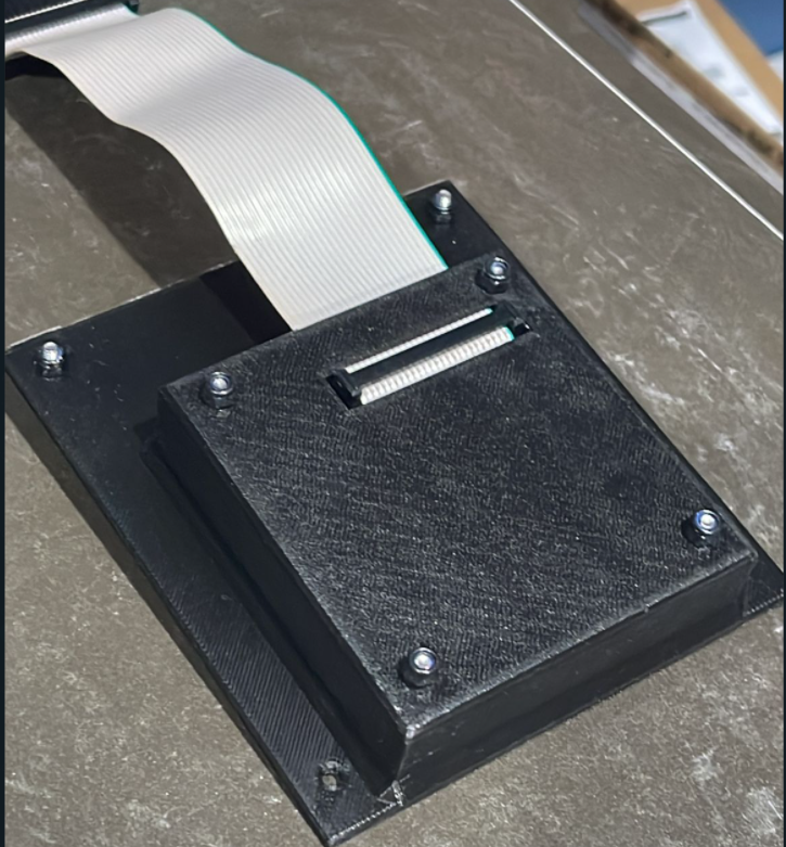

I ordered some black finish nyloc nuts and will build up a full / final Revision.
Will keep everyone posted.

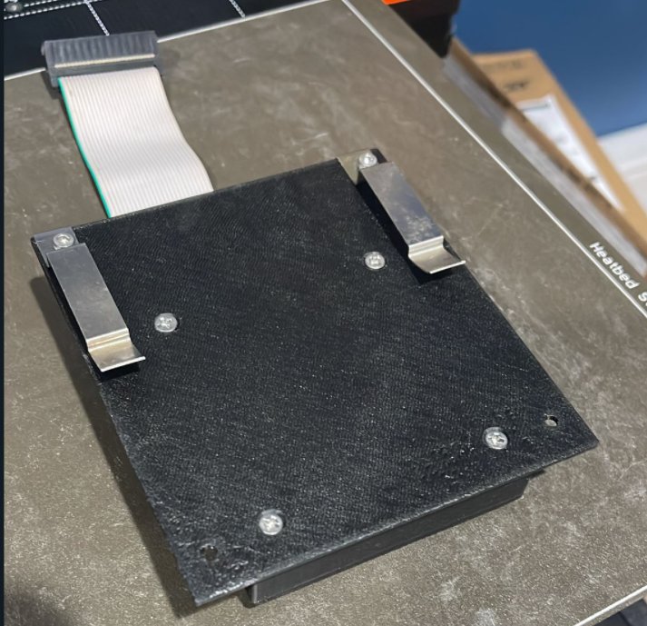

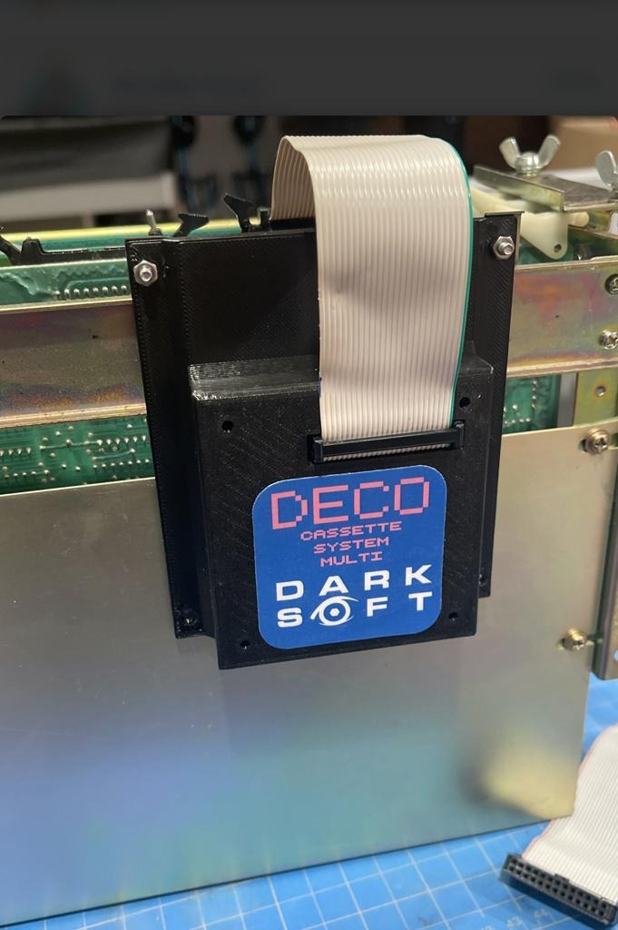

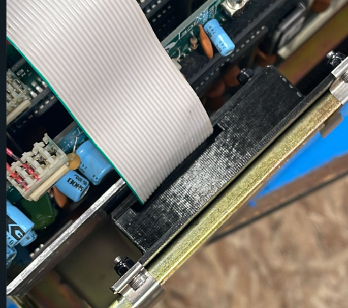

Next Revision is complete.
Assembled using the metal clips from security dongle.
Before assembly I used countersink on the back side so the flathead screws will sit flush with the back.
If i get more time, I will add the countersink to the design
I used:
3pc M3x25 flathead screws (do not install screw in hole closest to ribbon cable at the top)
2pc M3x5 socket head screw to hold clips
5pc M3 nyloc nuts.
