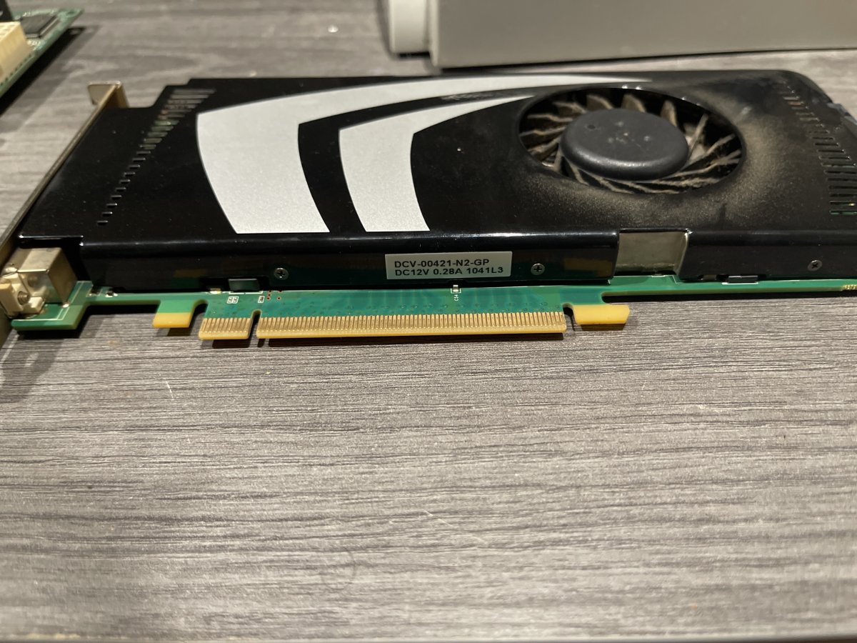

Yes it has a 9600 GT in it.
is it supposed to have that?
it loads an ATI driver for a "fire GL" wjatever that is

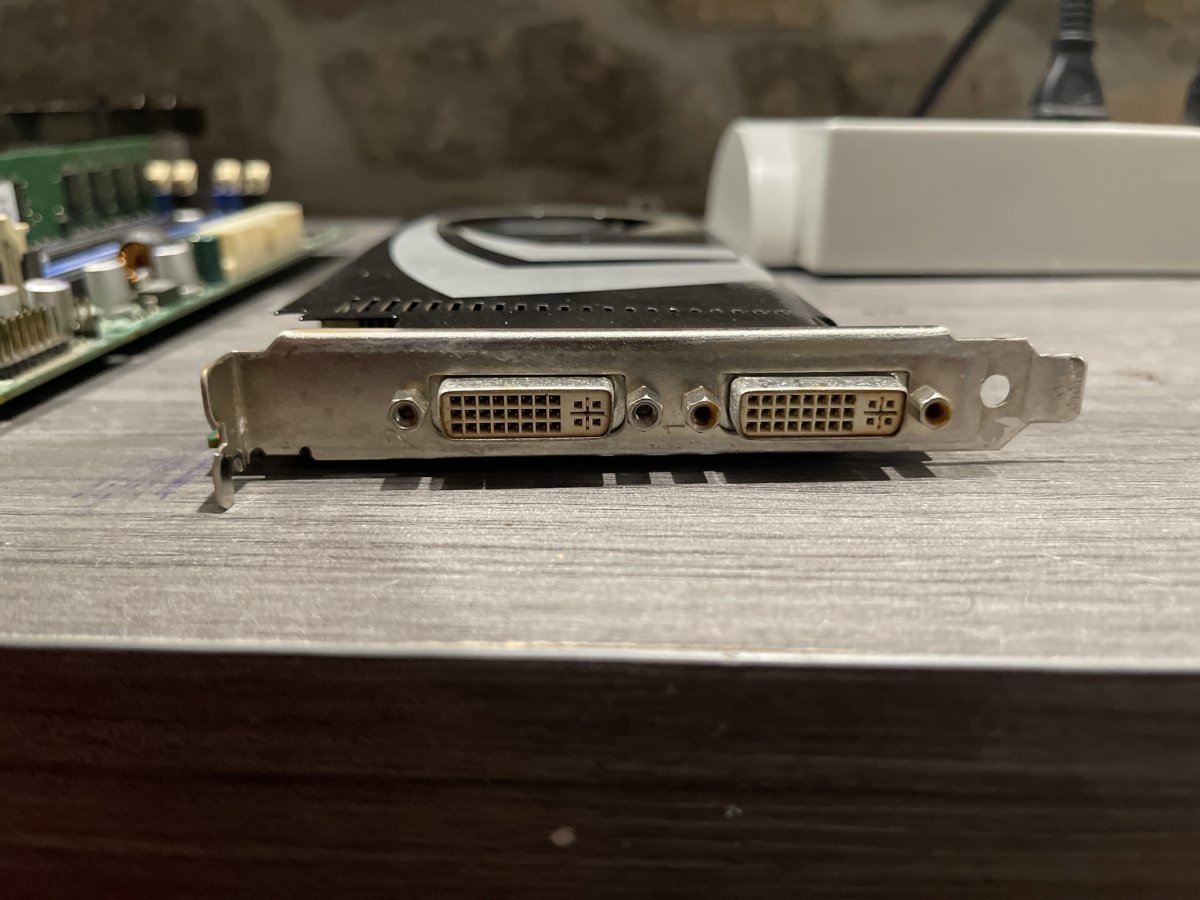

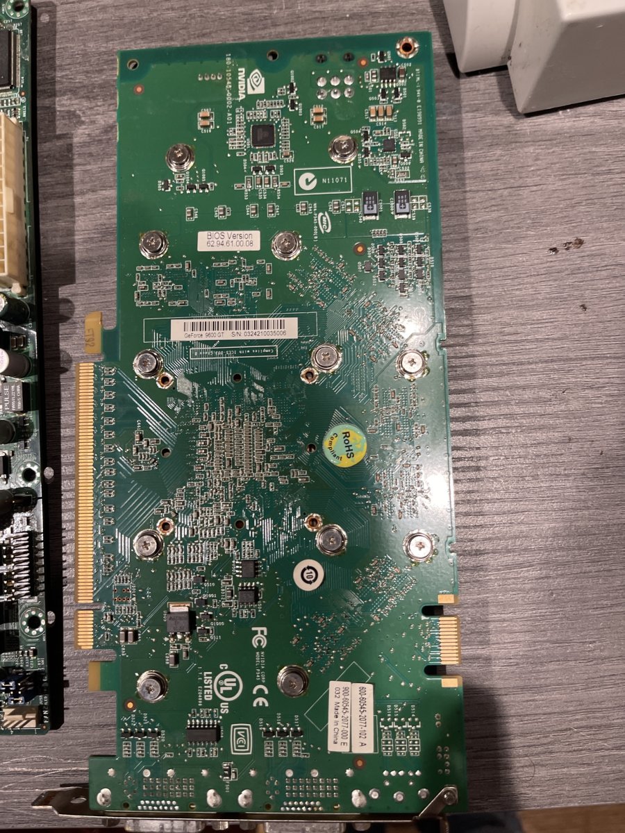

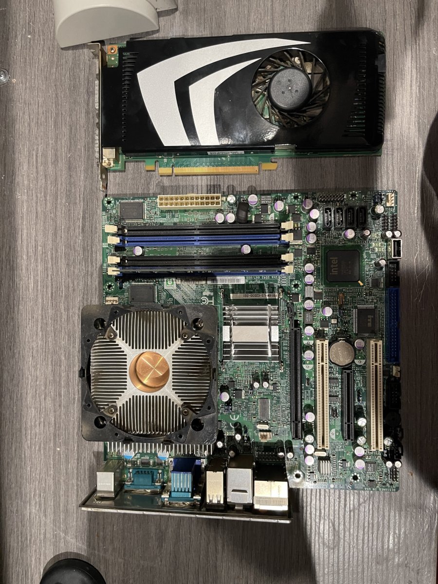

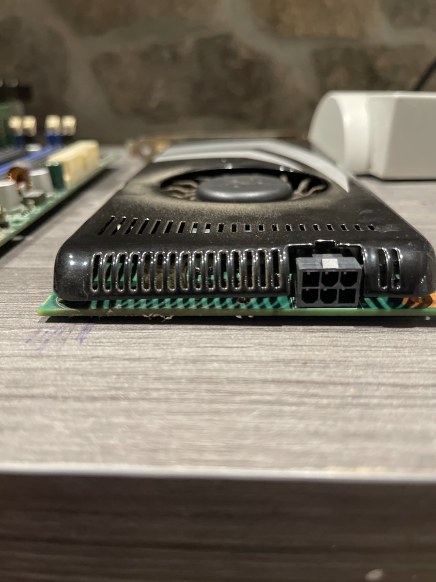

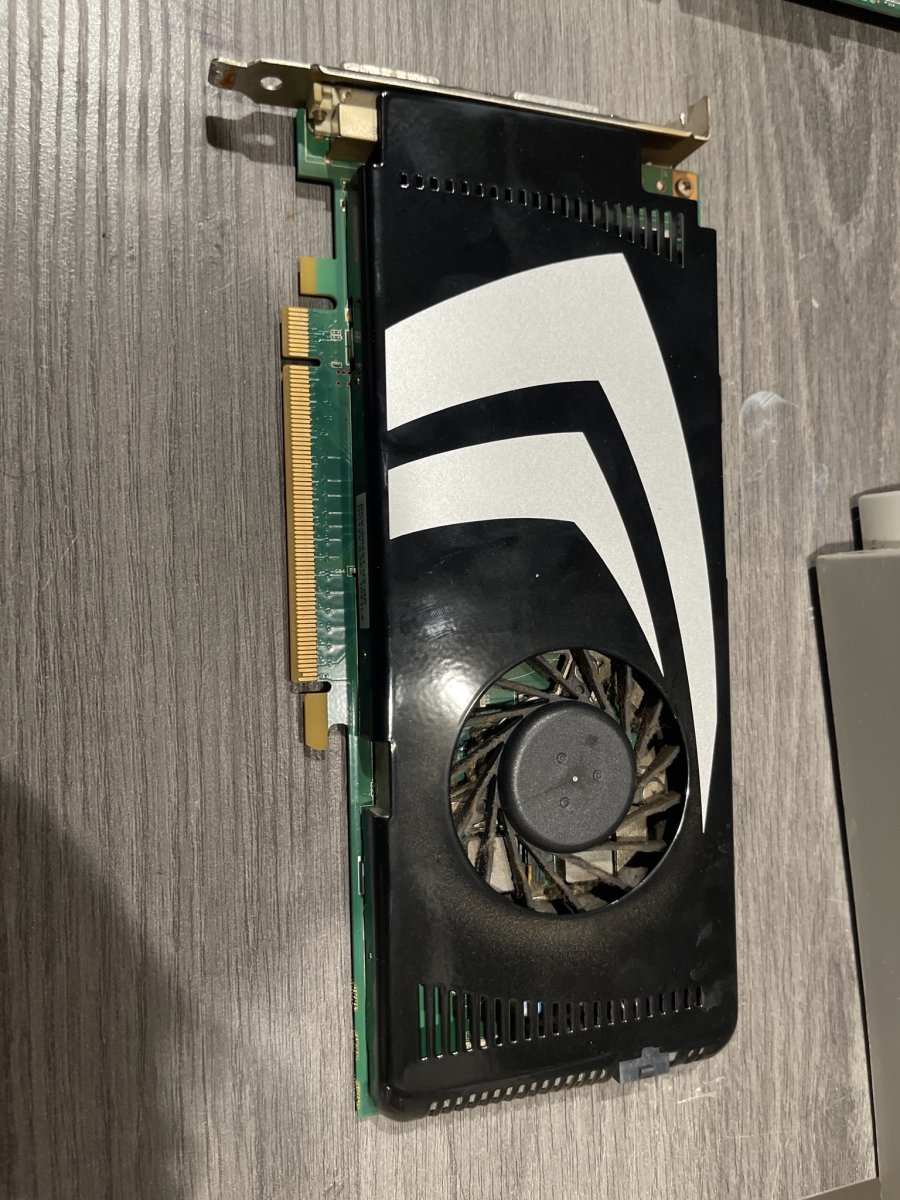

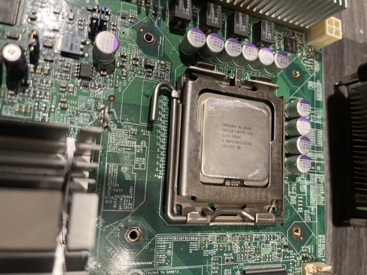

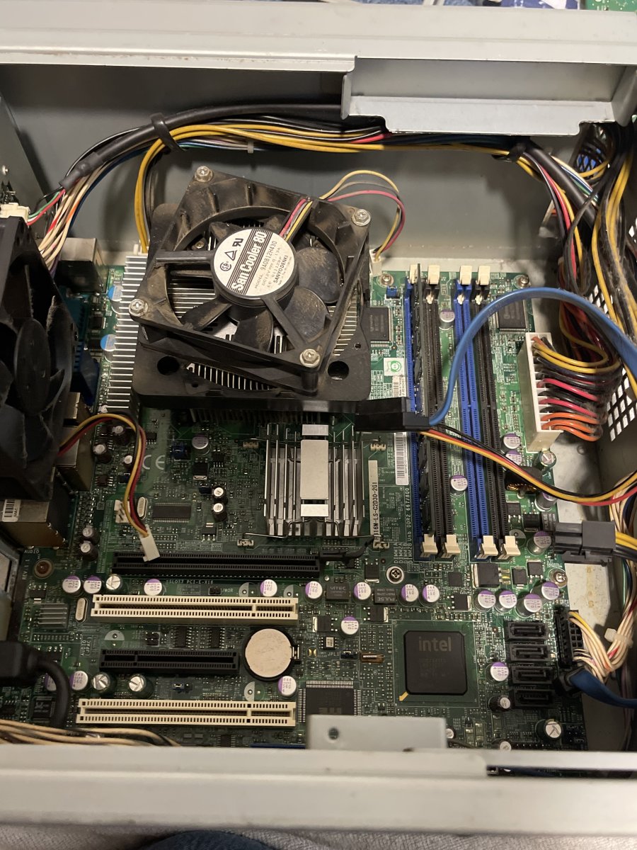

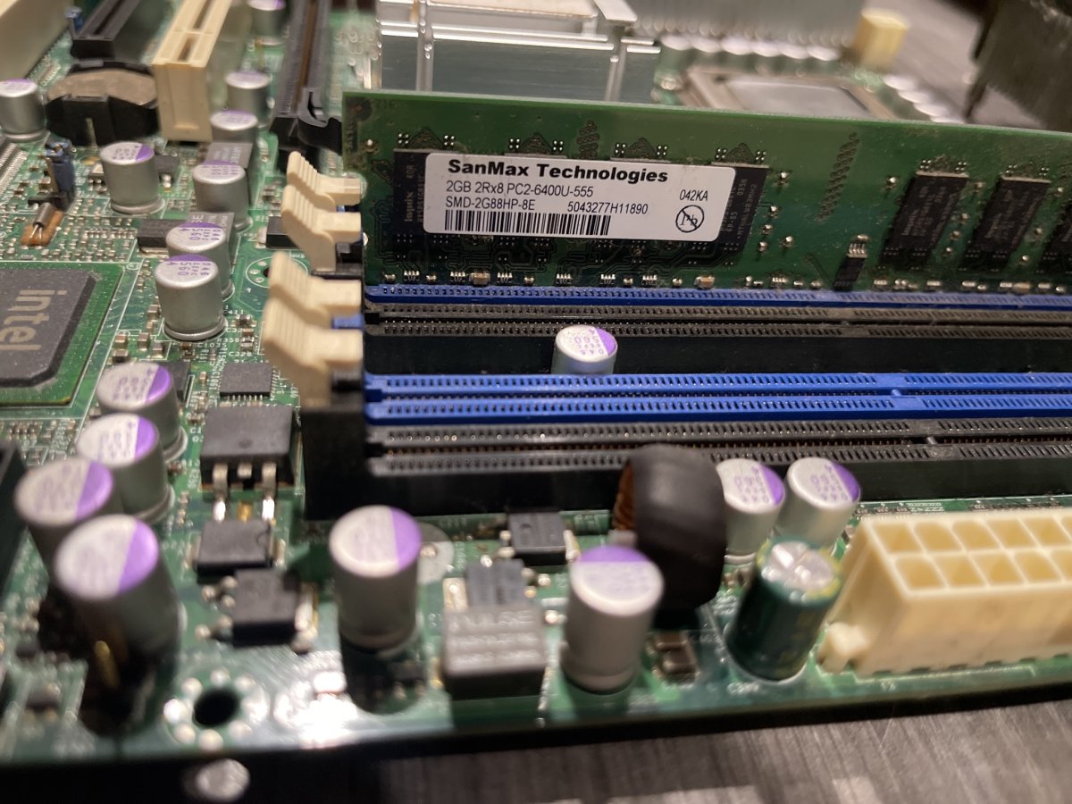

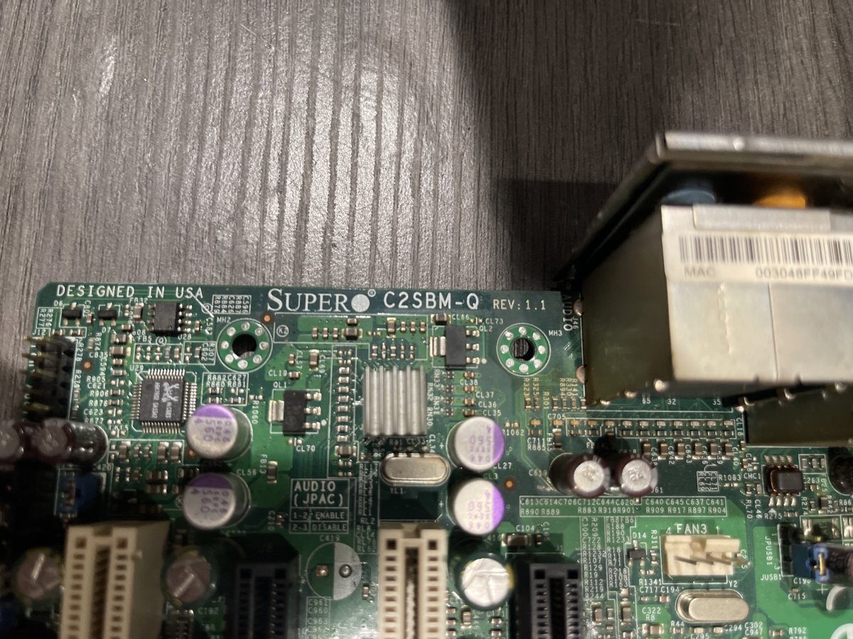

Yep, the ES1 came stock with a GeForce 9600 GT. I recently sold some parts taken out from a Namco System ES1 running a Gundam game. I really don’t know much about this system but what I do know with the ES3 is if you want to change parts/upgrade, you can’t as the system has TPM enabled in the BIOS and the system will fail to boot. TPM has to be disabled in the BIOS, I can’t say that’s true for the ES1 though as I haven’t messed with it a lot.

The ES1 uses TPM, but I’ve disabled it.
The game now uses a static hdd encryption key.
It came with Gundam on it, which boots fine. So the problem is only with dead heat. Trying to figure out what it needs.
