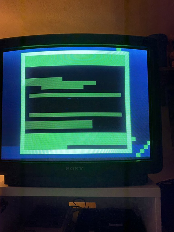

I have updated the menu but after that i faced several issues:
1) i tried to choose Alpha Mission 2, Andro Dunos and Magician Lord and when i pushed EXIT AND PROGRAM GAMES, it appears this flickering screen: https://i.postimg.cc/RVc8T9sb/IMG-3260-FILEminimizer.jpg and i have to reboot the console
2) I started Alpha Mission 2, then i pushed UP + START in order to retunr to the main menu, but again the console had issue, it appered this flickering screen: https://i.postimg.cc/V6rZ0c0g/IMG-3262-FILEminimizer.jpg and i had to reboot the console
3) Then i tried Andro Dunos, after some minutes i decided to change game and i pushed RIGHT + START, but again it appears a flickering screen: https://i.postimg.cc/QMP03nYT/IMG-3264-FILEminimizer.jpg
4) I tried again to retunr to the main menu pushing UP+START, but it appeared again a flickering screen like this: https://i.postimg.cc/qBQ66C0m/IMG-3263-FILEminimizer.jpg
I never had those issues with previous menu :( How can I solve?

Do you know how can i solve all these issues? I dind't have any issue with the previous menu version and it'about one year, year and half, that i don't tunr on the console.
unfortunately i don't have anymore the previous .zip file (20191122), can you share it please?
thanks
I tried with ne old one, but the issue is still present :(
I have additional issues: if i tunr on the console without any cart inside, pushing A+B+C in order to clean nVram, it does't happen anything, i have a white screen. And if i try to use an original cart (Kraut Busters), the game doesn't boot, i still have a white screen.
I don't know if all those issues are related each others...for sure everything worked perfectly but it is about more than one year that i don't turn on the console...

https://wiki.neogeodev.org/index.php?title=System_self-test console related error code are listed here.
White screen is not listed.
Also, Kraut Buster uses a special chip that needs extra power, just like the Datksoft cartridge.
Do you have enough power on your power supply ? How many amps ? Which voltage ? Original power supply or after market ?
Use an original cart and if it doesn't boot then the problem is your MVS. Probably some RAM gone bad or some capacitor.
yes i tried an original cart, Kraut Busters, and it doens't boot, white screen...
iok...i will send it to check and repair... in ordert to correcly update again the menu, is it better i delete sole files currently present on my sd card? I send you the picture above.

Kraut buster is not an original cart. It uses a special chip inside for encryption that sucks a lot of power. Use an original MVS game, a game released by SNK itself.
ah ok. In any case, it isn't normal that i have all those issues, i will send the consolized to check, as Kraut Busters too worked perfectly.
As stated above, might be a ram issue also, a bad trace somewhere leading to shortcut or bad contact… could be so many things
ok, i hope he will be able to fix it, i will send my consolized MVS to the guy who built it...

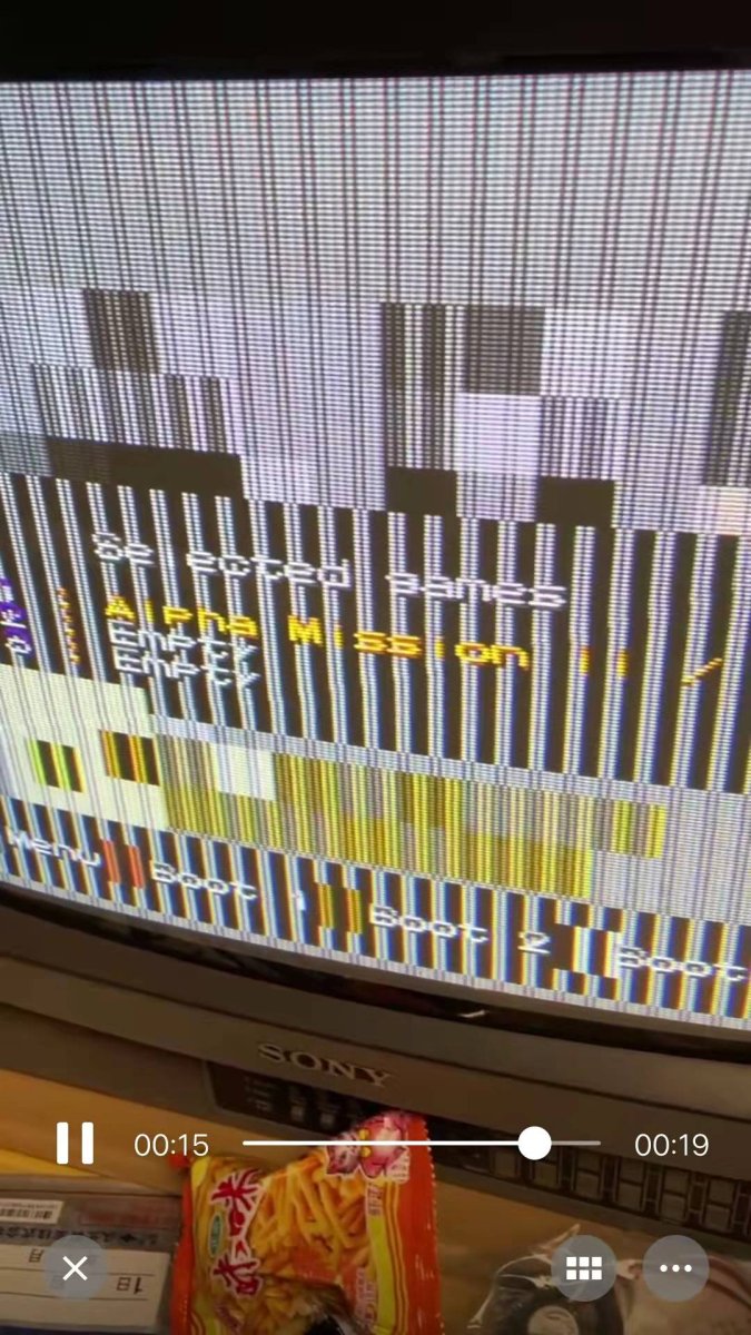

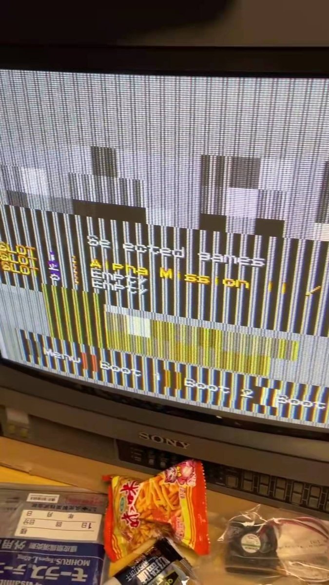

After a firmware update my friend's darksoft MVS cart is doing this:

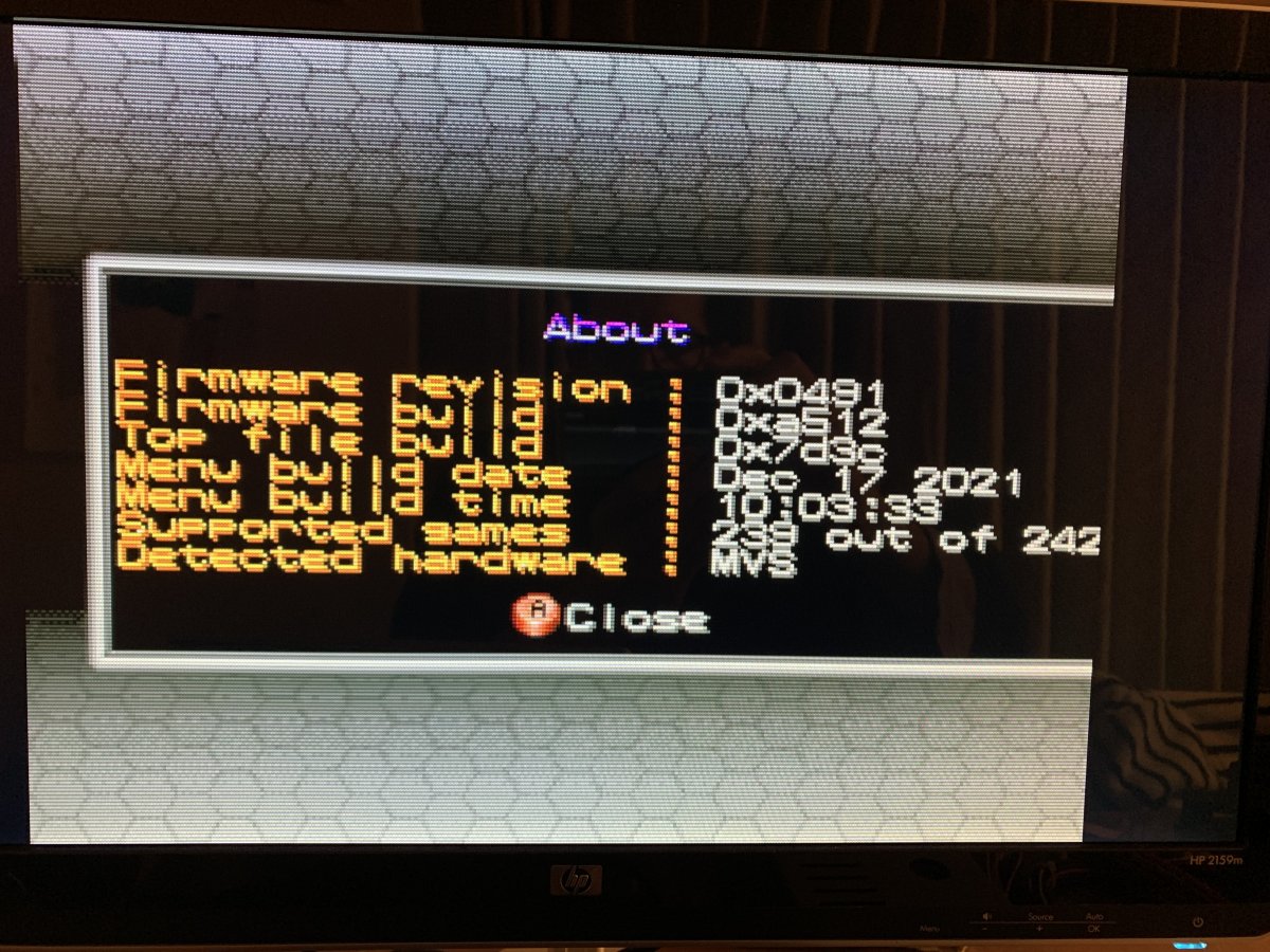

First of all, happy new year everyone.
I did the menu update keeping the same fw
I played 3h first on the slot 1, loading sometimes other games. Then I had a second and then a third game and I had a crash, black screen during loading. I switched off and on back on the menu the third game on slot 3 was not loaded. I then removed, from the sd card, the buffer and slot 1 and 2 from the PC, then I could load 3 games on the 3 slot. Is there any idea about the issue of the slot loading crash ? I guess it is nothing to deal with the menu. Does a reinstall of the fw can be an option to resolve the issue?
Thanks
