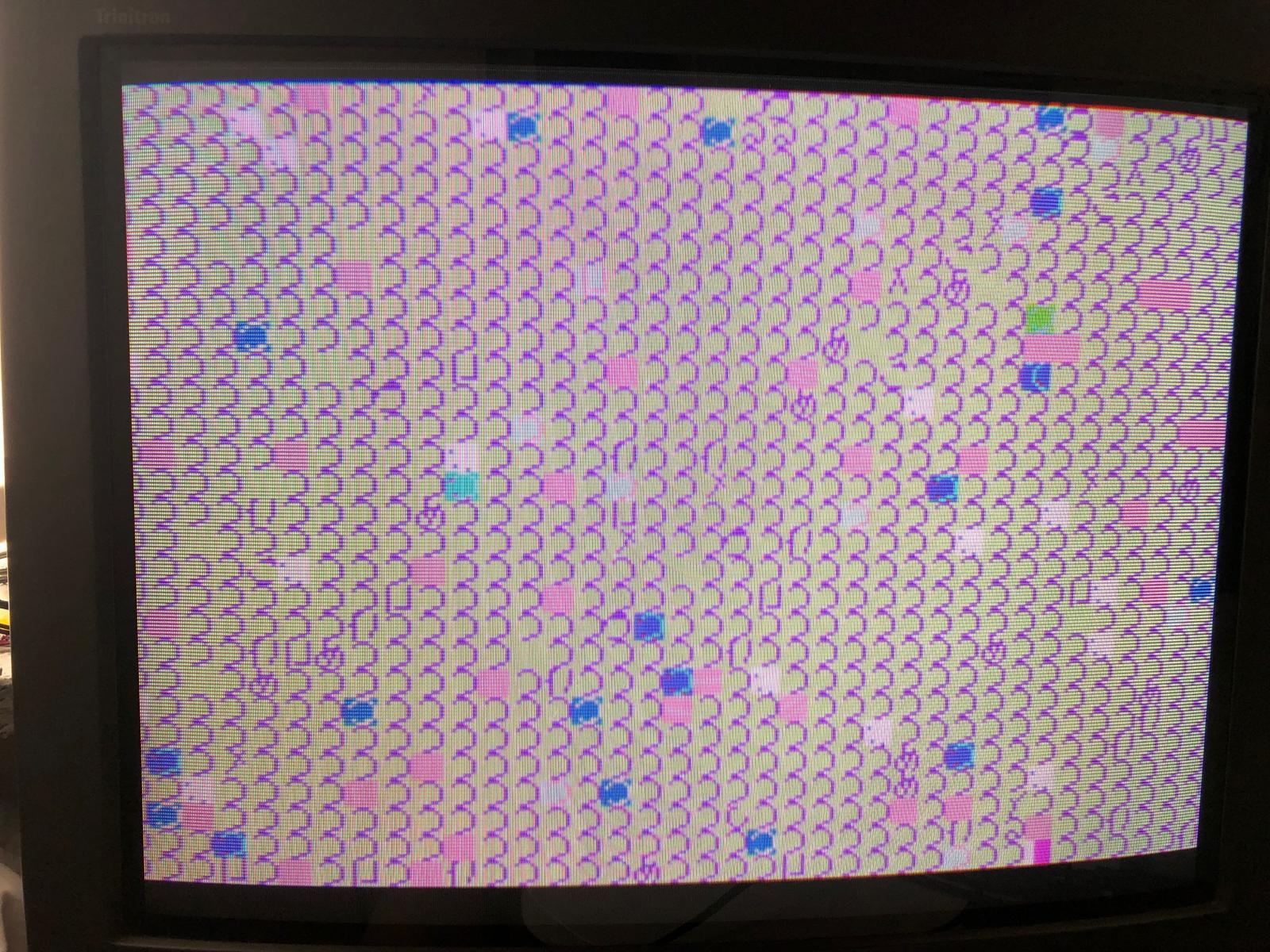

Not strictly cart related, but during game flashing it failed so I had to turn MVS off.
Then I updated the cart to latest fw (I was on the previous one still) and now it works on my other MVS, but the first MVS is stuck on pink screen on startup (see pic).
Power supply is ok, video cable is ok.
It happened a few months ago once, but then it got away, I think by itself, but now it is stuck.
Tried to remove from power outlet and power cycle the switch a few times, but no effect.
Any ideas?
Thx

What happens if you back to previous Firmware? is working still? in which MVS? Old or new?
Lastest firmware and proper MVS+supergun: everything works.
It's my CMVS (the one where flashing failed) that is stuck on pink screen with and without cart, so I don't think the cart is the problem, but maybe someone knows what it could be\how to unstuck. ^^'
Tried to "blind" clear NVRAM too, but no effect
I don't think it's stuck but rather failed on you.
I'm starting to think so too.
Tried to clean Backup RAM via deep switch, no result.
Is the the board to trash or is it fixable?
