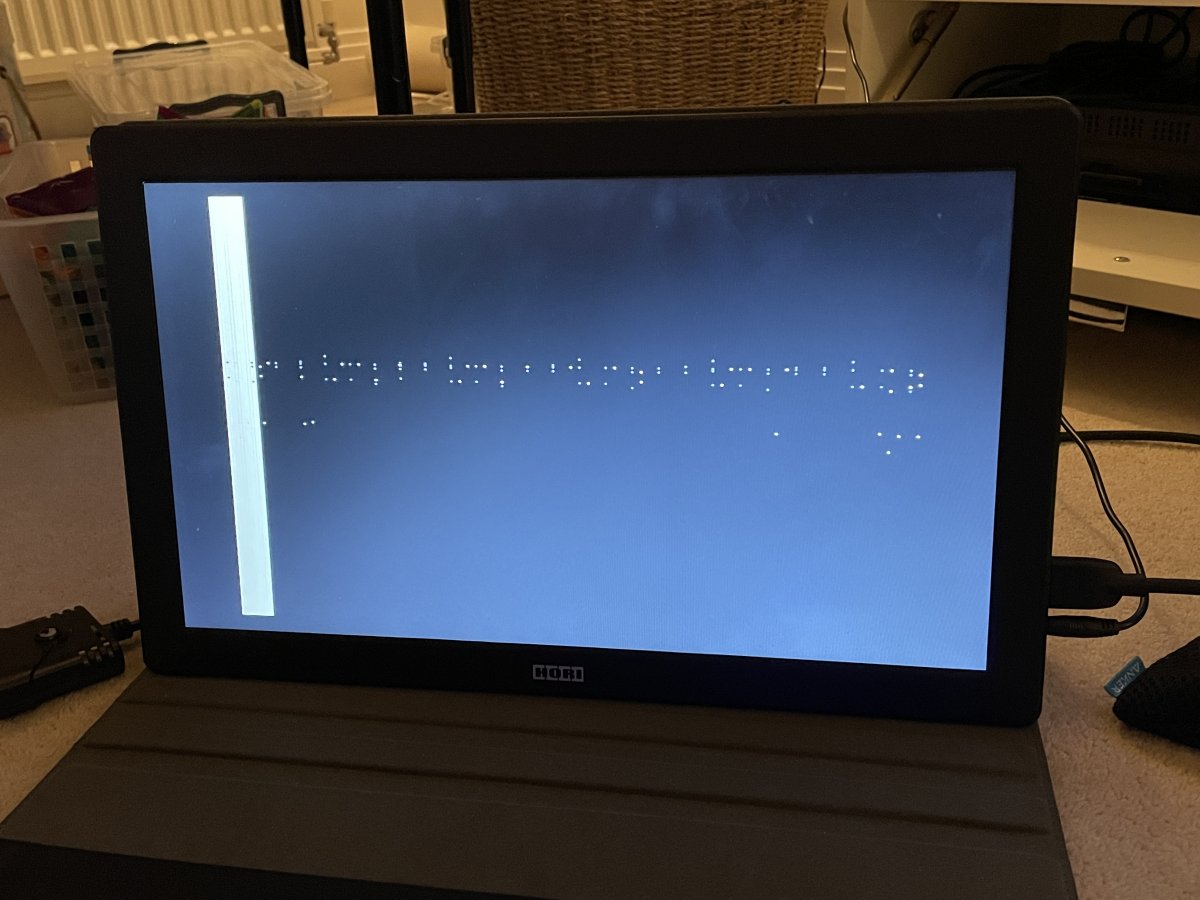

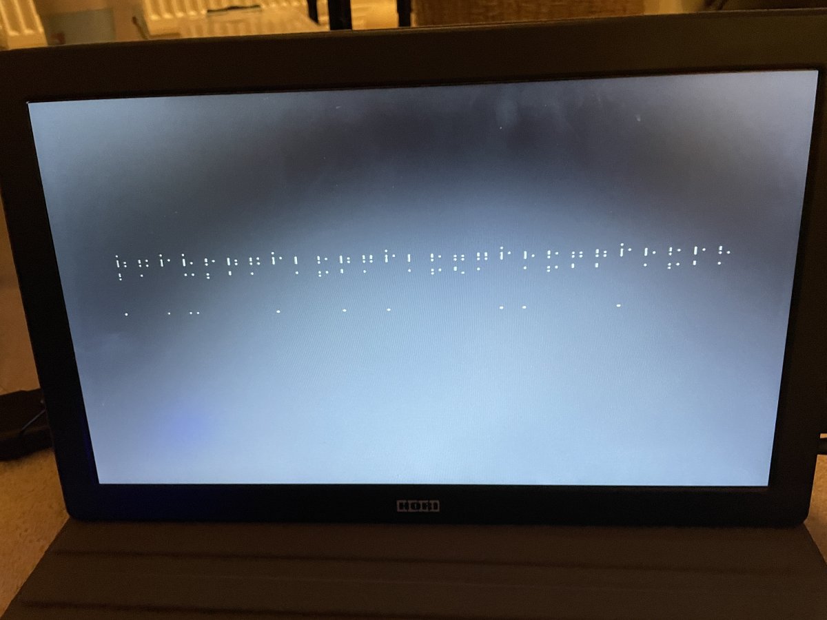

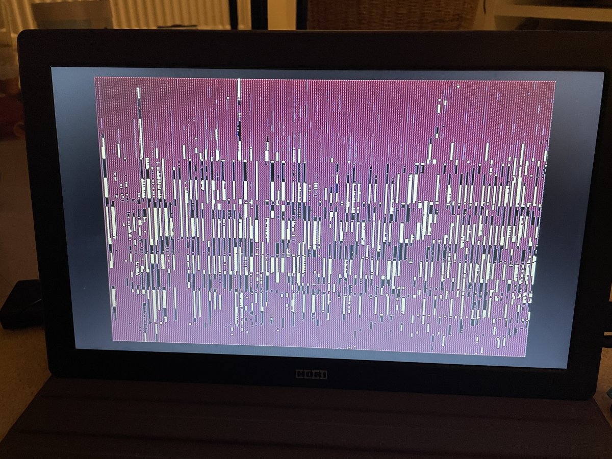

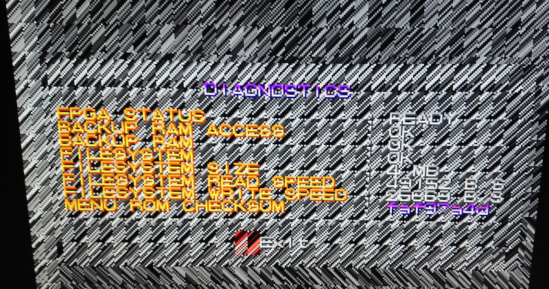

Hi,
Had the AES Multi Cart a while and it worked fine. Haven't given it loads of use, but it always worked fine. Very occasionally had to switch off and unplug to get working - but no other issues.
Just this weekend I got it out to play and it will not flash games at all.
It just sticks on a black screen indefinitely - with some white static. (pictures 1 and 5).
If I eventually turn it of and turn it on again the screen is a garbled mess. If I leave it approx. 10 minutes - it will switch back on but still not flash games to slots. (pictures 2 and 3).
I have tried it in 3 different AES consoles and had the same results (it use to work fine in all 3).
I have tried different firmware. Deleting the BUFF file and all the other advice I have managed to see on this forum with no luck.

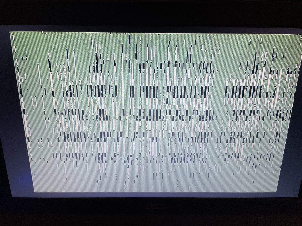

My Multi-MVS has corrupted graphics and garbled sound in menu (picture below), but games themselves seem to be working without issues. Any idea what could be
wrong? Tested so far only on MV-1C board.
Firmware revision: 0x0491
Firmware build: 0xa512
Top file build: 0x7d3c
Haven't updated anything yet.
That firmware is not the latest. Try updating it to the latest one.
The graphic errors in menu seem to be related to a problem reading from \games\menu
What are the contents of that folder?
Can you check your microsd in a PC with windows for a n error check?
Is the microsd SDHC type?
Thanks for the suggestions. Updating firmware and menu to latest ones listed in the dedicated thread (r1169 and 20191122) resolved the issue. Revision / build numbers shown in the menu did not change, though.
Glad to hear it works. If you experience some problem try to change that microsd.
