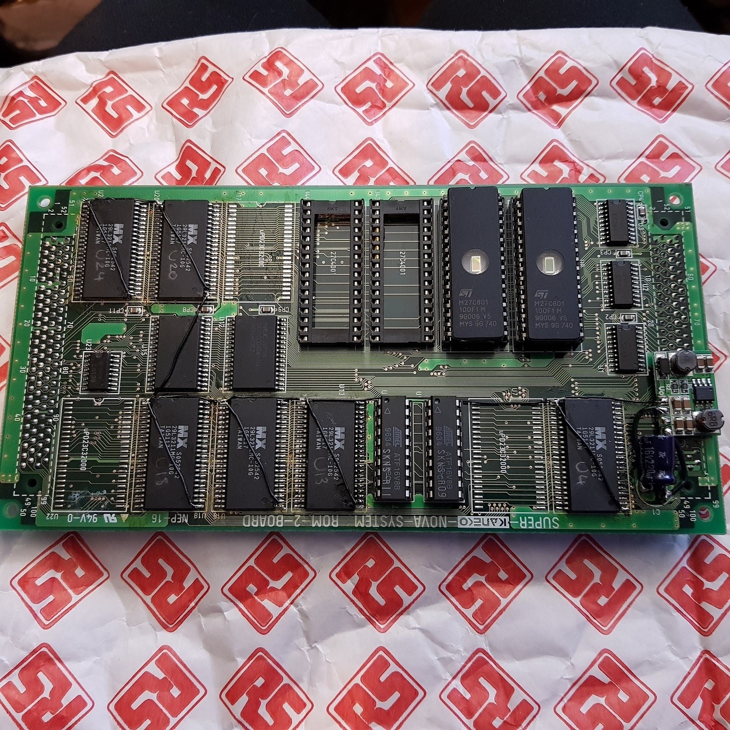

Hey guys,
I've attempted to convert Jan Jan Paradise to Cyvern but I can't seem to get it to boot properly. My mainboard is Asia region and came stock with Japanese Bios but I've fitted a Japanese Mobios.
If I boot without the Eproms installed the splash screen is in the correct vertical orientation and freezes on the Kaneko Super Nova logo but as soon as I try to boot with the Eproms in, the splash screen displays in horizontal orientation and also freezes on the same logo.
I've tried with and without the decoupling capacitors on each SOP44 chip and that doesn't make a difference.
I'm guessing it has something to do with programming the M27C801 Eproms but I'm very much a noob when it comes to the technical side of things.
If anyone could spread some light on the situation that would be awesome! :)

Surely someone most have a rough idea this isn't working ;)
have you not programmed these?!
Of course I programmed them :) . Tried various different Eproms and it's always the same outcome. Like I said, I'm very much a noob when it comes to the technical side of things.
It seems like such a straight forward conversion so I'm a bit perplexed as to why I can't get it boot.
I don't know that it is. There was a lot of assumptions that the ROMs AMB was using for the games had been patched. Apocalypse above seemed to imply that might not be the case, but I don't believe we've had a hard confirmation either way.
There are also two PALs on these carts and it's unclear if those need to be changed as well.

The roms definitely could have been patched but @pacman70 did state that all he needed was the modbios to make it work.
I attached a picture of a legit Cyvern cart and the Pals are identical to Jan Jan Paradise.
