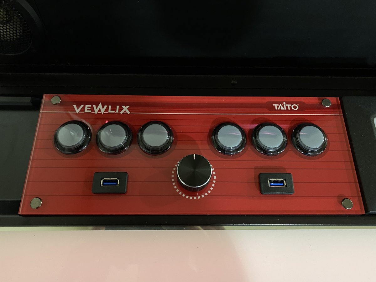

I wanted to report back that OCD got the best of me and I tried out this one: https://www.amazon.com/gp/product/B00XDKKQ9E/ref=ox_sc_act_title_2?smid=A1815B191TKQXZ&psc=1
I had to de-case and also widen the hole so the nut would fit (widened a little on the top side only enough to get the nut to sit in. I'm happier with this over the original solution since it's substantially smaller both with and without the case and of course it doesn't require adapters for the 3.5mm (e.g., if you have a Vewlix). I had to order some longer 3.5mm audio cables which I'm waiting on now and a second volume controller for my second Vewlix.
Also, I didn't want to mount the sub-panel with any screws showing so I went with these: https://www.amazon.com/gp/product/B07DNM7KXG/ref=ppx_yo_dt_b_asin_title_o06_s00?ie=UTF8&psc=1
The M5x6mm were perfect! The top now doesn't have any screws and is flat/low profile. Also the black is nice. The only thing I want to add are some logos inside the buttons for Touchpad/Home/Start (or maybe I'll keep it clean, not sure yet).

Paik4Life, I am interested in trying out your alternate solution, and love your setup, especially with how clean it looks and due to the fact that I also have a red cab. Do you have any extra flat bolts to sell?
I am a complete novice here, but would anyone mind explaining how to physically connect this setup to be able to the original cab audio components itself? Also, how does the volume controller stay attached? Is there something connecting it to the bottom of the custom panel, is the grommet holding everything up, or is the knob itself carrying the weight?
Thanks in advance for any help!
Hi All, I bought my first Taito Vewlix F cab recently, and in searching for custom panel solutions, found this amazing thread. Thank you all for doing some amazing work to improve the quality of the cab and make the usability much better. Special thanks to jermz1 for being willing to get me one of these custom panels extremely late in the game.
Yeah hit me up for a set of screws.
The volume controller has a nut that you use to mount to the sub panel. The reason I went with the one I linked for my cab is that it uses 3.5mm audio jack which is stock for Vewlix. So you would need to use an HDMI audio extractor that outputs 3.5mm, that would lease to the input of the volume controller and then output would go to the Vewlix amp.
Hope that helps.
