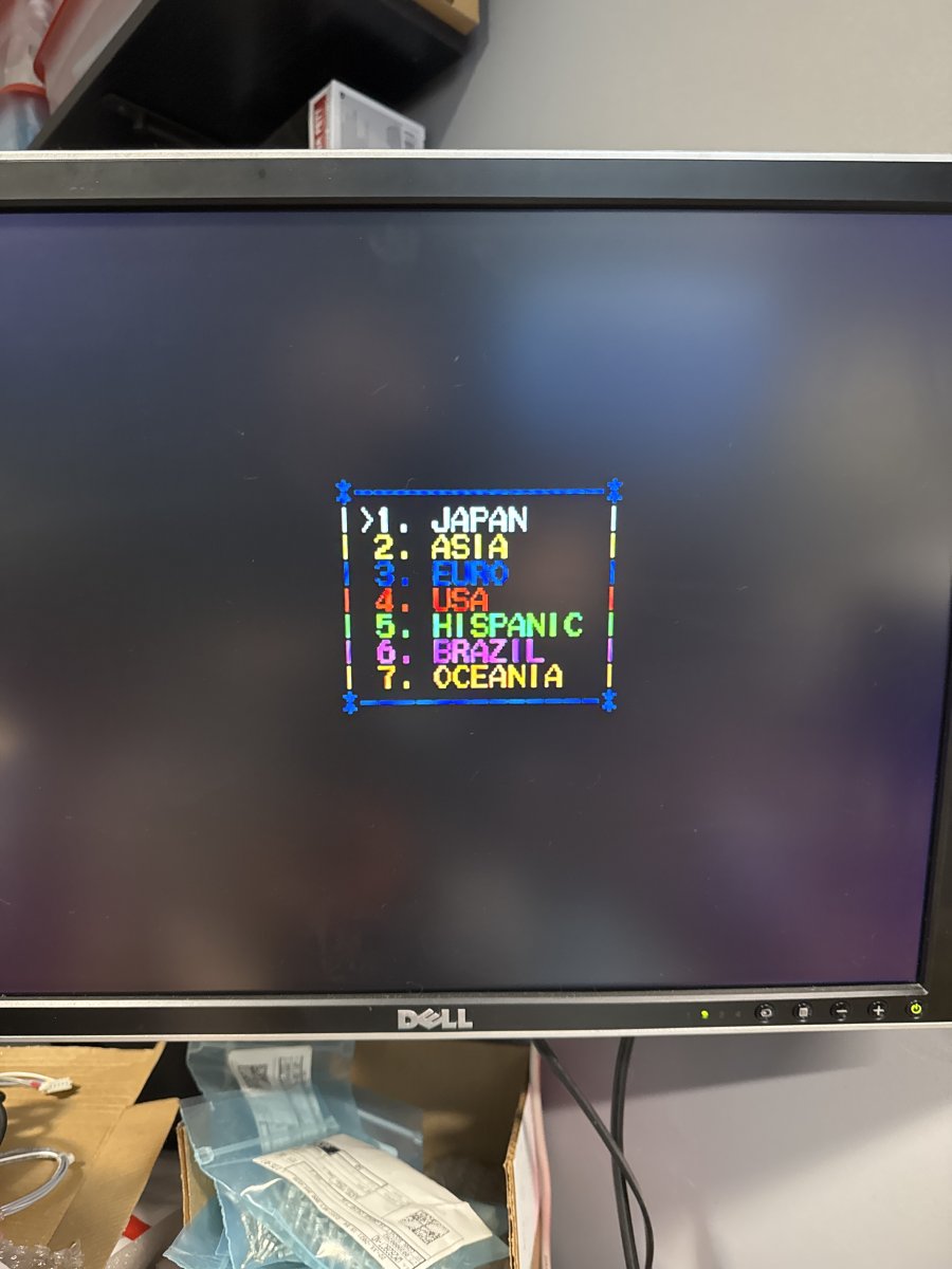

9C looks like it is working fine
I finally found loose pins on the PPU - quite a few are loose
What is the best way to re-fasten the pins to the board? I do not feel comfortable using my soldering iron

About 60 pins were loose
Soldered the pins back down and voila
Looks much better
Now I can program my Darksoft simms I just got :)

Did you probe each pin with a pick or something to ensure everything is solidly connected to its corresponding pad?
Looking at the way the colors are all messed up in the color bars, seems like it could be the PPU, not likely to be the DAC or related components. Maybe it's something related to video memory? I am totally spitballing here.
Can you boot a game? What happens if you do?
Yes I checked each pin with a needle to see if it moved - all of them seem connected now
I can boot a game and I can see some moving stuff on the screen but cannot make it out
I also have no sound either :(
Here is a video of booting up dip switch 000 game
