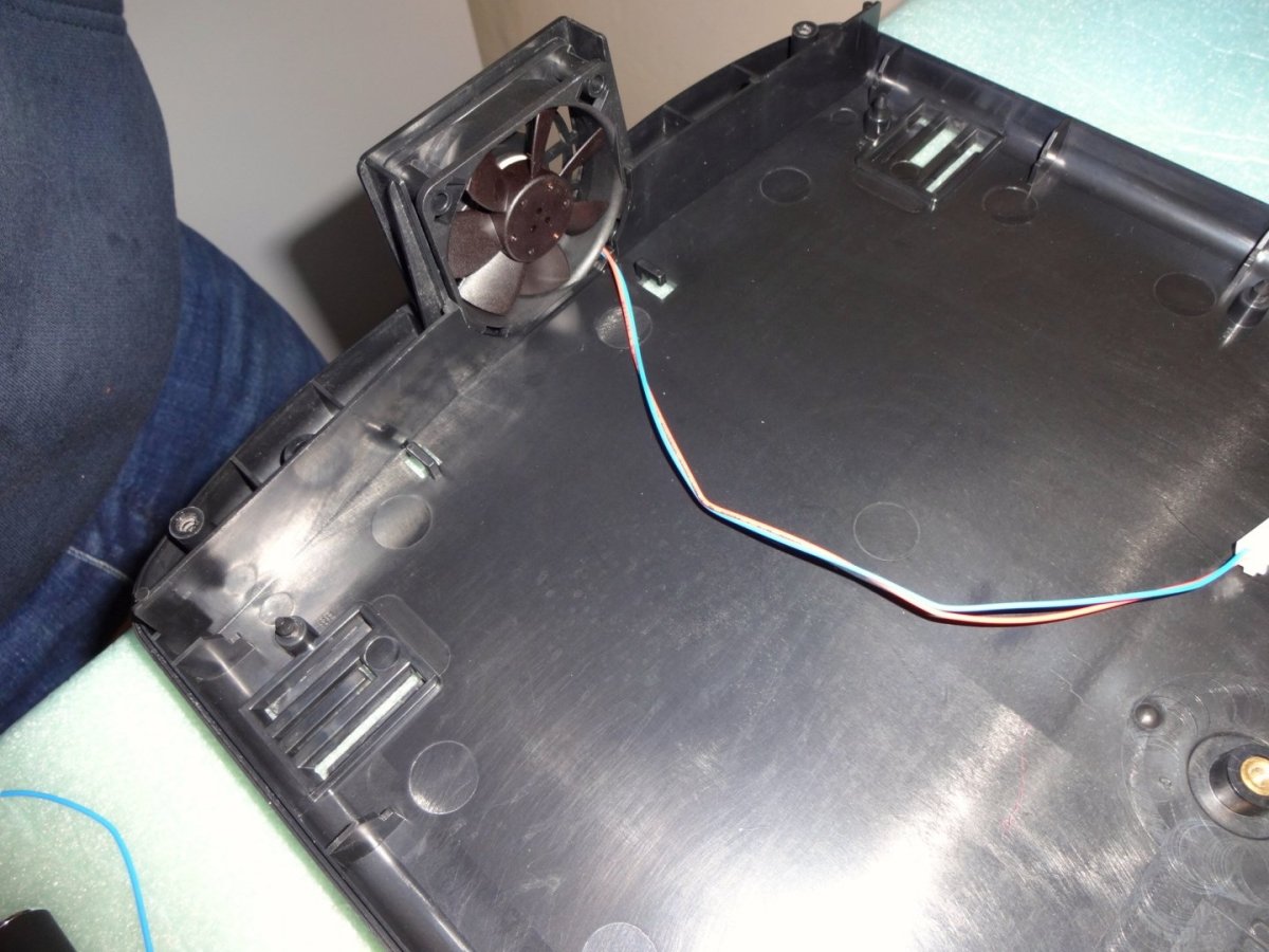

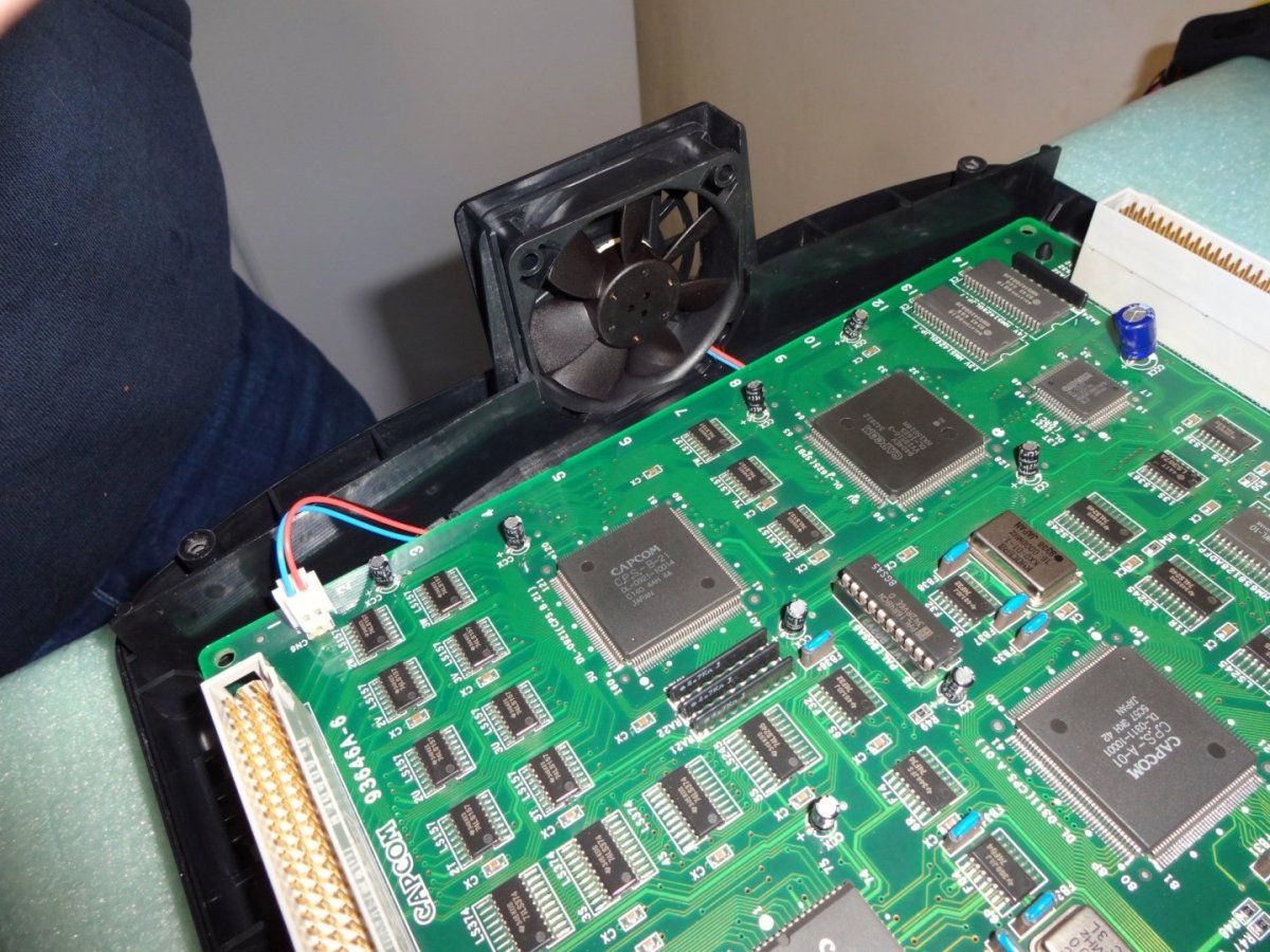

Looks to be the exact same spec of the one I stuck in my AVP board a few years back, zero modification at all, just plug in the new fan and slot it in where the old fan went.

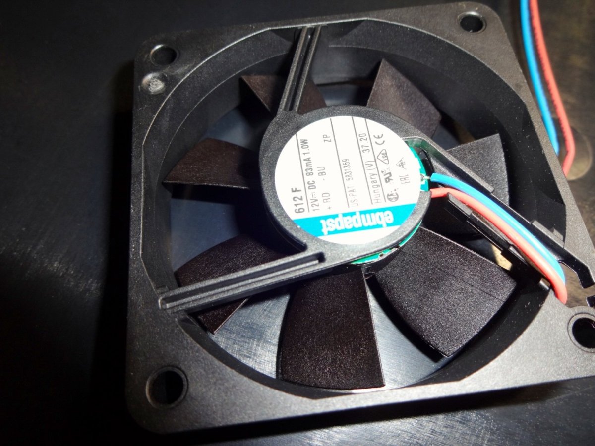

I use a Papst 612F fan on all my Cps2s they fit spot on and are the same measurements as the original plus very quiet I can hardly hear it in the Big Blue they push out a fair amount of air too, all I did was change over the connection to one that's fits the A board and job done.
