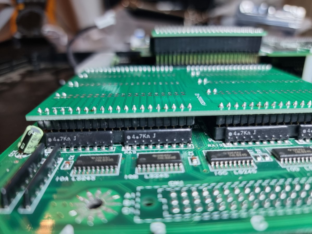

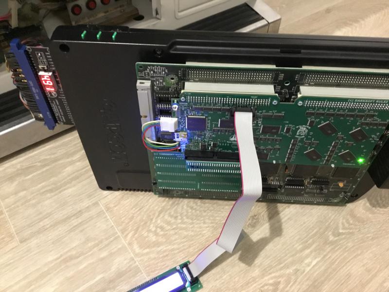

Hi I recently purchased the multi kit and installed it. I'm having some issues unfortunately. So I installed the kit and I was either getting a white blank or a test screen which I'll post. What screen I got depended on what rom I loaded. So I've read that sd cards can be a problem (the original sd card I used was supplied with the kit) so I tried another but the lcd said no sd card found. I then tried booting it with no sd card and last rom I loaded started straight away with the only problem being no sound, after a while the lcd didn't display anything. I read that you can swap between the rca out or the jamma harness by holding the up and down volume button on boot up which I did, it made a strange beeping sound and nothing loaded. Now reverting back to the original sd card the lcd still displays nothing. I've tried reseating the kit formatting the sd card and shorting the capacitor that holds the key with no change. If you could steer me in the right direction that would be greatly appreciated cheers
It looks to me like a problem with a bad contact. Are A+B PCBs seating properly? What about the small PCB of the kit that goes where the Program Roms are located? Does it sit properly?
Can you show us a picture where we can see your PCB and the installation? Have you followed the instructions and troubleshooting tips? Like ie using the Verify romset or to try first games without key writing cables, etc.?
Pretty sure a a and b are seating properly, I've tried with and without the b board housing. All the kit pcbs look to be seated well I'll post some pics. I just reseated again and I also formatted the sd card and loaded the test files. Unfortunately there is no change no text on the lcd.

Ok so the lcd works it was just the contrast pot, silly me. Where can I find the decrypted rom pack. I'm currently using the roll up base pack. Edit: just ran the two test roms and both said "all done have fun".
Great news! To me it looks like the small interconecct PCB is not inserted properly on the side of the Multi PCB. Can you check that? What happens if you remove the key writting cables and try to load a game where the file key in the game folder is full of 0xFFFFFFFF
Sorry for delayed reply. I tried reseating a couple of more times. Not sure what is going on now but when you press load game it either takes a while before it starts writing or doesn't start at all, it also seems like the voltage is fluctuating more than before. I downloaded the legacy rom pack and have tried both sets with and without the keywriting wires connected.
Your picture 20210427_194006.jpg. Can you pull from the multi PCB up a bit towards the interconnect PCB. Are you sure that they make proper contact?
Are you using the key injection cable? Which model is your B Board? -3 or -4 ? Can you try romsets that have the key 0xFFFFFFF WITHOUT the cable attached? Does it work now?
