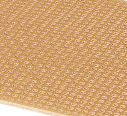

Any electronics course that involves soldering will always teach you to solder/desolder on junk electronic pcbs. Best way to get a feel for it on how/what works best for you.
Pick up some junk boards from your electronics recycling/dump, just harvest some pcb from there.
If you dont have any junk boards then get a perf board like this:
Get some inexpensive soldering gear and supplies. I prefer leaded solder, whatever you get, get some good no clean flux also
Good luck, you can do this yourself man, go for it.
