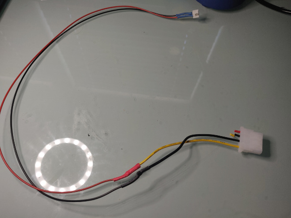

Utilize the 12v and ground on the molex connector if you’re not using disc drive.How do I hook up the light? Can I see a picture of how it's properly done?
Thanks for the infoUtilize the 12v and ground on the molex connector if you’re not using disc drive.

First I soldered a molex power connector to the other end of the power wires for the LED:

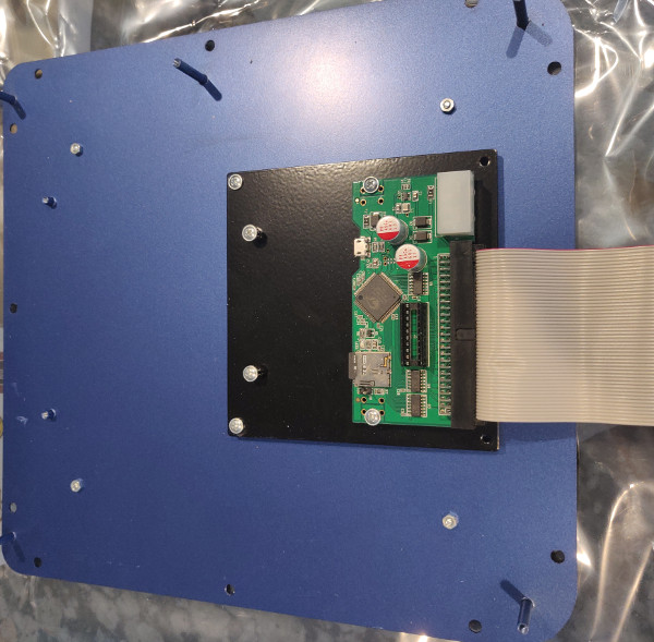

This way nothing has to be soldered onto the CPS3 board while assembling and it can plug right into the motherboard (since the SCSI2SD doesn't need power via molex and can run straight from SCSI cable alone).
Next I moved the mounting board for the SCSI2SD towards the back of the case. This was required to work with my short SCSI cable which I've been using with my previous plexi setup.
It works fine and mounts perfectly with the older SCSI2SD revision!

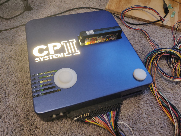

All put together:
It's fantastic! I really like how it can optionally mount in cabinets too, as that's where this will be spending the majority of its time.
red like one Ferrari of course I like.@nonosto Made sure to house your build in a proper chassis. You like?
