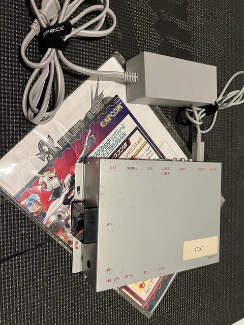

Tried this out with a Wii. I wanted to see if I could create a “dedicated” Tatsunoko vs Capcom kit that works with JAMMA. Thought it’d be fun since the arcade version of TvC basically ran on modified Wii hardware:

Anyway, just for fun, and to see if it worked with some random parts I had. Would ideally need to clean up the wiring; maybe get a PAL Wii so I don’t have to use a SCART converter. To be fair, although the original arcade hardware was also small, it’s wiring also gets a bit messy since it needs an IO and power supply too.
