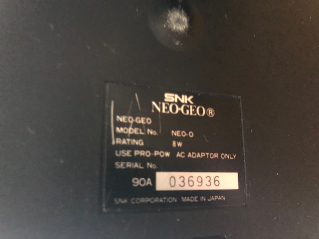

Hello,
I'm looking to buy a backup PSU for my AES system.
It seems the model should be a PRO-POW. However there are multiple types (UL/PAL..).
Is there any differences? (I assume that depending my current region I have to go with PRO-POW-PAL.
Moreover all model NEO-O are JAP (I thought mine was EUR before checking in details).
Thanks.
P.S : I attached photos for more details.

Seconding retrogamesupply...
Also, I have experienced 2 AES PSUs blowing up due to leaking capacitors.
Ditch them or recap them.
You should open it and look inside, the label maybe wrong or the AES might have a factory update. See the link at the top to understand. I wouldn't buy a PSU until you see what you actually have internally.

It's recommended before buying a AES PSU, regardless of what the bottom of your console says, that you actually open it up and take a look inside (as recommended in FirebrandX's guide).
Recently I had an issue where I bought a replacement PSU (5v/3A) for a "POW2" console, only to realise that my AES had some strange "NEO-POW2" PSU rated at 11V/700mA that isn't documented anywhere online (it does exist, I own the original PSU). The "PRO"-POW2 and "NEO"-POW2 are two entirely different supplies, so it turns out. Thankfully the seller realised his recommended PSU replacement guide on his site was incomplete and sent me a replacement 9V/2A PSU that works perfectly now.

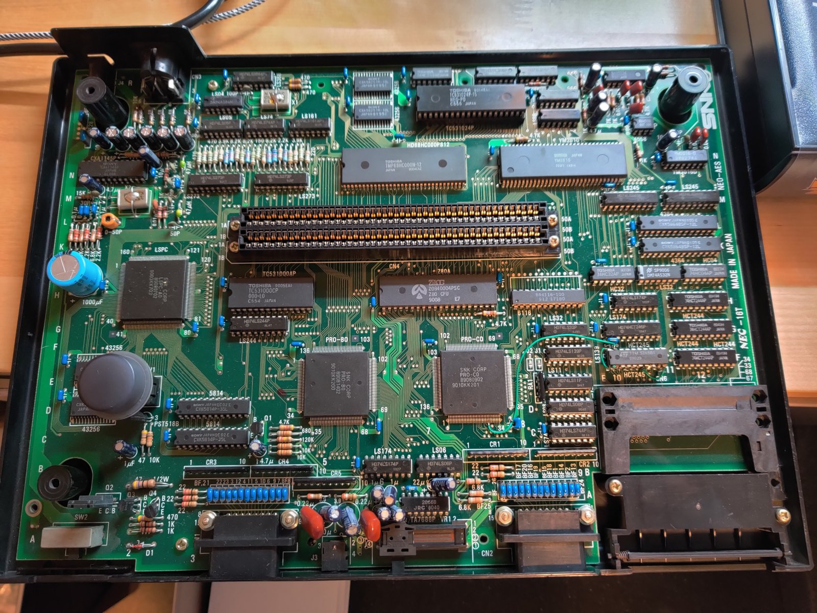

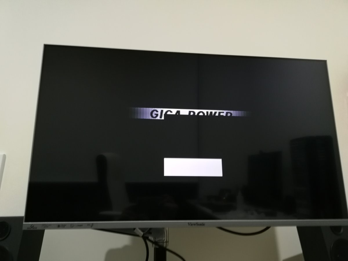

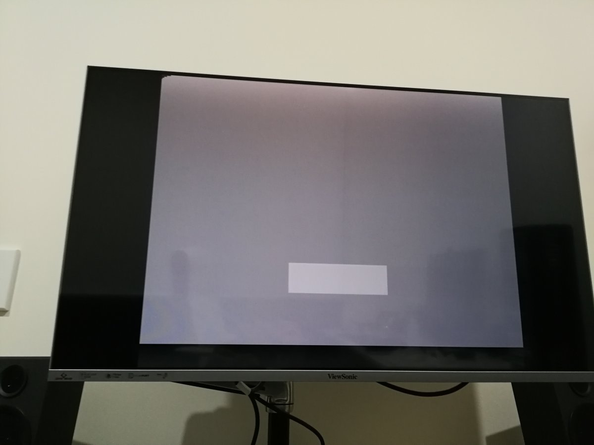

Hi all!
Hope you are doing well. I recently got an AES which worked fine the very first day I got it and then it gave up on me, I'm using a Triad WSX050-4000-R as suggested by firebrandx but there seems to be something wrong with the voltage inside the console. Here's my readings:
Power on (no cart inserted):
  • The Triad WSX050-4000-R outputs 5.14v
  • The 5.14v from the power supply reach the left leg of the switch when it's open
  • After powering the boards, I'm measuring 4.91 to 4.93v coming out of the switch and into the transistor.
  • The center leg of the transistor is measuring 4.86 to 4.88v, got same results when measuring the big 1000uf cap that follows the transistor.
  • The Z80 is receiving 4.83v which, I believe, might be a bit low?
Power on (cart present):
  • Voltage on the power jack goes down to 4.93v.
  • 4.73v coming out of the power transistor that follows the power switch.
  • 4.72 reaching the Z80.
I understand that going lower than 4.9 might cause issues and resets. What I'm getting is a glitchy bootup screen and then the console resets after around 15 seconds or so.
So, I'm trying to understand if this is an issue with the Triad power supply, the power circuit on my AES or anything else. Have you had a similar issue with a Triad PSU?
I've attached a picture of the early model board I have.
Thanks!

As you have your AED open., check what the 5V look like in any of the chips. That should be your reference.
Thanks Darksoft, I measured 4.72 reaching the Z80 when the NeoSD pro is inserted. My understanding is that going under 4.9v = trouble but I wonder whether anyone here have succeeded in using a NeoSD pro with a Triad 5V 4A?
Thanks.
