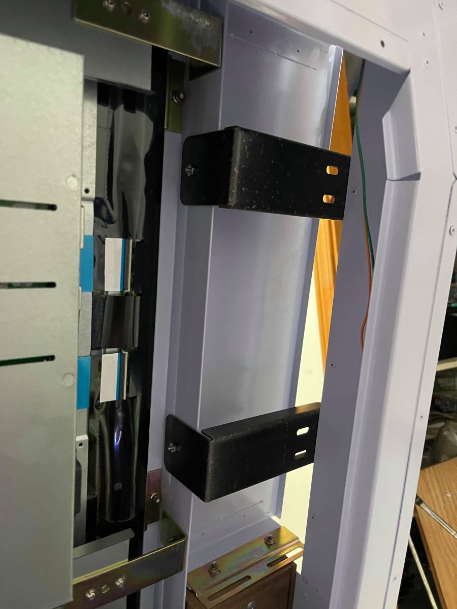

If anyone is interested i’ve found an alibaba seller that sells vertical brackets. I will post some shots when i’ll receive mine 😅
All right: I've been receiving a few messages for another run and I figured... wait, why don't I do this and save myself a lot of trouble of all of you a lot of shipping $:
so before I make it "officially public", can someone in need of them please download, print and install them and let me know if it's all ok ?!
thanks and enjoy! :)

Did anyone ever test these? I am about to print some out, friend of mine is selling me his chewlix, looks like the same one you have in the OP. Any advice I should be aware of for that model :)
Not that I know of !
Thanks for trying and be careful / print @100%
Yeah I am doing 100% PTEG right now, I cant imagine a monitor would be too much for these when there are 4 of them.
Well the 3D printed work, but don't work :O They fit, the screwed in and they are currently holding up my monitor but there's a tiny bit of flex in the material so the monitor isn't flush at the very top, the weight pushes it back a little bit maybe half an inch. Good try though, I can use them in the mean time :) Did have a question though, this being my first chewlix, when you moved the panels from the top to the sides, do they screw in? My screw holes didn't line up when I put them on each side of the monitor.
EDIT: The panel is this one in your pic, bottom right, it doesnt look like your screws holes lined up either?

Would be easy to re-do the models so they don't flex.
Yeah and you could also maybe use PLA since it is a stiffer material, I didn't use it though because when it does break it tends to be more catastrophic haha.

Well bummer :( Thanks for trying it.
… and i dont really remember about the lining up ! Sorry man
Thanks for posting them, they are at least allowing me to use vert mode until I can track some metal ones down :) Also, random note, i have the same exact color vewlix sitting beside a blast city....twinsies!
