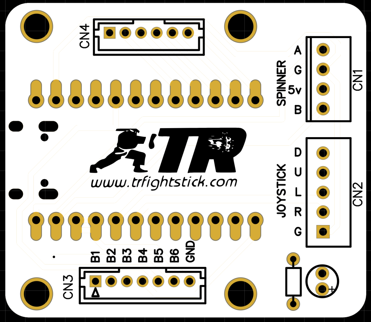

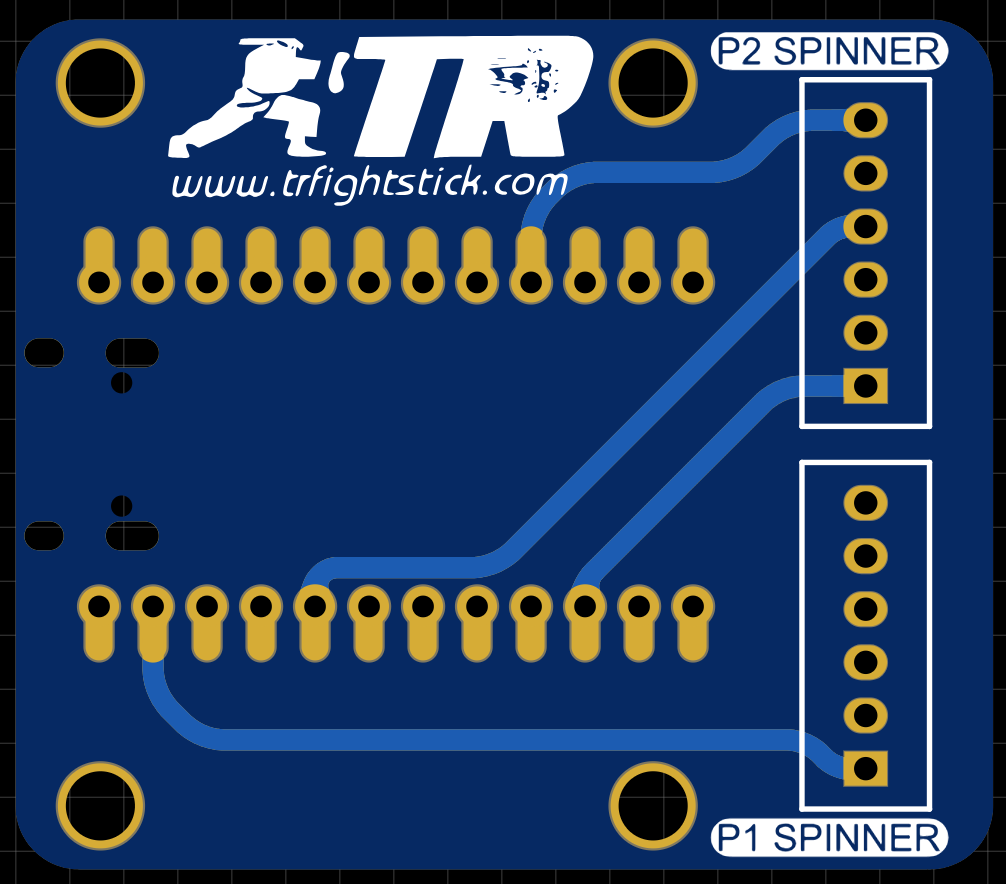

And for those interested in MisterFPGA support, Im testing a little board I made up
Desing will probably change, but this should get the testing out of the way to confirm things work.

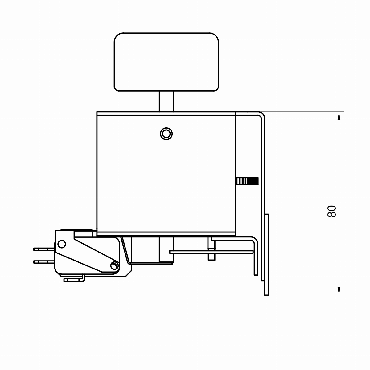

I don't believe anyone has measured the control panel depth on an E29 or Impress, you might start by measuring the distance from the bottom of the control panel to the bottom of the housing when fully closed (take the joystick out close it back up then use a ruler or calipers to measure the depth) best to do it for both P1 and P2 incase there are features inside the control panel that could cause problems. you might also want to measure the bolt distances for the joystick mount to ensure that it will work with the spinner also.
As for CPS1 and CPS2 neither technically support spinners, HOWEVER if you have an original Lost World PCB, or the upcoming CPS1 Multi those DO support spinner input.
For CPS2 to play Puzz Loop 2 or Eco Fighters with a spinner requires an adapter board (just like the original games did to support spinners) both of these are being worked on though.
On my vewlix I measure about 76mm and the spinner fits fine in that space. Let us know how much space you have available on those cabs taking measurements as @twistedsymphony stated.

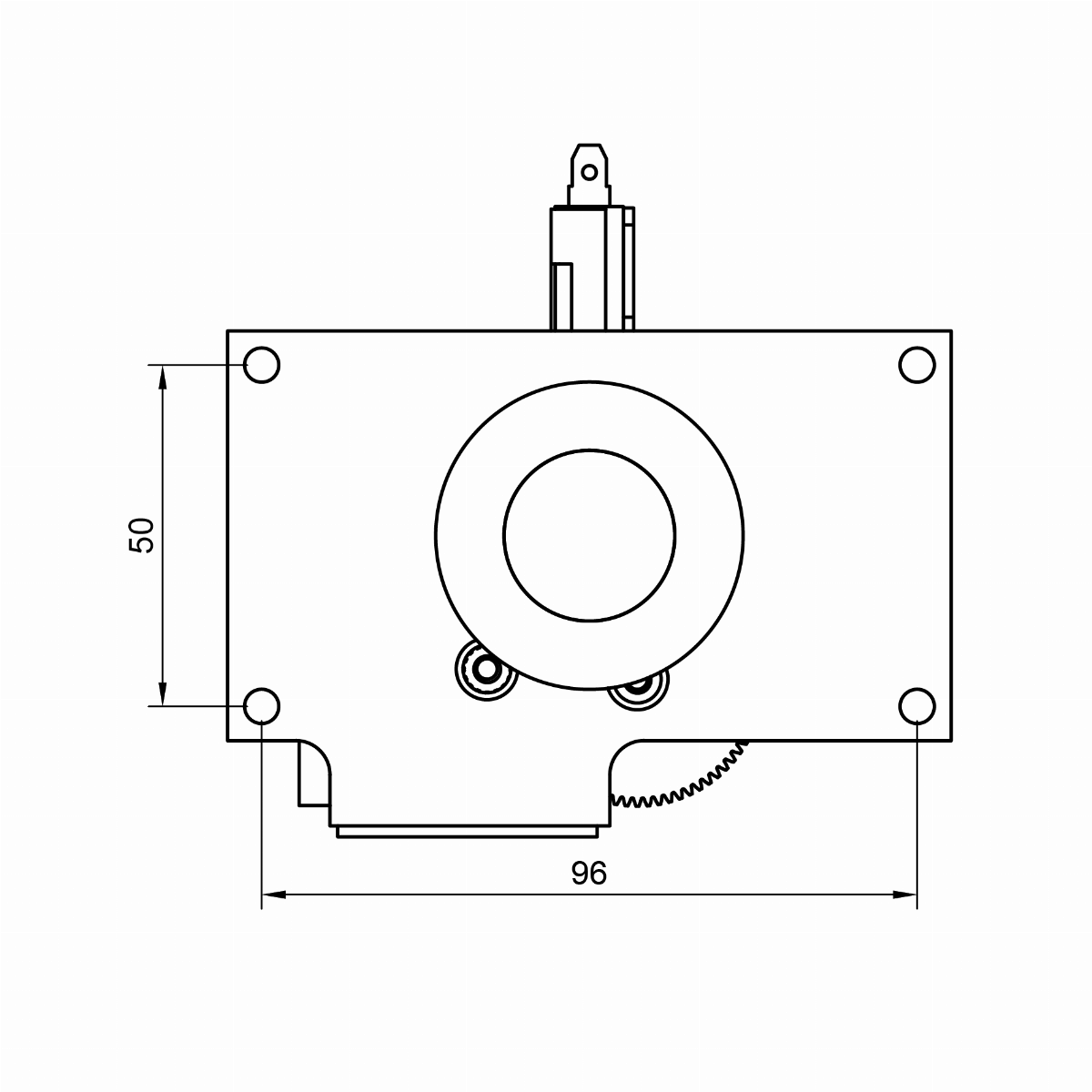

These are the technical for the spinners.
The depth is around 8CM and you can see the mounting points.

Small update on the Mister support side:
Decided to go with this design, so it adds joystick, buttons and spinner support
So this should make it easier to make your own controllers/panels, etc.. for use with mister, etc.
