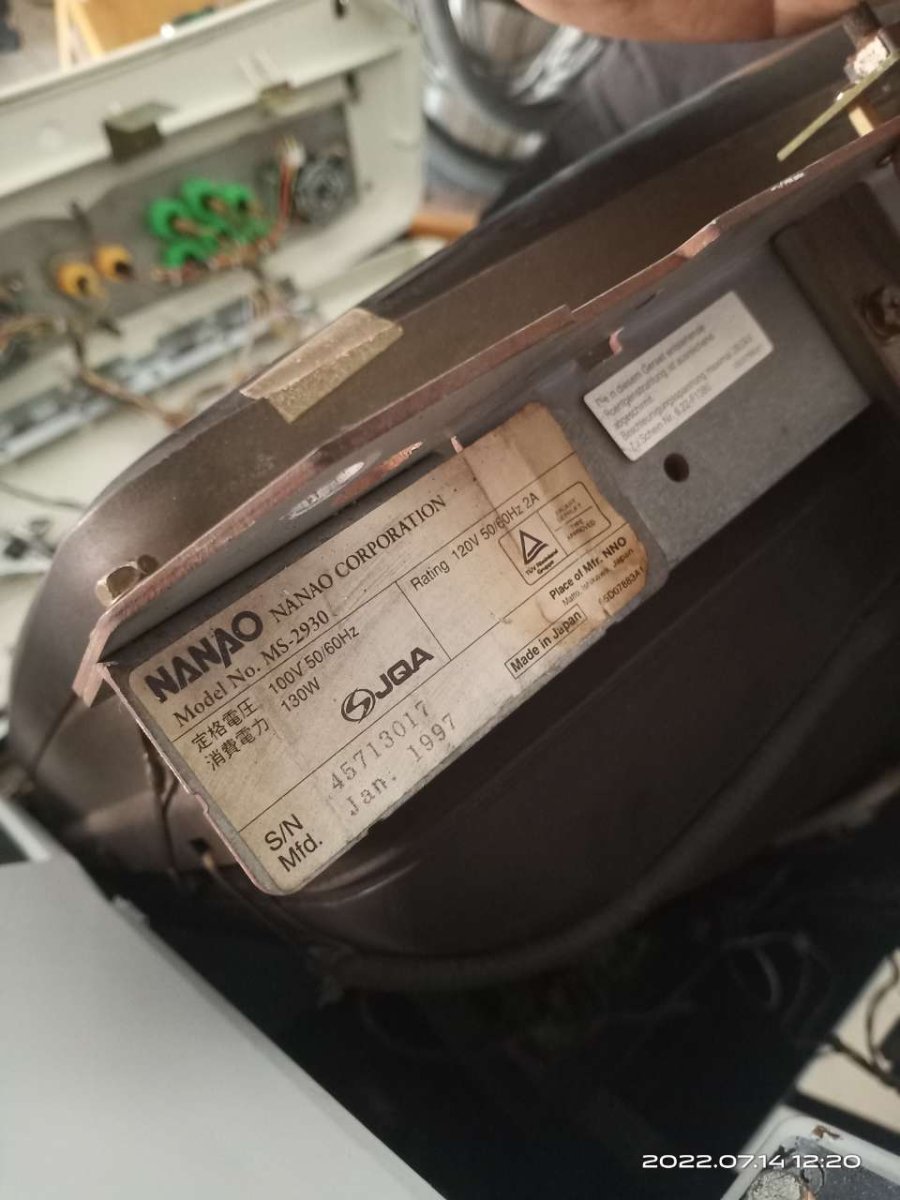

Attached are the images of the monitor/tube/chassis all that good stuff lol
That's the frame and the tube, no picture of the chassis. The sticker on the frame doesn't prevent anyone from having swapped out the chassis at any point in the past 20+ years.

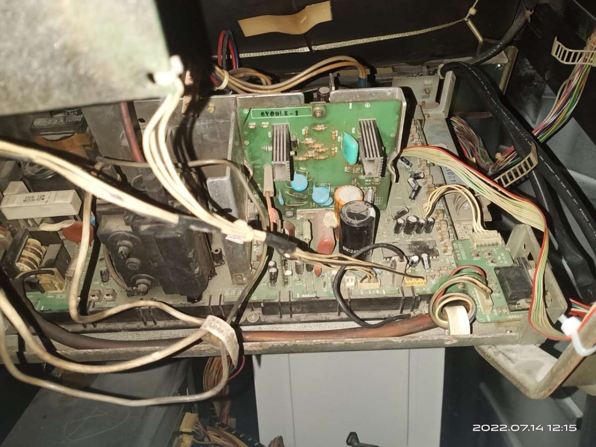

is this the chassis? Yes i know i know i'm such an expert :dead:

Something is loose or has a cold solder joint or something. Sync shouldn't drop out when you're putting the bezel on the cab, and you can see it go from white and fine to overly red middle of one of the other videos it looks like. Good news is it's something small, you may just take a bit to narrow down what exactly.
