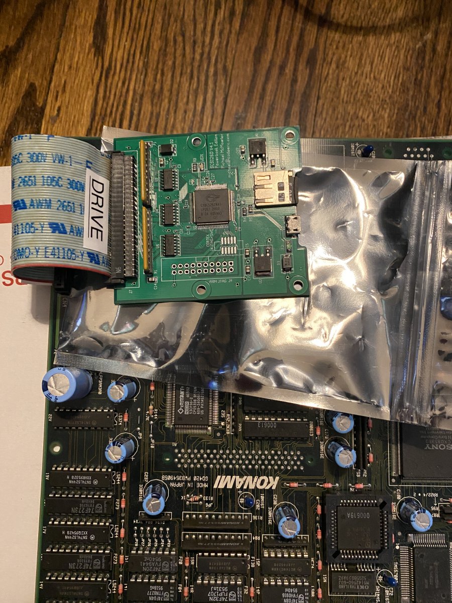

So I was able to find an in stock SCSI2SD 2.5” SD emulator for the hard drive.
I posted on r/VintageApple on Reddit to try to get more info on why some SCSI2SD devices don’t have pin 41/42 and some do. I guess most people who build them just solder in the full 50 pin headers and drill out pin 41 and 42 on the ribbon cable to blank those pins.
so that’s the plan. Drill out pin 41 and 42 on a new IDC 2MM pitched 50 pin cable and see it Crypt Killer will read the device as the SCSI hard drive.
I probed pin 41 and 42 on the pcb and I can’t find continuity between anything but in case I missed it I’ll still drill the pins out as a guarantee they aren’t connected
I found one photo of it done before. ShouTime has his setup with a SCSI2CF adapter. Photos are terrible and I can’t get any info off them but obv it’s doable.
So yeah...fingers crossed!
Micro SD card flashed with the CHD via CHDMAN and I pulled the plugs on the HDD side connector for pin 41/42 anticipating having to remove the pins
There were no pins, just recesses. Checked with a loupe and probed those two sockets out...no pins
SCSI2SD should be here today or tomorrow...then I will see if this idea has any merit!

dont run things with metalised mylar bags on them - they conduct.
i saw a guy blow a motherboard like that once!
really? that's news to me
edit: looked it up....slightly conductive. Well damn...and I've been doing it for years
That board has since been mounted to stand offs anyway
it's conductive to disipate static.
anti-static = conductive.
the pink foam is dangerous too.
