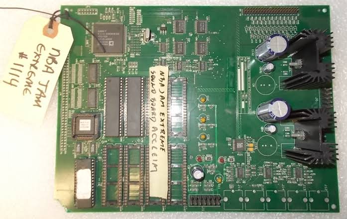

hi :
See attached, batman forever and nba jam extreme use same audio pcb, just different proms.
Not home so i cant take an image of tge batman forever pcb.
Should be j1 connector for sound, the other connection is to the cart/buffer board. j1 is the smaller header pin connector.

hi :
