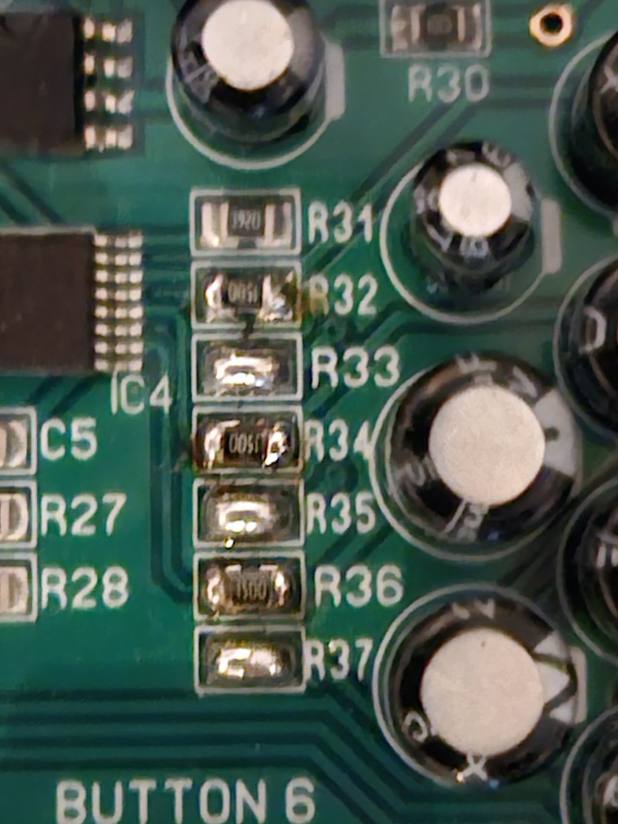

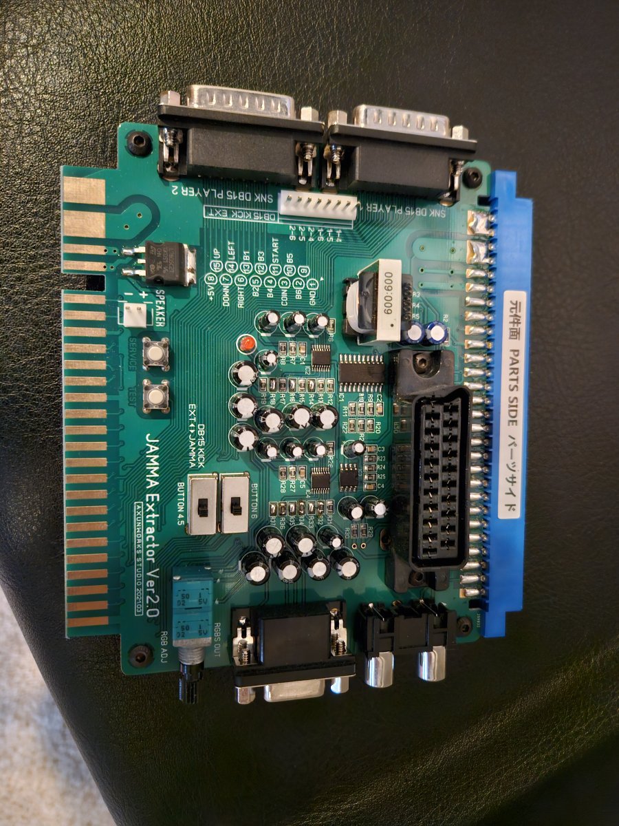

Hello @drfunk2k , I was hoping you could help me out. I recently bought a Jamma Extractor 2.0 secondhand, and although it seemed like everything was fine at first, it looks like I'm actually experiencing the issue with the darker picture, and any output picture (scart/vga) is way brighter. The thing is, it already has the updated resistors in place that were recommended to "fix" this issue.
Board:
Resistors:
For the picture to look even close to normal, I need to have the single pot all the way at max, and even then it isn't as bright as it is without the Extractor plugged in. However, doing this, the second outputted image is extremely blown out, too bright.
Any recommendations on what I might be able to do?

@drfunk2k in the vid it's an Axunworks Supergun Mini
Same behavior happens on my Blast City cab too
If I plug in the jamma extractor at all, the image on the screen gets muddied like the video (even without outputting any extra video)
Yes, i understand. the video from the supergun gets "muddy" but the video from the SCART looks good. that is what i reported.
Axun said that 2.0 has been updated a few more times, current version is Jamma extractor 2.6
Are you capable of replacing resistors?
R6, R7, R8, could be replaced with 330R resistors
Yes, I should be able to do it or have a friend do it if needed. I'll try replacing the resistors, thank you!
