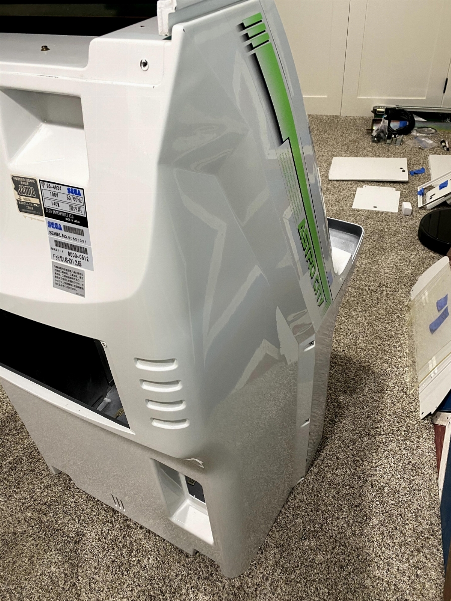

Rub a dub dub. Its amazing how lightweight this thing is once you completely gut it.

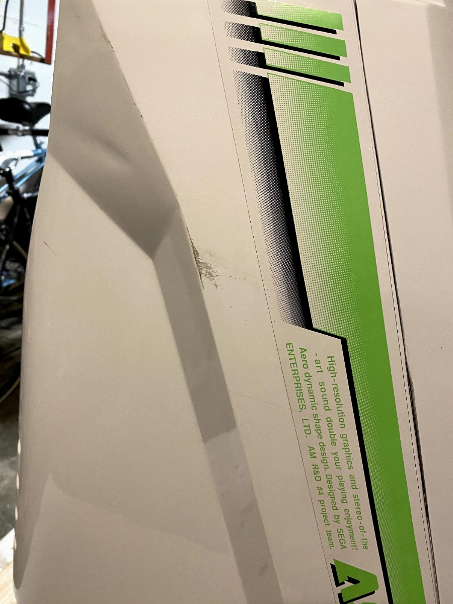

All cleaned up! Unfortunately, hitting the the arcade with the hose blasted a few of the stickers off that were pretty loose already. I know that would bother some people. I wish they would have stayed on, but maybe someday I'll buy a set of repros if I care enough.
Woot woot! I can finally fit this thing into the basement now that it's clean.

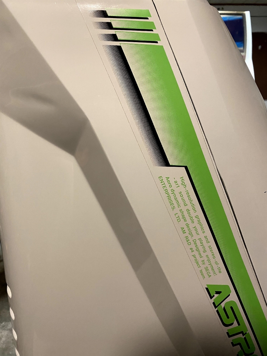

The Goo Gone is really nice. It's rated safe for car paint so I felt it was safe to use on this sticker. I sprayed it on and let it sit for 15 minutes before using a small piece of plastic to scrape off the adhesive sticker. Wiping with a sponge afterwards cleaned all the remaining residue.
I'm quite happy with the way these turned out. There are some specks of an unknown substance that just wouldn't come off the very bottom. I have no idea what it is but you can see it in this picture on the PCB cover bottom. Looking very closely you can see it is really on there. It isn't enough of a bother for me to do anything drastic like repainting these though. I sort of like the idea of the machine having some history of its use. My ratchet set finally arrived today so I can remove the wheels and clean them. I'll be replacing those and hopefully starting re-assembly of the arcade in the next post. I want to polish the shell with the Fiberglass polish, but that will have to wait until I'm finished touching up the paint. This was a long post, but thanks for reading y'all! I hope some of the information I post helps others like previous posts have helped me.

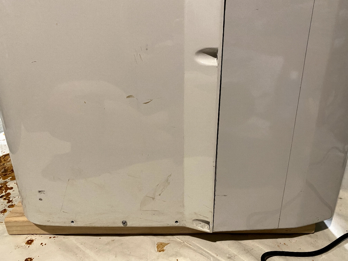

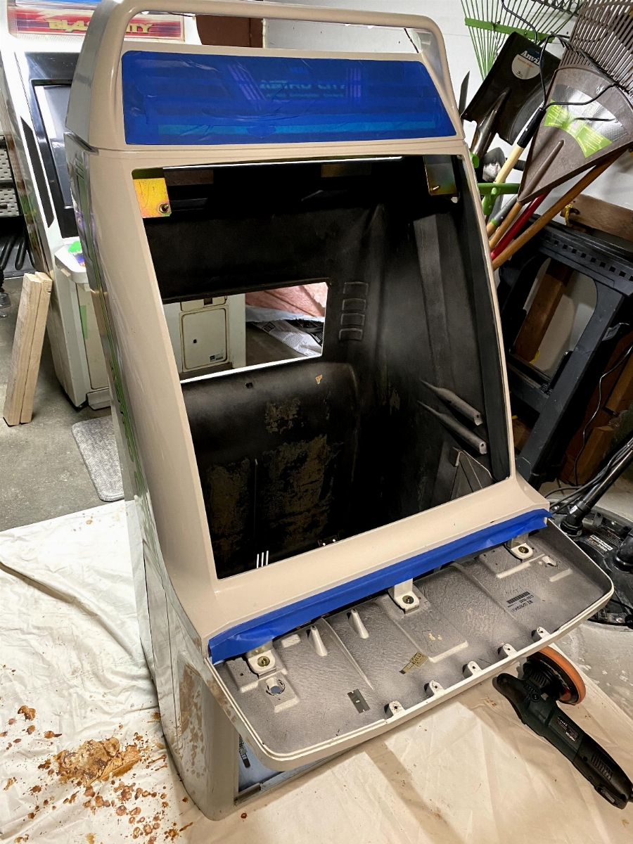

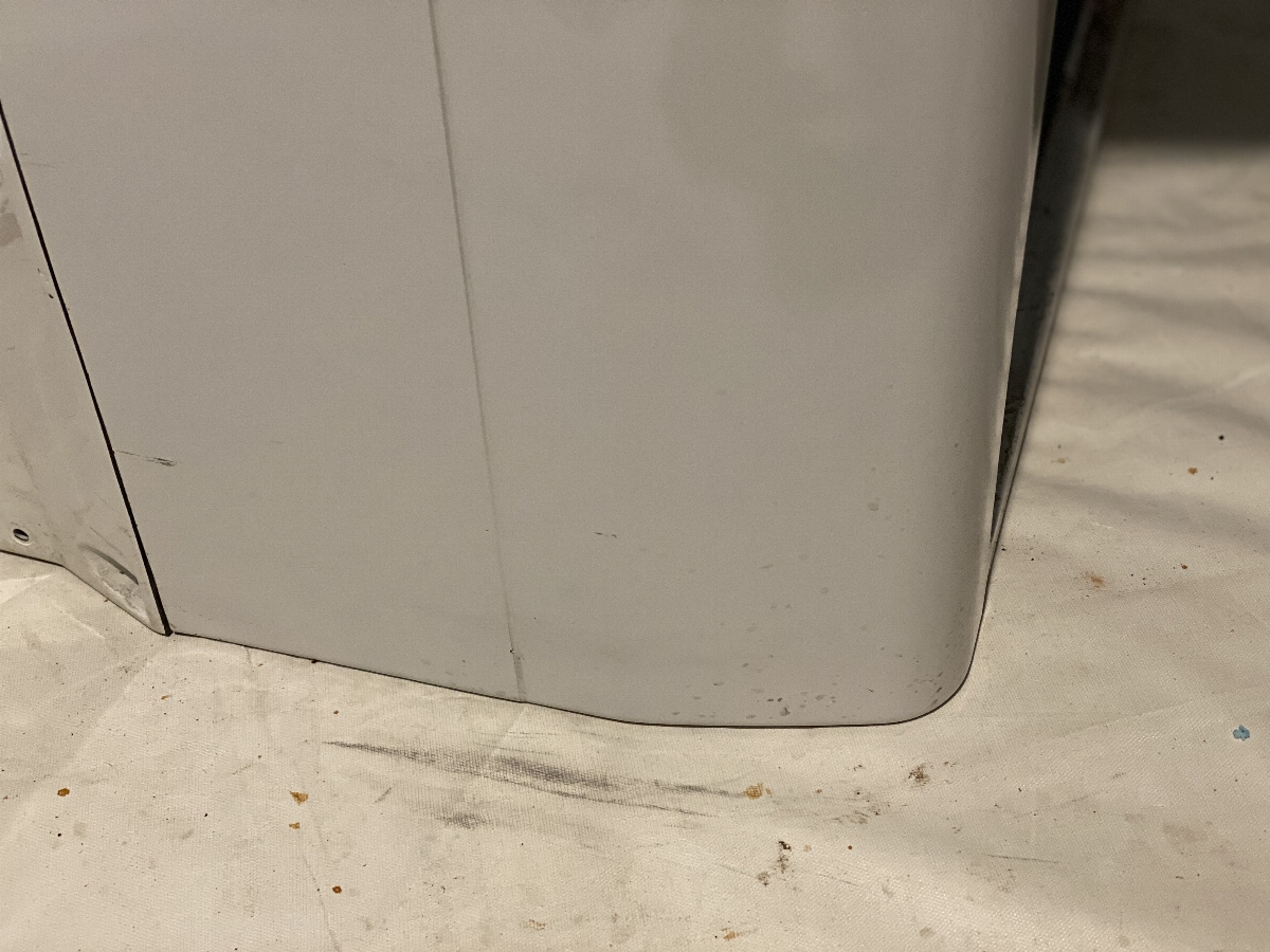

Over the weekend I had some time in the mornings to keep progressing through the todo list. I was most interested in polishing the body with the Meguiar's Fiberglass Polish/Oxidation Remover which gave better results then I had even hoped for.
The first step was to re-assemble the shell of the arcade in the shop since I know how that buffer flings materials everywhere. I also taped off the marquee panel that I couldn't remove to prevent it from getting the fiberglass polish on it.

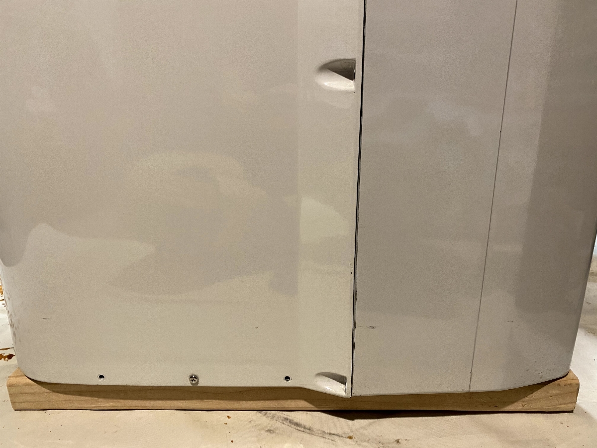

So far so good, the polish was able to remove much of the discoloring and even some marks I thought were chips in the paint.

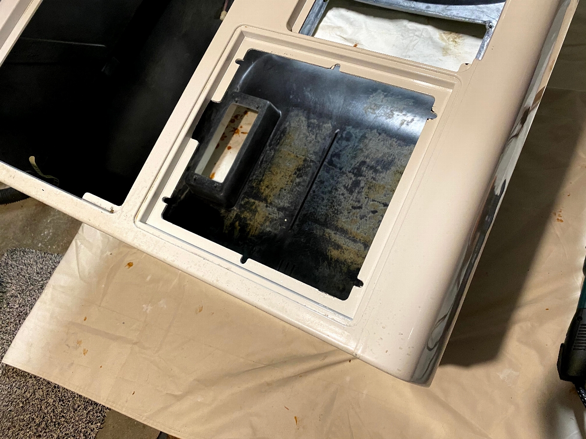

I worked my way around the base and then did the same for the top. Previously, I was considering touching up the paint before buffing with the polish but this shows polishing first is the way to go since you never know what might be cleaned up before touch up time.
I was really happy some of the more visible scuffs from moving in and out of doorways came out. The shell was really shaping up quite well.

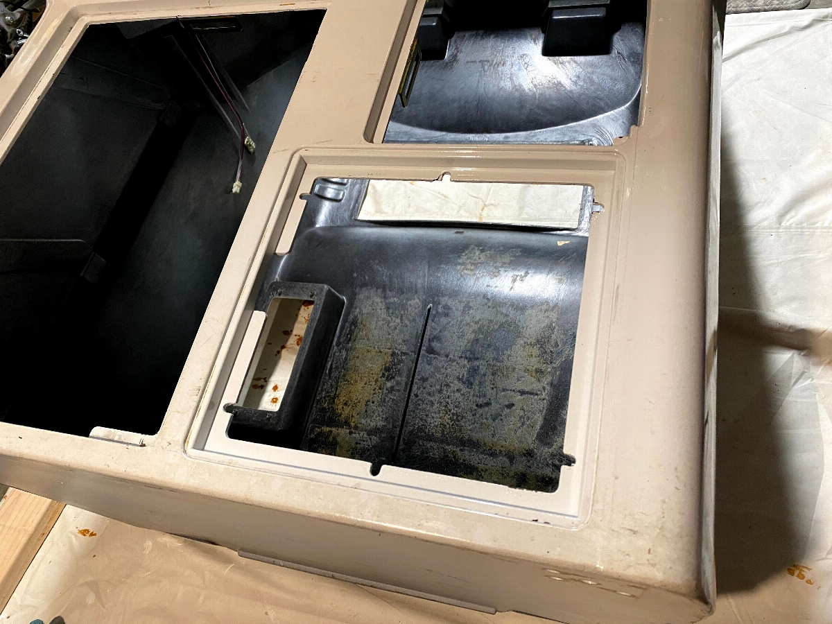

After finishing the polishing, I once again disassembled the shell, brought it back in the house and reassembled it. There were still some scratches and marks, but hopefully the touch up paints would take care of that.

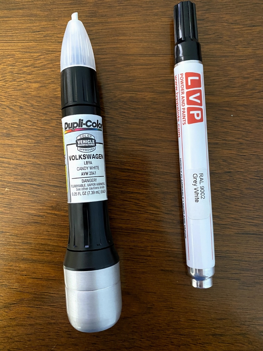

Speaking of touch up paint, I ordered one of each of the recommended colors most people recommend: RAL 9002 & Candy White LB9A. Time to test them out to see which is more accurate.
The darker one on the left is the RAL 9002 and the lighter one on the right is the Candy White LB9A. So, looking at this, the RAL9002 is too dark grey and the Candy White is too light. I tried to mix them to see what that would look like and being that they were both pens it wasn't very easy to actually do. Definitely not doable for the entire cab, but the color came out much closer to the stock paint. Although, some of the issue with the paint not matching may have to do with the cabinet paint being so old that it has lost some of the brightness. Maybe if it was newer it would match the Candy White better. After deliberating whether I should choose one color or the other, I decided to see if I could find another color online that might match better then these two. That's when RAL 9003 comes in. RAL 9003 is slightly lighter and less grey then RAL 9002, but looks duller then the Candy White. I went ahead and ordered a touch up pen which hopefully will arrive sometime next week.

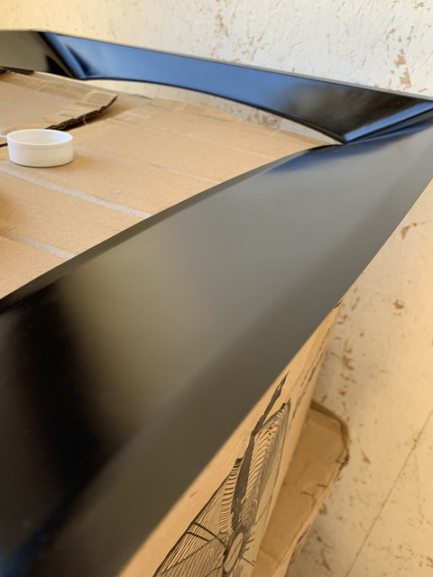

Last thing I did before calling it good for the weekend was to polish up the marquee plastic art panel that I found inside the cabinet. This had so many scratches many of which were deep. The Novus scratch remover did a decent job but even after some aggressive buffing there were many scratches still visible. Considering this was a bonus I didn't expect to even get with the cabinet and I see another on eBay for $80 right now I consider the scratches not much of an issue. I have so many little items coming in this week I think it will be an interesting time to pump out some more progress. I've been avoiding cleaning the monitor so I'll probably have to get around to that and eventually look at that light as well. Anywho, thanks for reading, y'all!
