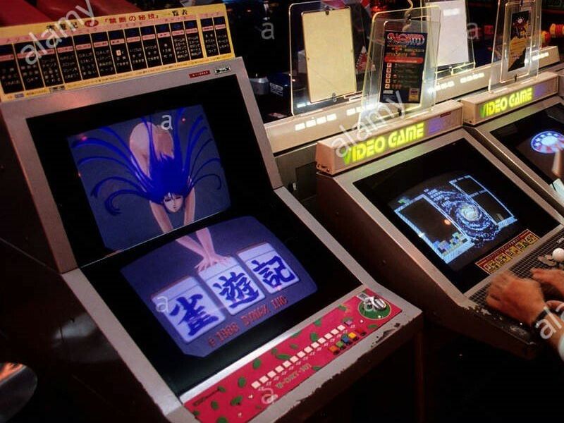

Sukebe on ArcadeOtaku found this pic of a twin screen Dynax cab running Jong Yu Ki:
(don't mind the watermarks)
There's also Jong Tou Ki released two years later that's a similar twin screen mahjong game.

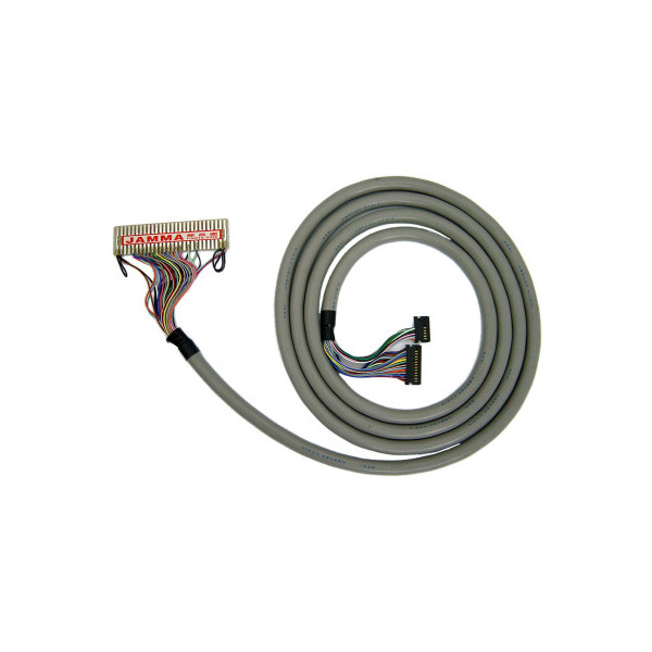

I'm a long time mame fan of Taisen Hot Gimmick 3 , and was interested in in building the actual arcade. Since the game has two players from (A), how would I get this working from the Psikyo PCB. Would i need two Psikyo PCBs and connect them with that special link cable in order to play on 2 screens/players?
Welcome to the forum!
Only 1 PCB is needed. You'll notice some black headers near the front of the PCB, Psikyo made a special harness for this that plugs in here gets routed to the 2nd cab and then has another Mahjong edge for player 2. The one PCB is able to provide separate video and audio for both screens.
it looks like this:
^that's actually the cable for Lode Runner The Dig Fight, the Mahjong one is nearly identical but has a different edge connector.
