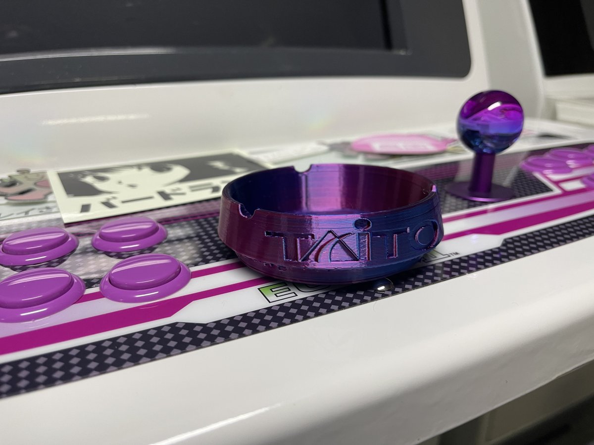

@Ziggy Cheetos Dust I ended up modeling my own ashtray as it’s a pretty simple model and I wanted all the source curves if I wanted to tweak it down the line.
For the overhang I printed with tree supports and then sanded that area nice and smooth. Then vapor smoothed the whole thing. Zero layer lines and the overall surface is glass smooth.

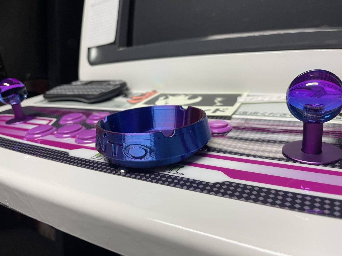

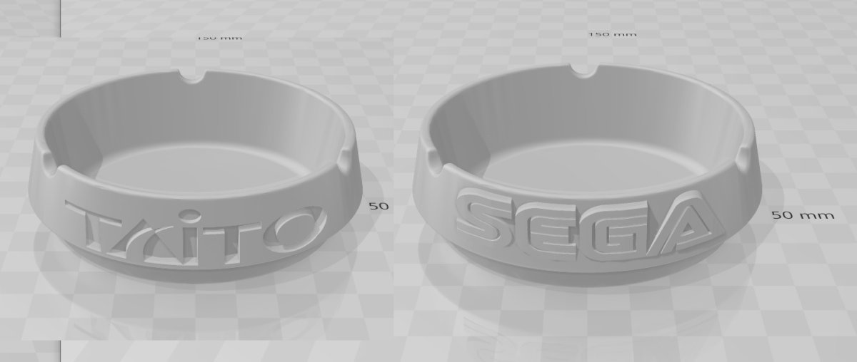

Here's the Taito one. Print with support. 20% infill.

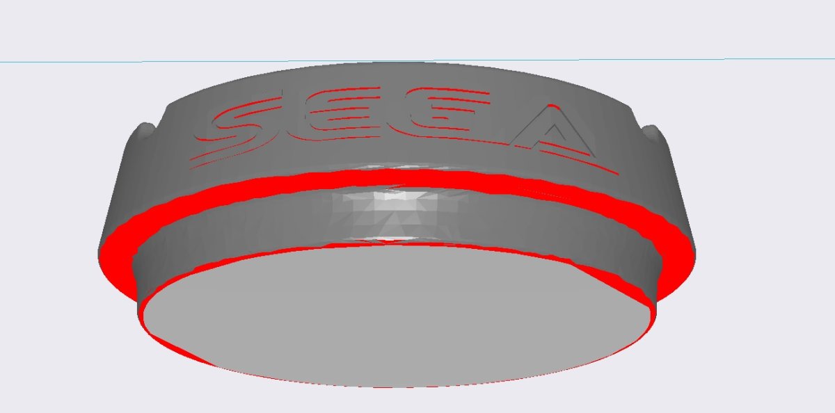

Let me do more tests for SEGA cause I am still not happy with it.

If I may make a suggestion, print with 100% infill if you’re going to spend the time. Trust.
The ashtray feels so much better as solid plastic rather than a hollow shell. The weight and feel makes it much more like a real arcade ashtray. Set the print off before bed and it’ll be done by morning.

Well after trying a couple of times to print it as "holes", I must say that printing SEGA as solid is the way to go.
it's not perfect but hey, give it a try and let me know what you think?! (support required)
