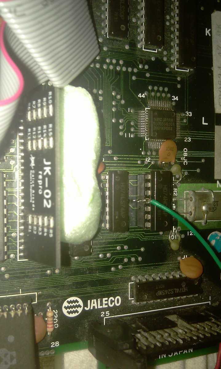

To perform the mod:
Lift pin 4 HC04, add wire to one side of switch
Pin 8 to other side of switch
Middle of switch = vacant HC04 pad
This switches between 6 & 12mhz , a big jump and as stated many times before, not recommended for P8.

Good news the overclock works fine
Bad news my P8 @12 gets hot very quickly and crashes and won't boot up again until cool.
As expected it will need to be changed to something faster.
Other good news, CPU seemed to take the abuse and returned back to working after cooling down.
Do you think putting a big heatsink on it would be sufficient to mitigate the heat? Or is a part swap really the best solution here?
I'm not entirely surprised it crashes, that is a 50% overclock. From what I was told about fabbing these things, they're all made as P12's (or whatever the highest clock speed is) and tested, if they fail they're tested as P10's, and so on until they're stable and then that's what they're sold as. So in all likelihood, your P8 is a failed P12, etc.

Part swap, or get lucky with a motherboard with P10 fitted from factory ;)
OR we build a 10mhz circuit....
It's no surprise at all, TBH i was told the same about chip plants and that it works the same on ram, rom and other parts
how they are "graded" by testing, still to this day i think ;)
More of a surprise it booted with the clock mod and the other sections of the PCB don't rely on it being in sync.
I think Ill just do the swap and place sockets while im at it. Both cpus need to be replaced correct? So any 64pin 12mhz (or is 10mhz preferred) 68000 should do it?
