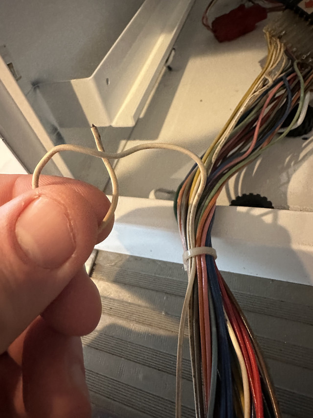

I disconnected the Jamma and followed to its point of connector.
I did notice one of the ground wires was disconnected wire tied to the loom intentionally.
I ran continuity to from the Jamma edge to the connector and they both beeped fine.
I still cant get a stable image. It wants to roll to the right. Even when I subtlety roll the image to the left it slowly goes right. The vertical Doesn't hold either.
