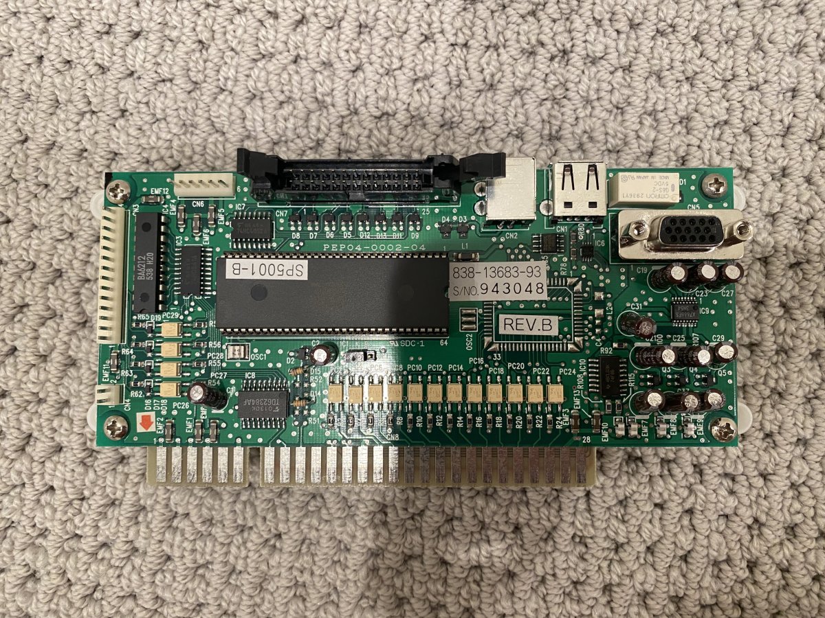

Can you share a picture of the IO ? I have version 838-13683-92 A and it works fine with the Type X2 Multi.
Do you have a RS485 adapter @tacobell ?
Unfortunately, I don’t know what an RS485 adapter is.
Thank you for the picture @tacobell, after testing a bit I believe the issue is not in the DLL but in the ttxshell. Just need to think of a clever fix.
No worries. Just let me know what you need me to do on my end. Appreciate the help!
Try replacing the ttxshell.exe with this new one, and let me know if it works.
Tried this new ttxshell.exe with the both the old and new dll but didn’t run.

I know this sounds crazy, especially since the capcom I/O works. But have you tried a different USB cable?
Another thought, can you verify voltage being supplied to the I/O?
During development the Sega Rev B was the I/O I used. So I know it's compatible.
Improper voltage though, could explain why one I/O works when the other doesn't.
Is there a specific usb cable I should try? I have a bunch but not sure what I should be looking for.
As for verifying voltage, where should I measure? Jamma edge?
Any old USB-B to USB-A cable ( like a printer cable ) should do the job.
You'll want to measure 5v at the JAMMA edge.
