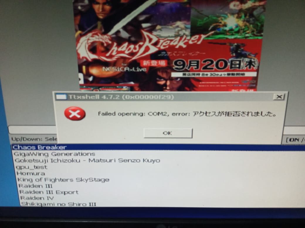

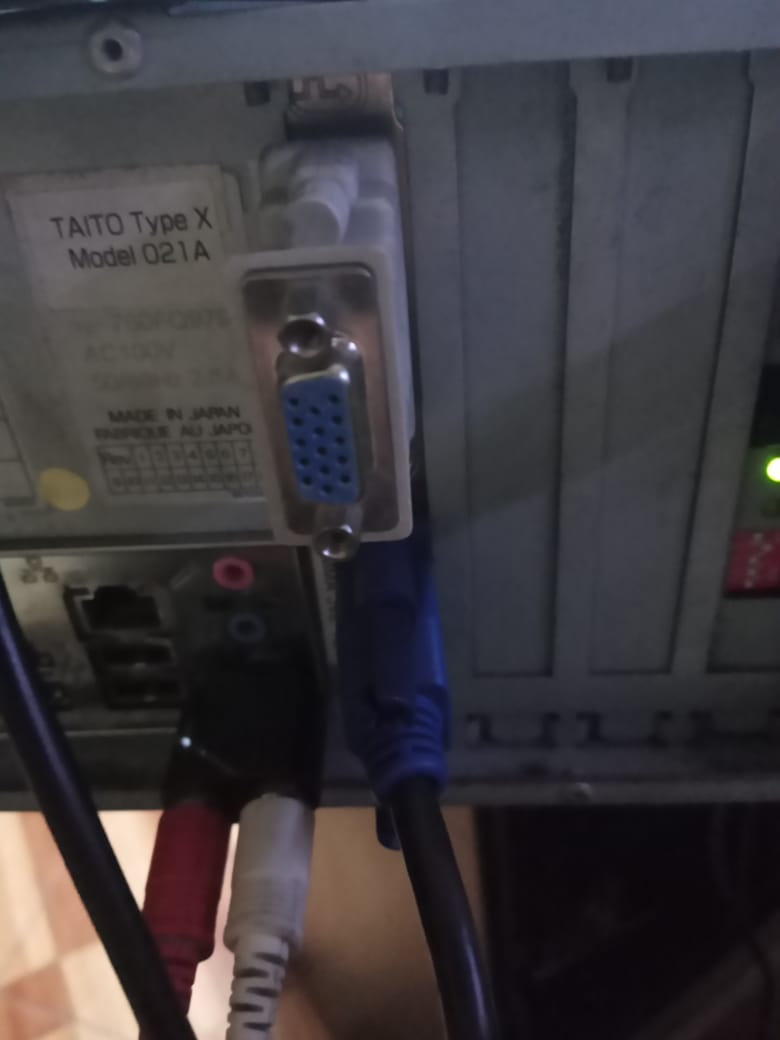

Hello everyone, how are you? I have tried to do the tutorial that you mentioned about taito type x1 and I have some problems.
When starting the system this error appears:

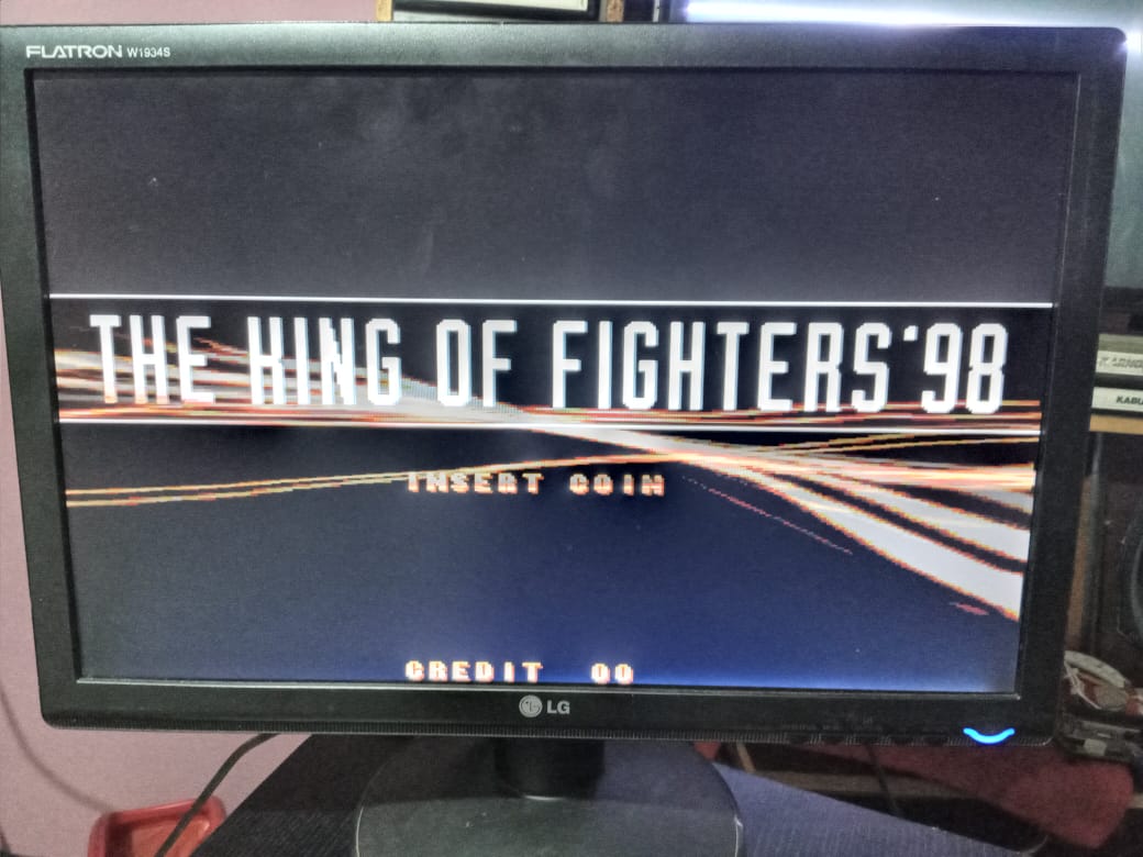

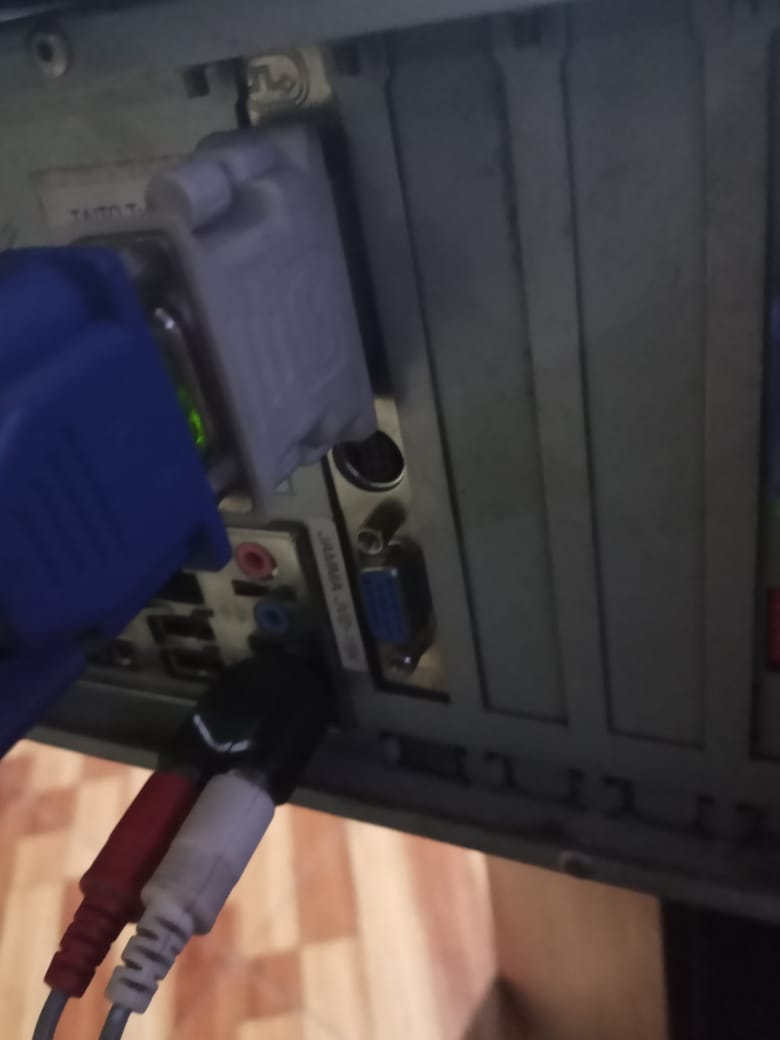

After hitting enter with a PS2 keyboard the image jumps and I have to change the card connection from the DVI port to the VGA port for the image to appear
In this step it lets me select a game but the com2 error does not disappear until the game starts without problems

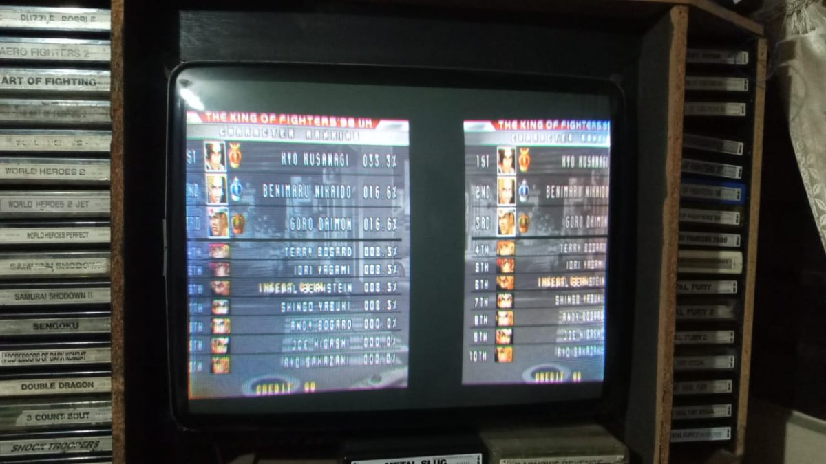

but this only works for me on a computer monitor but if I connect the VGA cable to the Arcade the screen does not look good, the image appears double.
my configuration
Taito type x Original
Memory 256
Procesador Original
DD SSD 256 System Taito Typex multi 4.72 explained in this forum
I don't know if you can help me @rtw thank you

Did you set your CRT to VGA mode? Some monitors can not auto switch between resolutions, so check to see if your CRT has a dip switch. Also, the bottom VGA port will work on a standard resolution display. I've tested a Taito Type X on my Astrocity. Make sure you only plug the vga cable into the VGA port only, to make it boot up in standard resolution. At least that's what I noticed from my experience.
