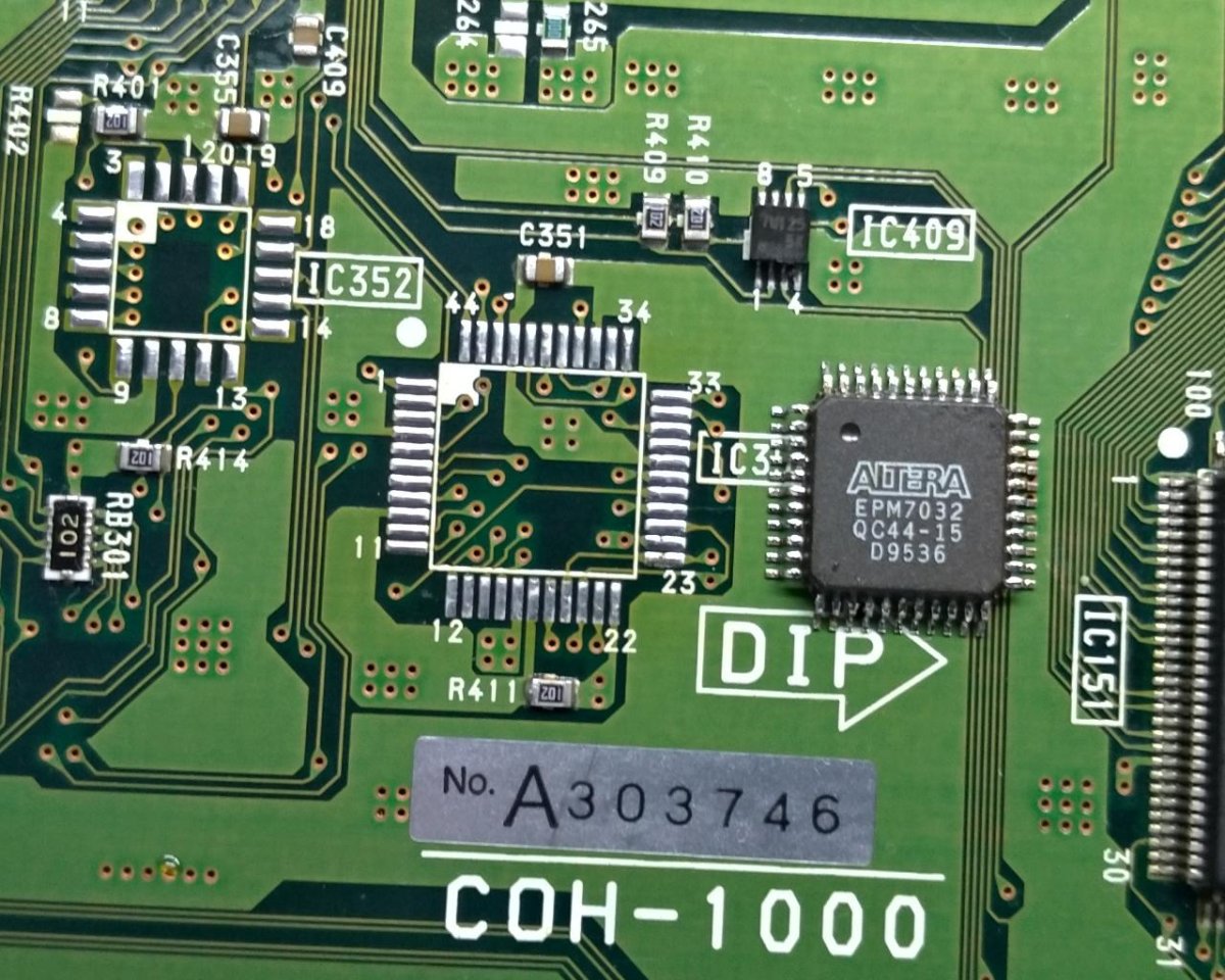

Goodnight,
I have 2 ZN-1 street Fighter Ex plus boards, one working normally on the motherboard and the other with a black screen, I was passing some chips from the faulty board on the good board to try to find out the defect, I passed several chips and everything working, until when I passed the Altera EPM7032 IC354 chip and it gave my board a black screen that was working, I thought I had discovered the cause of the defect in the board that did not work, but when I returned the good chip that I took from the board that was working, it also had a black screen , from what I saw in the datasheet this chip is programmable, someone would have the programming file of it to provide me, because without it I will have 2 boards with the same defect, thank you in advance for your attention, sorry for the English, my native language is Portuguese . thanks.
