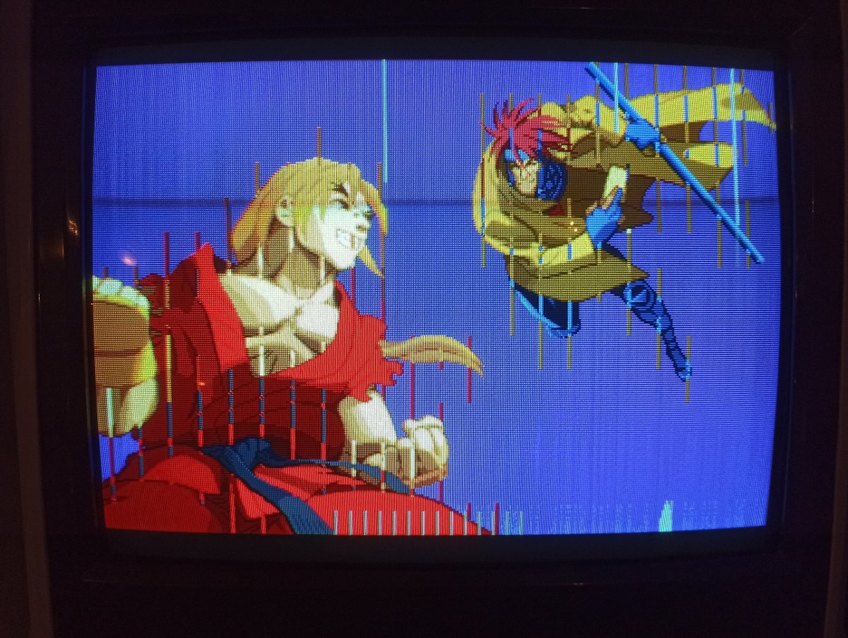

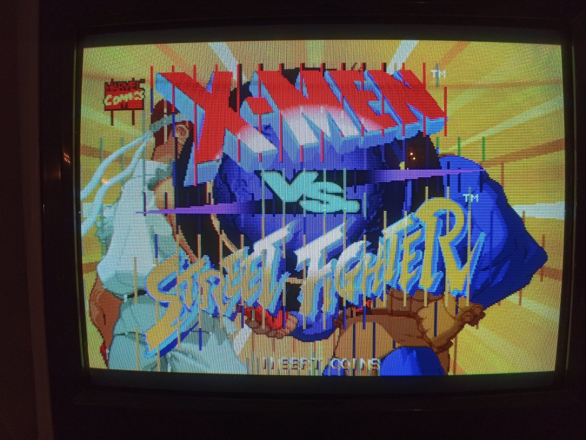

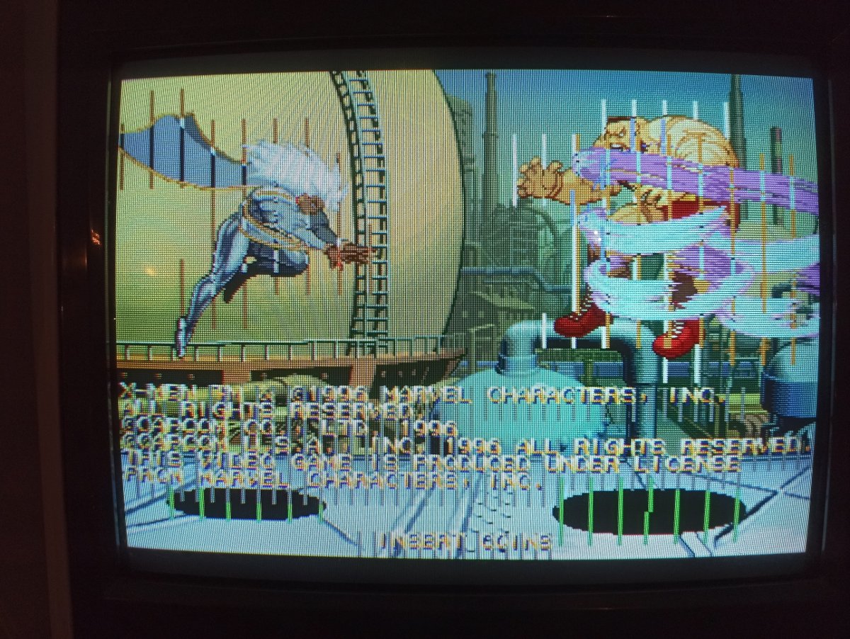

Hello everyone,
Someone gave me a X-Men vs Street Fighter (USA) but the game have some graphic issues.
You can see them on the pictures.
The game was phoenixed I put it back in regular protected version with an infinikey just in case the phoenix wasn't done correctly. But no chance the problems are still here.
I tried to exchange some of the pal with some other one but nothing changed.
If someone have any idea all the help would be greatly appreciated.

This usually happens to my CPS2 boards when they aren't fully sandwiched together. On my Alpha 2, I even had to take the shell off or it doesn't all the way connect to the A board.
While the game is on, if I push down on the corners of it, those lines can go away lol.
Your prob could be totally unrelated! But that's something I've seen at least
I wonder if it's one of the graphics roms going iffy on you as well. I have a similar effect on my UMK3
Definitely happens to me on my xvsf aswell, just reiterating what Ghaleon said, try pushing on each of the fours corners where the connection happens.
Also don't forget to apply some pressure directly in the middle aswell, this is what usually fixes it for me.
could be B board or A board issue. It’s easier to narrow down which one if you have other A and B boards to test.

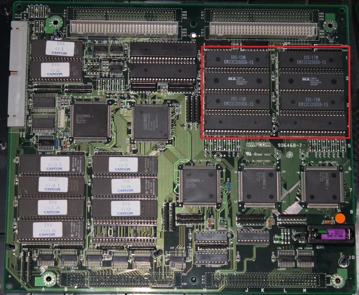

I had exactly the same issue with my X-men vs Street Fighter B-board! :)
I dumped all roms first ensuring they matched the MAME set, and carried on trying all kind of things.
BUT it actually ended up being one of the GFX maskroms. Even thou it matched the romset everytime I dumped the maskrom, it would not work correctly. I cleaned the pins, cleaned the socket, nothing helped.
Try removing them one and one, starting the game everytime, and see which one removes the bars (its will remove more than the bars, but I could still see the bars in the messed up gfx every time untill I removed the faulty one).

Looks like backgrounds are drawing OK, but sprites are glitchy.
