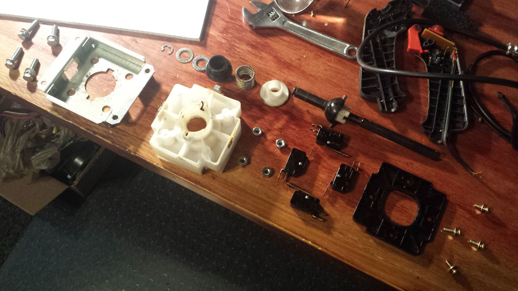

In all my searches I managed to snag 1 stick off of a random eBay listing. I tore it down and took photos so I figured I'd post it up here. Consider the project "idea" figuring out a reproduction or identifying who the original manufacturer is (hint: it's NOT Sanwa or Happ, I'll get to that later).
I was able to tear it apart completely except for the joint parts on the shaft, it looks like they're all just press fit but I didn't want to put too much pressure on them and risk breaking them.

These were the sticks used in the Twin and the Candy Cabs for VOOT 5.2 through 5.66. The VO Force arcade cab sticks are supposedly the same except for the thumb button, which used a board mounted mechanical switch as opposed to a diaphragm style switch.
Dreamcast home twin sticks use the same grips but are otherwise completely different.
