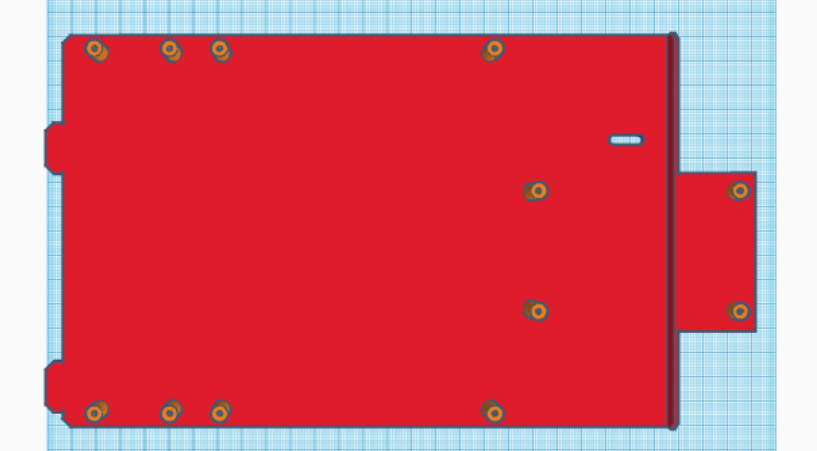

When I got my Vewlix it came with no I/O mounting plate (I'll give you one guess who it came from ;)) and I've always wanted to get a replacement. I actually found one on Ali Express and bit the bullet but I still wanted to model something so it would be easier to swap around I/O boards if necessary.

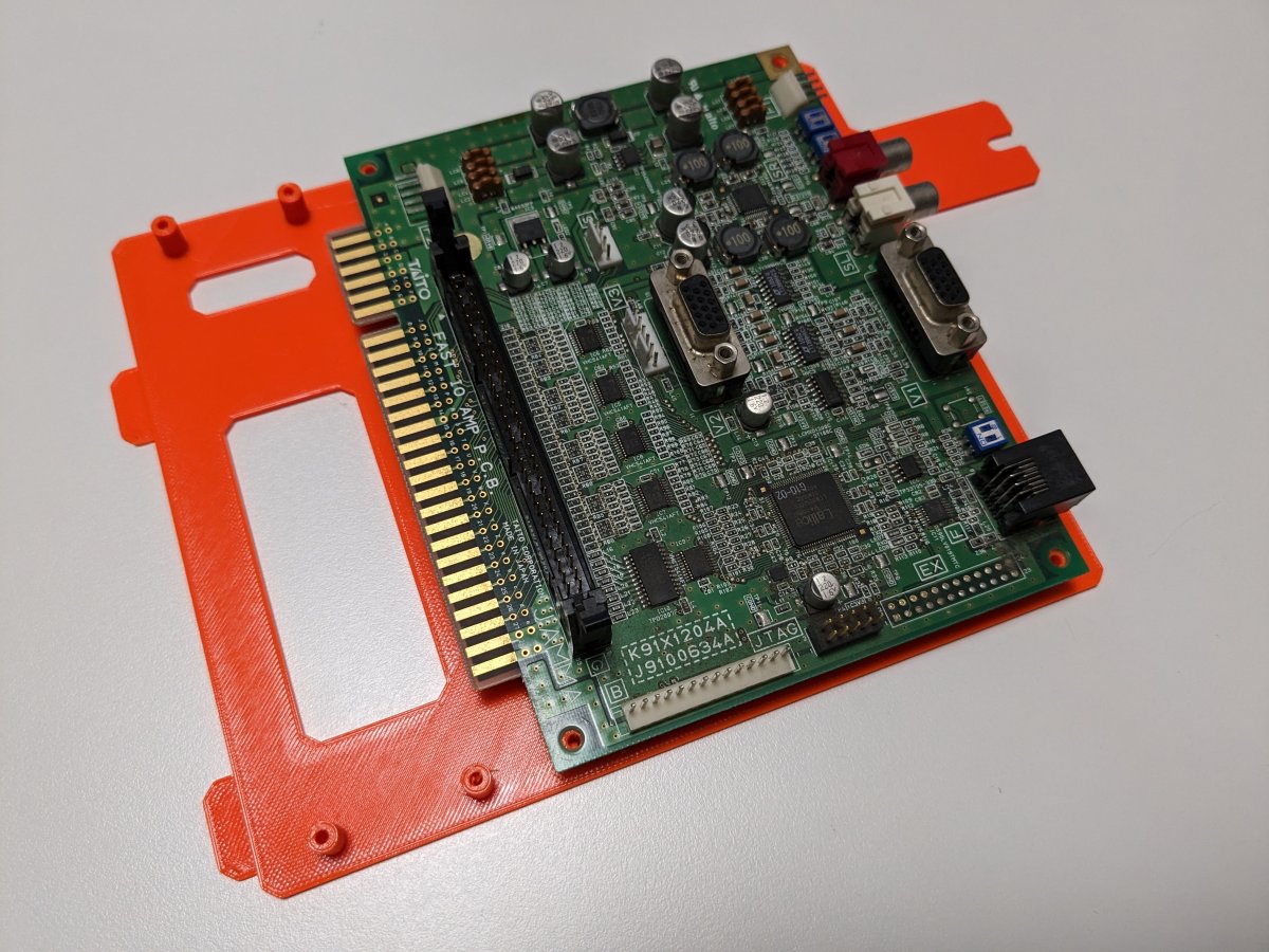

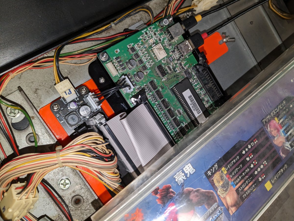

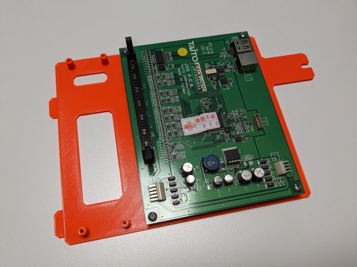

I have two models here. One is a full recreation of the original plate. The other is a little more reasonable to 3d print. It just barely fits my printer at 250mm wide. (In the pics you'll see I had tried to make the model smaller but didn't realize the hold down stud actually tightens down at the far right of the slot. I've fixed the model to include the full slot.) I made up mounting posts out of a 6mm cylinder and a 2.5mm hole. I originally intended on using 3mm self tappers, but I ended up drilling the holes clean with a 2.5mm bit and fine thread 3mm screws work just fine.

Nice to be able to fit brook ufb and/or the fast io/sega jvs io on it.

I printed the fixed reduced one and it came out good. I think the posts for the narrow board need to be closer together horizontally about half a mm. PET flexes enough to work but I'd like to eventually fix the model.
